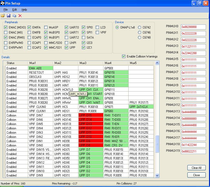

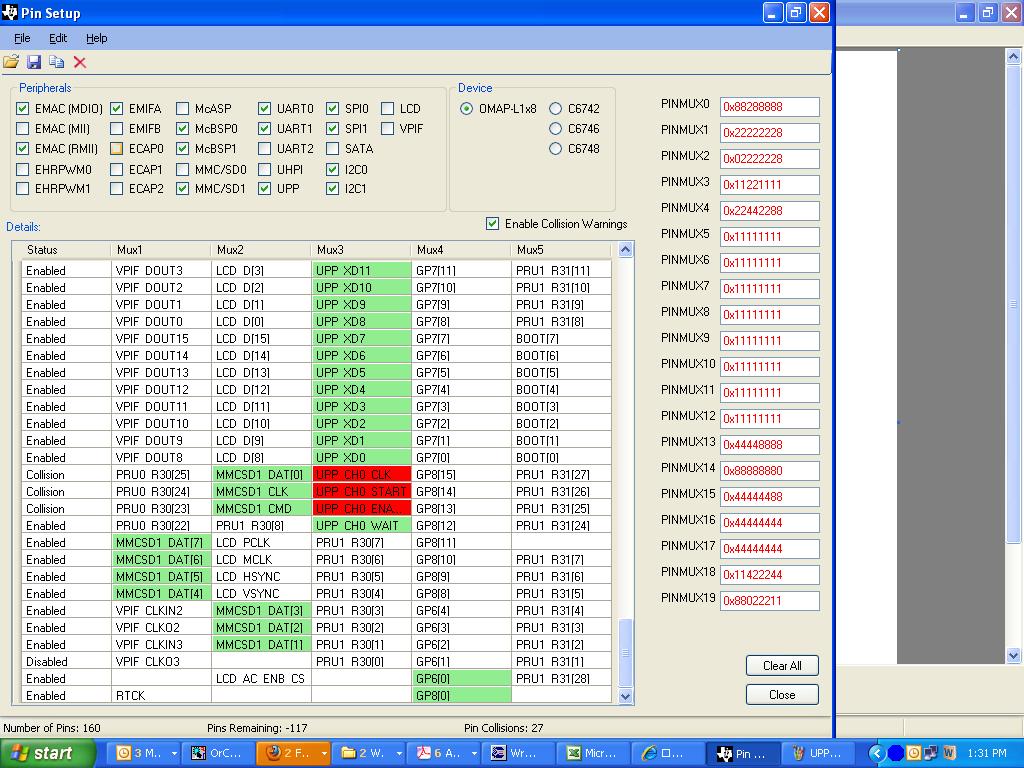

We are designing one CPU module based on L138 processor. Our requirement is to utilize either the UPP interface or the MMC/SD1 interface based on the application demand. There are pin collisions between those interfaces. Attached the pin MUX utility screenshots, conflicts are in red color. In order to design a flexible hardware which can be configured either for UPP interface or for MMC/SD1 interface we plan to use a programmable logic in our design.
The plan is to use 8 bit UPP when MMC/SD1 interface is not used. 8 bit UPP data bus and the control signals (UPP_CLK, START etc.) are terminated on a programmable logic.The MMC/SD1 signals are directly routed to a MMC/SD card connector. The UPP bus is decoded by programmable logic if MMC/SD1 interface is not used. The programmable logic ignores the UPP signals when MMC/SD1 interface is used. UPP is used always in 8 bit mode since the upper bits shares pins with RMII signals and RMII is always in demand.
