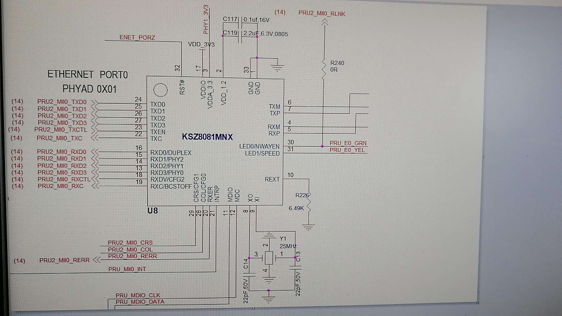

on our custom board, we want to use prueth ports as general 100Mbps ethernet interfaces. We have modified the device-tree,pinmux and the pru_rproc.c driver . Now it can generate the eth2 and eth3 and the firmware (am57xx-pru0-prueth-fw.elf,am57xx-pru1-prueth-fw.elf) can also be loaded successfully. However we can not ping another ip address using eth2 or eth3, and the pc host can not ping eth2 or eth3 ip address,at the same time we get the pru2_mii0_rxctl signal changed only, the pru2_mii0_txctl always stay on "0".   when we use 'ifup eth2', the output is stop at 'send discover..' as follows, it seems the emac_ndo_open function is not called.
What wrong with it ? Could some one give me some advices, please?

  • Hi,Schuyler,
           Thank you for your help. We have four ports, but the topology of network is point to point when we test,  that is, only the eth2 port connect to  pc host. moreover, we put the other eth down, the eth2 not work as before and get messg like below:
        at the same time, the wireshark  on the pc host does not get the message " fe80::62a4:4cff:fed5:87ee    ff02::fb    MDNS    111    Standard query 0x0000 SRV am57xx-evm._sftp-ssh._tcp.local, "QM" question"
         On our custom board the prueth phy chip is ksz8081 different that Am572XIDK board use tlk105. Where maybe  the problem?

    There could be phy issue.
    Lets just work on eth2 alone, no other ports connected with network cables. So please unplug all the network cables from all the ports.

  • hi, Schuyler
        Thank you for the reply! we do the step as your mention. At the fourth step we get nothing from eth2 by wireshark. we ever suspected the hardware of phy. but the intial message show that the phy is ok(msg:"davinci_mdio 4b2b2400.mdio: phy[1]: device 4b2b2400.mdio:01, driver Micrel KSZ8081 or KSZ8091, davinci_mdio 4b2b2400.mdio: phy[3]: device 4b2b2400.mdio:03, driver Micrel KSZ8081 or KSZ8091"). when we plug in cable, the connect can be recognized. what's more when we ping form pc host, the pru2_mii0_rxctl signal become active, just pru2_mii0_txctl always stay on "0", the  pru2_mii0_txctl never change too, even if we ping form custom board. so it seems  the kenerl or driver do not transmit and do not response the rx signal, the phy is working well?  what should we do next? could you give us some advise? thank you !
    the mesg is :
     Starting Permit User Sessions...[    8.489057] libphy: 4b2b2400.mdio: probed
    [    8.690838] davinci_mdio 4b2b2400.mdio: phy[1]: device 4b2b2400.mdio:01, driver Micrel KSZ8081 or KSZ8091

    If I understand correctly what you are describing, eth2 will show a link status detected occasionally? But in both cases of link detected and not detected no traffic is being passed? Earlier in the post you mentioned that wireshark is not showing any traffic, is that true with the link status shows detected?
    This issue could be that the PHY is not getting a good reset. Could you attach the section that shows the PHY and PRU ETH connection? This should be something you can review with the PHY manufacturer about how to debug if the PHY has not received a good reset.
    Schuyler
  • hi, Schuyler
        Thank you for the reply! I am sorry for that's  make you confused. The eth2 link can right detected always(according to mesg 'eth2: Link is Up - 100Mbps/Full - flow control off  '. ),and wireshark is not showing any traffic. we don't know the link status mesg is  true, but the phy can receive package according to the 'pru2_mii0_rxctl' signal  by  PHY output is valid when we ping form pc host.
        The reset generate used GPIO,  we grab the reset  by oscilloscope that is ok.
       We do the following test:
    1) reboot(only connect eth2);
    2)remove eht2 then pluge eth0 ;
    3)remove eht0 then pluge eth2;
    4) poweroff,then poweron(only connect eth2);
    5) remove eht2 then pluge eth0;
    6) remove eht0 then pluge eth2
        According to the mesg, the eth2 cannot detect the link change after poweroff, but the PHY status that read from PHY register by MDIO is right(phy register bit 8=link is up, bit4 =Signal present on receive differential pair) .   it seems the link status shows detected is not true. What matter with it?  Where maybe the wrong? Thank you!

  • hi, Schuyler
    We do the following test :
    3)remove eht0 then pluge eth2 ;
    4) poweroff, then poweron(only connect eth2), let all the eth down,then let eth2 up;
    from the test msg, we know that the eth2 link cannot detect after poweroff, but the PHY status that read from phy register by MDIO is right.(phy register bit 8=link is up, bit4 =Signal present on receive differential pair). it seems the PHY working well ,but the pru-mii does not get the right infor. from PHY chip.
    Where maybe the problem? Thank you !

  • hi,Schuyler
         Thank you for the reply!  the tx_clk and rx_clk is active when we ping from host pc or custom board. the tx_ctrl is always inactive, the rx_ctrl is active only when we ping from host pc.  we have confirmed that the reset was fitted for the datasheet, and the phy status that read form MDIO is match to the hardware design. what should we do next? Thank you!
    the PHY and PRU ETH connection as following:

  • Hi, Schuyler:
         The PHY signal is: RST# Power,clk, pru2_mii0_rxctl, pru2_mii0_rxc,pru2_mii0_rxd[3:0],pru2_mii0_txctl,pru2_mii0_txc,pru2_mii0_txd[3:0], pru2_mii0_crs,pru2_mii0_col .  The RX_CTL and TX_CTL is 25MHz. all the signal is right exclude the pru2_mii0_tx* signal.   but we debug pru_core by emulator execute below code the  pru2_mii0_txctl and pru2_mii0_txd[3:0] is right.
    We have not the TI EVM.

    Thank you for the pin mux and DTS nodes. I looked through them they are different in reference to the TI IDK design in terms of pull up/pull downs and the addition of slew control. For the moment I will expect that is due to the PHY that you are using.
    You have captured data being sent with Wireshark, is there a response to the data being sent? Is there a reason that you want to debug the PRU firmware this is typically not required to bring up an interface.
    I noticed at the beginning of the thread that you modified the pru_rproc.c file. If this has not been done already the interface needs to be verified for link detection, send and receive of data before any code driver modification. It looks like the link is being detected and sending has been verified but receive should be done as well.
    Schuyler
  • hi,Schuyler:
         Thank you for your reply! The one channel prueth2_0 is working on. The am57xx-pru2_0-fw  soft link is wrong. when we change the soft link to '/lib/firmware/ti-pruss/am57xx-pru0-prueth-fw.elf', the prueth2_0 is ok.
         But the other one prueth2_1 can not ping with host PC.  The wireshark captured the  prueth2_1 when power on, but there is no packet to get after login system. what maybe the problem?  Is the  prueth2_1 soft link '/lib/firmware/ti-pruss/am57xx-pru1-prueth-fw.elf' right?  Thank you!

    These ports cannot be on the same subnet which in this case is 2. Try only port connected at a time, or connect one port to a different PC and make sure the ports are on different subnets.
    Schuyler
