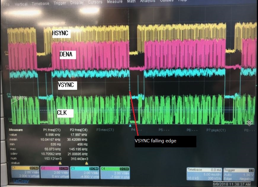

The following LCDC waveforms are output.
The PCLK clock stops at the falling edge of VSYNC.
In the case of active mode, I think that PCLK does not stop, but is there any register setting where PCLK is stopped?

Pixel clock is held in inactive state for passive displays.
