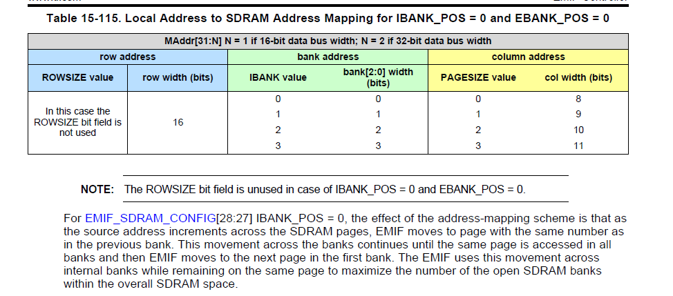

  • Please see the snapshot from the AM5726 TRM Page: 3409. The ROWSIZE field is not used when the IBANK_POS and EBANK_POS are set to 0. Please let us know if you have any other follow-up questions.
    Regards, Siva
  • Hi Siva,
    In my test cases, EBANK_POS =1, i.e.  0x4C0000C is set to 0x08000000, so this case row size should have been used. Please see my captured settings.
    >> My test setting1: 4c000008: 61851bb2 08000000
    >> My test setting2: 4c000008: 61851ab2 08000000
    Jan

    With the settings you shared, the row size is being either set to either 15 bits or 16 bits. I'm not sure about the row size of the DDR memory you are using. Basically, the impact of this setting will be that you will not be able to access the full memory address range. This should not impact your functionality. At this point, I'm not sure if we can comment any further. Let me know if you have any other open questions.
    Regards, Siva
