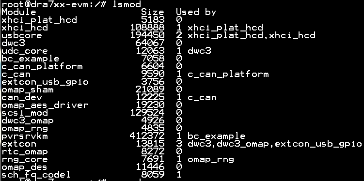

    There is a strange phenomenon when I turn on PCI related settings.
    I use lsmod, you can see the module below,
    But I searched for related information and found that
    When modules are built into the kernel,
    lsmod should not see these modules
    And when I turn off the PCI related settings,
    You can't see any module with lsmod.
    This means that the module is indeed built into the kernel,
    or just because of "disagrees about version of symbol module_layout"
    No module was successfully mounted.

    From your logs I can see that there is a miss-match between the kernel modules (/lib/modules in the file-system), and the kernel image used (/boot/zImage in the file-system). Please make sure you follow the below steps (please follow the step-by-step instruction is section-3 of VDSK Linux user-guide)
    1. make clean
    2. make linux
    3. make linux_install
    4. make depend
    5. make vision_sdk
    6. Create updated file system tar ball (step-7 of section 3.1 of VisionSDK_Linux_UserGuide.pdf in vision-SDK docs).
    7. mksdboot.sh
    8. early-boot-update.sh
    Shravan
    I found out from make linux that he will initialize the kernel's .config,
    So I always use make kernle_menuconfig to change the .config settings after finishing make linux.
    Is my action like this caused the inconsistency between the kernel and module versions?
