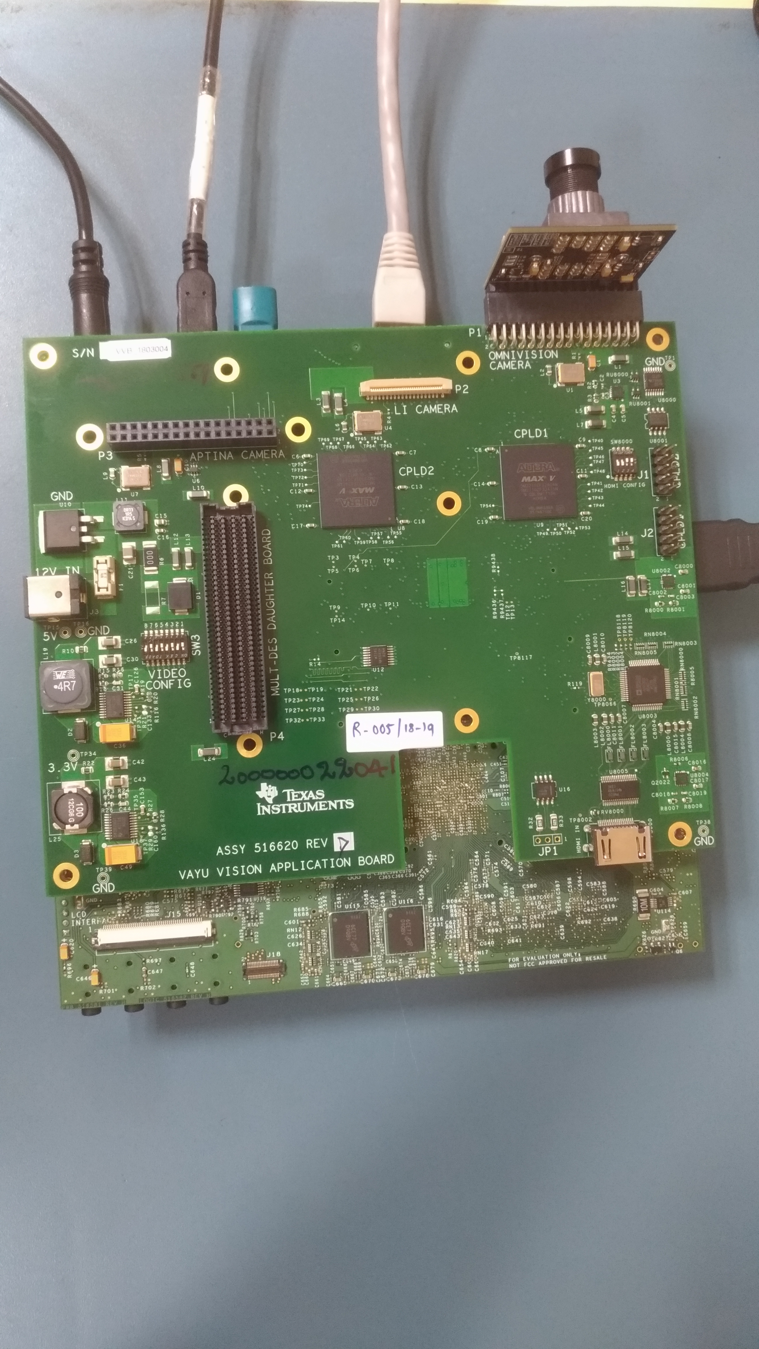

We have the following setup
1. REV - H TDA2xx EVM board
2. VisionSDK 3.3
3. Camera OMNIVision 10635 connected to Vision Application board.
4. Switch SW5 setting on Vision App board,
   OFF pins - 1,3,5,7
   ON  pins - 2,4,6,8
We want to run the simple single camera and display use case, that is  1CH VIP capture + SGX Copy + DISPLAY
We we run this test cases, there are no frames getting captured from camera and shown on HDMI display.  Display just shows CPU loading of M4-0 , SGX , DSP1-2, EVE1-4 and M4-2.
No live camera frames are captured and displayed .
We even see the capture link and VIP and sensor configurations are successful from log below.

  • Hi Uday,
    1. Is OMNIVision 10635 camera connected to P1 port of vision App board or through serdes board ?
    2. Could you please share log (run UC, Press "P" ) ?
    Surya
  • Hi Surya,
    Yes, P1 port of vision app board.
    Please find the logs attached.

  • Hi Uday,
    Can you please share a snap of your setup ?
    Surya
  • Thanks Surya,
    I have uploaded snaps of vision app board and camera connected to vision app board.
    Pl. have a look at it and let me know if anything is incorrect.
    Uday
    Any further clues on this ? Does setup look OK  ?
    Uday
  • Hi Uday,
    Setup looks OK
    Do you have any spare camera, can you check with that ?
    Surya
