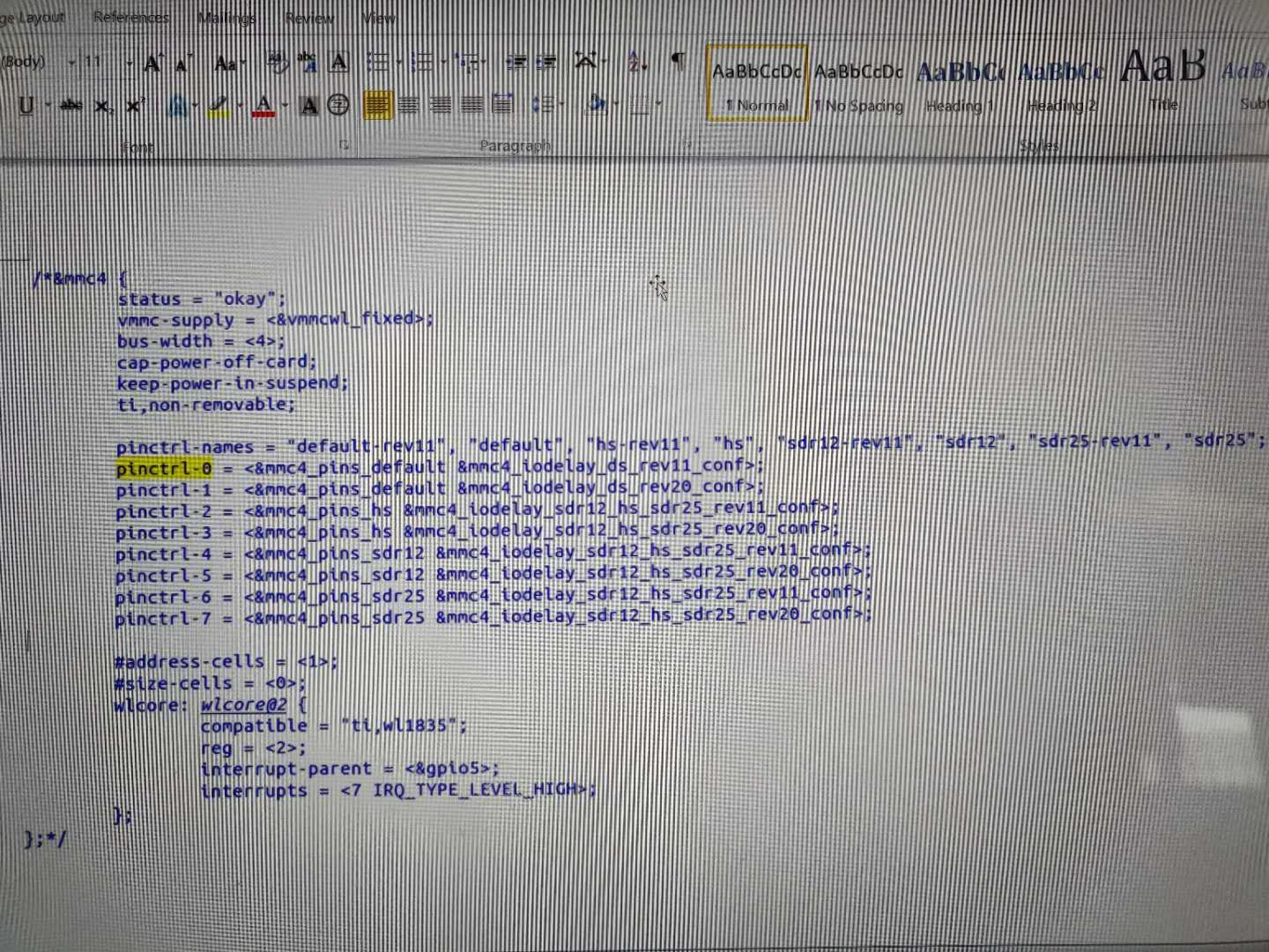

in u-boot modified board/ti/dra7xx/mux_data.h and u-boot/arch/arm/dts/dra7-evm-common.dtsi
1 in file board/ti/dra7xx/mux_data.h
change /*{UART2_CTSN, (M3 | PIN_INPUT_PULLUP)},    /*uart2_ctsn.mmc4_dat2*/
    /*{UART2_RTSN, (M3 | PIN_INPUT_PULLUP)},    /*uart2_rtsn.mmc4_dat3*/
     to
  {UART2_CTSN, (M2 | PIN_INPUT_PULLUP| SLEWCONTROL)
        {UART2_RTSN, (M1 | PIN_INPUT_PULLUP| SLEWCONTROL)
2 u-boot/arch/arm/dts/dra7-evm-common.dtsi:14:
change stdout-path = &uart1;
to
 stdout-path = &uart3;

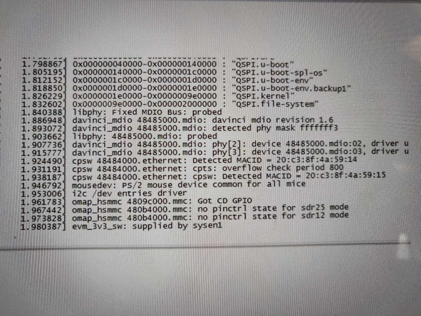

uart3 already has log output  but kernel stopped

Block some code in dra72-evm.dts about MMC4's part.

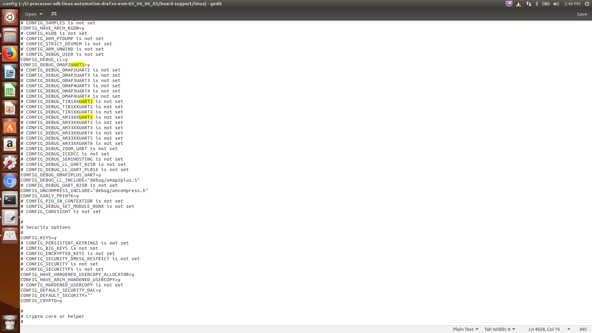

I found  that  board-support/linux/arch/arm/configs/ti_sdk_dra7x_release_defconfig   changed CONFIG_DEBUG_OMAP2UART1=y  1modfied to 3.
make linux£¬CONFIG_DEBUG_OMAP2UART3=y can auto reback CONFIG_DEBUG_OMAP2UART1=y
How to fixed it?

Block some code £¨dra72-evm.dts£© about MMC4's part£º

    Linux : how to change kernel log output port?
    how to change the .config uart1 to uart3 ?

    We has the same problem for TDA2x, and I can offer you the full boot log as follows:

    [    0.000000] Booting Linux on physical CPU 0x0
    [    0.000000] Initializing cgroup subsys cpuset
    [    0.000000] Initializing cgroup subsys cpuacct
    [    0.000000] Linux version 4.4.84-00105-gc66ba60e1092-dirty (root@G2) (gcc version 5.3.1 20160113 (Linaro GCC 5.3-2016.02) ) #7 SMP PREEMPT Mon Jun 11 14:56:09 HKT 2018
    [    0.000000] CPU: ARMv7 Processor [412fc0f2] revision 2 (ARMv7), cr=30c5387d
    [    0.000000] CPU: PIPT / VIPT nonaliasing data cache, PIPT instruction cache
    [    0.000000] Machine model: TI DRA742
    [    0.000000] Reserved memory: created DMA memory pool at 0x0000000040300000, size 3 MiB
    [    0.000000] Reserved memory: initialized node cmem@40300000, compatible id shared-dma-pool
    [    0.000000] Reserved memory: regions without no-map are not yet supported
    [    0.000000] Reserved memory: created CMA memory pool at 0x0000000099000000, size 80 MiB
    [    0.000000] Reserved memory: initialized node ipu2_cma@95800000, compatible id shared-dma-pool
    [    0.000000] Reserved memory: created CMA memory pool at 0x000000009e000000, size 32 MiB
    [    0.000000] Reserved memory: initialized node ipu1_cma@9d000000, compatible id shared-dma-pool
    [    0.000000] Reserved memory: created CMA memory pool at 0x00000000a1000000, size 32 MiB
    [    0.000000] Reserved memory: initialized node dsp1_cma@99000000, compatible id shared-dma-pool
    [    0.000000] Reserved memory: created CMA memory pool at 0x00000000a3000000, size 32 MiB
    [    0.000000] Reserved memory: initialized node dsp2_cma@9f000000, compatible id shared-dma-pool
    [    0.000000] Reserved memory: created DMA memory pool at 0x00000000a9000000, size 64 MiB
    [    0.000000] Reserved memory: initialized node cmem@A9000000, compatible id shared-dma-pool
    [    0.000000] cma: Reserved 24 MiB at 0x00000000be400000
    [    0.000000] Forcing write-allocate cache policy for SMP
    [    0.000000] Memory policy: Data cache writealloc
    [    0.000000] OMAP4: Map 0x00000000bfd00000 to fe600000 for dram barrier
    [    0.000000] DRA752 ES1.1
    [    0.000000] PERCPU: Embedded 11 pages/cpu @ef62b000 s14912 r8192 d21952 u45056
    [    0.000000] Built 1 zonelists in Zone order, mobility grouping on.  Total pages: 243264
    [    0.000000] Kernel command line: console=ttyS2,115200n8 vram=16M root=PARTUUID=80a878a6-02 rw rootwait ip=none mem=1024M
    [    0.000000] PID hash table entries: 4096 (order: 2, 16384 bytes)
    [    0.000000] Dentry cache hash table entries: 131072 (order: 7, 524288 bytes)
    [    0.000000] Inode-cache hash table entries: 65536 (order: 6, 262144 bytes)
    [    0.000000] Memory: 410844K/979968K available (6623K kernel code, 319K rwdata, 2388K rodata, 336K init, 290K bss, 364324K reserved, 204800K cma-reserved, 234496K highmem)
    [    0.000000] Virtual kernel memory layout:
    [    0.000000]     vector  : 0xffff0000 - 0xffff1000   (   4 kB)
    [    0.000000]     fixmap  : 0xffc00000 - 0xfff00000   (3072 kB)
    [    0.000000]     vmalloc : 0xf0800000 - 0xff800000   ( 240 MB)
    [    0.000000]     lowmem  : 0xc0000000 - 0xf0000000   ( 768 MB)
    [    0.000000]     pkmap   : 0xbfe00000 - 0xc0000000   (   2 MB)
    [    0.000000]     modules : 0xbf000000 - 0xbfe00000   (  14 MB)
    [    0.000000]       .text : 0xc0008000 - 0xc08d502c   (9013 kB)
    [    0.000000]       .init : 0xc08d6000 - 0xc092a000   ( 336 kB)
    [    0.000000]       .data : 0xc092a000 - 0xc0979f60   ( 320 kB)
    [    0.000000]        .bss : 0xc097b000 - 0xc09c3800   ( 290 kB)
    [    0.000000] SLUB: HWalign=64, Order=0-3, MinObjects=0, CPUs=2, Nodes=1
    [    0.000000] Preemptible hierarchical RCU implementation.
    [    0.000000]  Build-time adjustment of leaf fanout to 32.
    [    0.000000] NR_IRQS:16 nr_irqs:16 16
    [    0.000000] ti_dt_clocks_register: failed to lookup clock node gmac_gmii_ref_clk_div
    [    0.000000] OMAP clockevent source: timer1 at 32786 Hz
    [    0.000000] Architected cp15 timer(s) running at 6.14MHz (phys).
    [    0.000000] clocksource: arch_sys_counter: mask: 0xffffffffffffff max_cycles: 0x16af5adb9, max_idle_ns: 440795202250 ns
    [    0.000005] sched_clock: 56 bits at 6MHz, resolution 162ns, wraps every 4398046511023ns

    The kernel has stopped at red place when running!
    I'm looking forward for your replay!

    In order to change log output uart 1 to uart3, we changed the u-boot and kernel which caused this problem. And log output is normal using uart1, but uart3 has caugth the problem above. Then I will tell you what I have done.
    First, we modified the u-boot:menuconfig:uart3 used for console , and modified files of board/ti/dra7xx/mux_data.h and u-boot/arch/arm/dts/dra7-evm-common.dtsi,
    1、board/ti/dra7xx/mux_data.h
    modified
    as
    2、u-boot/arch/arm/dts/dra7-evm-common.dtsi:
    modified
    as
    Then we modified the kernel: menuconfig:uart3 used for console ,and modified the files of
    /arch/arm/configs/ti_sdk_dra7x_release_defconfig, dra7-evm-common.dtsi and dra7-evm.dts.
    1、ti_sdk_dra7x_release_defconfig
    modified CONFIG_DEBUG_OMAP2UART1=y as CONFIG_DEBUG_OMAP2UART3=y
    2、dra7-evm-common.dtsi
    modified
    as
    3、dra7-evm.dts
    modified
    0x3f8 (PIN_INPUT_PULLUP | MANUAL_MODE | MUX_MODE3) /*uart2_ctsn.mmc4_dat2 */
    0x3fC (PIN_INPUT_PULLUP | MANUAL_MODE | MUX_MODE3) /* uart2_rtsn.mmc4_dat3 */
    as
    0x3f8 (PIN_INPUT_PULLUP | MANUAL_MODE | MUX_MODE2)
    0x3fc (PIN_INPUT_PULLUP | MANUAL_MODE | MUX_MODE1)
    Finally,we modified the uenv.txt
    args_mmc=part uuid mmc 0:2 uuid; setenv bootargs "console=ttyO0,115200n8 elevator=noop root=PARTUUID=${uuid} rw rootwait earlyprintk fixrtc omapdrm.num_crtc=2 consoleblank=0 cma=128M@0xB0000000 rootfstype=ext4 snd.slots_reserved=1,1"
    modified
    console=ttyO0
    as
    console=ttyS2

    If this is a TI EVM why are you changing the console from UART1 to UART3?
    Also, since you are changing pinmux of mmc4 to be used as uart3 pins, try disabling mmc4 from dra7-evm.dts
    Change status of mmc4 to disabled and test.
    &mmc4 {
    status = "okay";
    &mmc4 {
    status = "disabled";
    Vishal
  • Hi,Vishal,
    we want to use UART1 as another function,so we have done some changes for the TI EVM.
    And I have tried disabling mmc4 from dra7-evm.dts, also, Change status of mmc4 to disabled .But the problem is the same.
    Yuting
