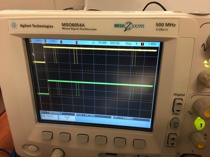

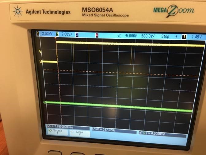

  • Can you try using CCS 8.8? I usually do not use gel files when I debug MLO/u-boot. The gel files set up EMIF and other registers for the GP EVM. In CCS 8.0 when you configure your connection you can select "AM5728" which will not have gel files.
    The board with these errors
    Timed out in wait_for_bb: status=1000
    Trying to boot from MMC1
    tps65903x: could not set LDO1 voltage.
    Looks like i2c timeouts when trying to set LDO1 voltage. I'm guessing this provides the voltage for MMC1?
    Steve K.
  • Can you attach your dts file? I would like to look it over.
    Steve K.

  • We got some wires soldered onto I2C1, SDA and SCK on the board with the bb timeout errors.
    There is activity on the SCK line, in that it jumps from 0V to 3.3V at board powerup, and I've captured the first 5 seconds on our scope.  *** However, the SDA line remains at 0V - likely indicating that either there's a problem or a wire soldering issue.
    We compared the SCK and SDA activity with a PCBA which boots Linux, and on that board there's activity on both SCK and SDA lines.
    Also, on the first board with just SCK doing something, the SCK pattern looks a little bit different than on the good board.  I will try to past my screenshots here:
    PCBA with Alleged Broken SDA I2C1 Lline:
    PCBA with good SDA I2C1 Line:

  •  Here is a trace of I2C1 line within the first ~5 seconds after power-up.
  • Here is the suspect board, also during the first 5 seconds after power-up.
    I forgot to mention, yellow line (channel 1) is I2C1_CLK, green line (channel 2) is I2C1_SDA.  Channel 1 in both good and bad cases was the trigger channel.

  • With U4 and U8 removed from the board, had another hardware engineer double check the impedance (just used a DMM with the board powered off) around one of the resistors where SDA for I2C1 is pulled up (e.g. each end of the resistor pad to ground or pin 1 of the Linux console port), and both ends were OL or infinite impedance. Also measured the voltages on both pads of R16 and they were both 3.3V. Incidentally, this resistor, R16 was DNI on our board.
    Going to have the technician re-solder a wire to the pad of R16 which is connected to SDA i2c1 (or a better pad) to see if the SDA line assumes the correct voltages and post up.
  • What is R16? Are you saying there was no pullup on SDA of the failing board? Is the board working now?
  • Sorry for the long delay!!
    Re-checked both pads of R16 which pulls up the SDA and confirmed now that it was **NOT** populated on the board with the timeouts.
    Had the technician solder some leads so we could "clip on" a 2.2k resistor as required by the schematic.
    Following are the SPL console messages with and without the SDA pullup resistor, R16. Note that the timeout wait_for_bb and could not set LDO messages go away, which is great! Will grep the remaining strings in the SPL..

  • I was asking to use the same card in order to rule out any possible inconsistencies with the cards themselves.  Different cards may support different modes of operation.  For example, the issue might be related to support of UHS-I speeds, but perhaps you're not seeing the issue on the "good" board due to using a card that doesn't support UHS-I speeds.  So my request is to boot one of the good boards using a given card, then power down that board, transfer the card to a bad board, and see its corresponding behavior.
  • Yes sir,
    I'm sorry about confusing the issue by talking about multiple SD cards!!
    For the most recent tests, I used exactly the same SD card (SanDisk, 32GB micro SD HC I, 4 with a circle around it) with exactly the same Linux OS image on it on both the good PCBA and bad PCBA (where the surface mount R16 apparently fell off the board).
    The post from last-night and this morning were with that very same SD card, last-night booting from the bad PCBA - both without and with R16, the SDA pullup and this morning from the good PCBA from a different board house which boots into Linux.
    The bad board doesn't successfully make it out of the SPL, while the good board with the same SD card with the same image (SPL, u-boot, kernel, device tree, FS) boots all the way into Debian..
  • Thanks for clarifying. It sounds like we're aligned regarding the cards.
    I've been digging around to see what I could find regarding that specific issue, but I didn't see any silver bullets. So I think we should perhaps check some fundamentals... It would probably help if you could get a scope on the interface and take a look at the logic levels. What voltage is the signaling? Do the waveforms look clean? What frequency is it running at?
  • Yeah, well long story short - The latest batch of boards appear to have inconsistent missing (??or fallen off??) pullup resistors on the MMC1 lines for the SD card. Interestingly enough, our good boards have DNI for the resistors pulling up the MMC CLK signals for both MMC1 (SD) and MMC2 (emmc), whereas these are populated on the 572xEVM, Rev A3 board I have.
    Going to get with my team to see if it still makes sense to examine the quality of the MMC signals given the above..
  • The MMC/eMMC specifications don't require a pullup on CLK.  I'm not sure why so many TI boards put a pullup on CLK.  The other signals (RST#, CMD, DATx) require pullups.  I suggest that you start by populating the required pullups and re-test to see if that changes the behavior.
