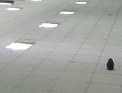

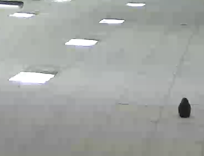

  • Hi All,
    I'm not sure what "dithering" means exactly. But, it seems that I faced the similar issue.
    In CBR, Image quality might be degraded or some frames might be dropped to meet the target bitrate when it is quite low.
    But, it seems that image quality for I-frame is quite differ from one for P-frame when the target bitrate is low. (It was a steady scene. There was no action or something to increase bitrate.)
    i.e. Image quality is good for I-frame but, it is getting worse for P-frames. And then, it becomes good again for the next I-frame. This repeats every second.
    I used a default values for Q-related parameters.
    If I narrow down Q-ranges, there is no difference between I-frame and P-frame.
    But, framedrop is observed. There was no frame drop with default Q-ranges.
    I benchmarked the other IP Camera for the same target bitrate.
    It showed a consistent image quality for I-frame and P-frame.
    For CBR with low target bitrate, how can i get a consistent image quality over I-frame and P-frame minimizing frame drops?
