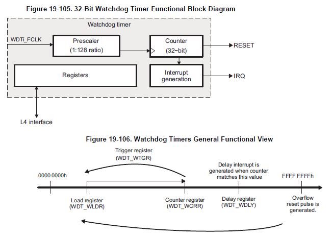

Let me know about enabling WDT overflow interrupt of AM4372.
When WDT overflow occurs, both WDT interrupt and reset are asserted, but is reset occurring after interrupt processing at this time?
I can not understand the behavior of the device when WDT overflow occurs.
