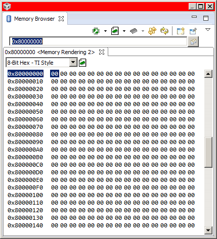

When I say nothing happens, I mean the bytes being read in are there and they match perfectly the original file that is on the eMMC RAM. And the loop executes which copies each word (4 bytes) to the target address, but the bytes at the target address NEVER CHANGE.

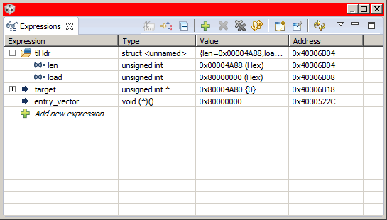

For your viewing pleasure, here is a screen shot of the "expressions" in CCS, which shows that the TI Header is correctly read, the target address started in the right place, and incremented as the loop executed, and even that the entry vector for the boot strapped application is correctly set to 0x80000000.
However, here is the screen shot of the target memory after looping through the file read...  Nothing was copied. (And there was no exception trap (data bus) attempting to copy the bytes into that target, they just didn't get copied)
Naturally, as soon as it attempts to BL to the entry point, the MCU traps with an undefined instruction fault.
So, my question is:
What is going on? What are the required settings to cause a boot loader program in SRAM to write to DDR memory?

  • Well, I managed to get it working.
    There is this code from the bootloader, bl_platform.c, on line 1882, which I used in StarterWare 2.0.1.1:
        /* DDR Initialization */
    #ifdef evmskAM335x
        /* Enable DDR_VTT */
        DDRVTTEnable();
        DDR3Init();
    #elif evmAM335x
        if(BOARD_ID_EVM_DDR3 == BoardIdGet())
            DDR3Init();
        else if(BOARD_ID_EVM_DDR2 == BoardIdGet())
            DDR2Init();
    #else
        DDR2Init();
    #endif
    And since I have a Beaglebone which is neither of the EVM boards, I assume it is supposed to initialize the DDR2 memory.
    Imagine my surprise that the BBB is DDR3.  I removed my call to DDR2Init(), and replaced it with DDR3Init() which I also copied in from the StarterWare (No, I didn't #define evmAM335x  that would have generated other unintended results), and it is now working.  I guess the StarterWare 2.0.1.1 was too old to know that BB "Black" units are DDR3.
    The BBB reference manual identified it as DDR3.  Also, the StarterWare in PDK 1.0.7 made some reference to the "Black" being different as well.
