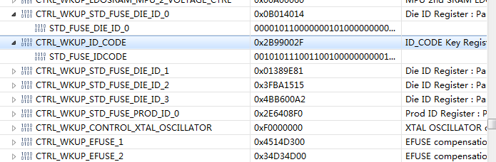

I  get the DIE_ID  used the emulator。  but  i  have  to  read  it  on a15  ,  i  use  the   physical address.
  int id=*(int*)(0x4AE0C200);
printf("id=%d\n", id);

  • You have to mmap physical address to the process space and read it with virtual address.
    There is an easier way to read physical address in Linux by using "omapconf".
    omapconf tool should already be included in SDK targetfs.
    You can run omapconf from the console.
    # omapconf --help
    This will display the available command supported by omapconf.
    #omapconf read 0x4AE0C200
    It will return the value of the physical address provided.

  • Hi Stanley
    root@dra7xx-evm:~# omapconf read 0x4AE0C200
    0B014014
    in console can read, but i want to read in this link ( PROCESSOR_SDK_VISION_03_02_00_00/vision_sdk/links_fw/src/hlos/links_a15/nullSrc)
    thanks
    shuai
  • You have to map the DIE_ID register address to nullSrc Link process space via calling mmap().
    You can find the API doc for mmap() here. man7.org/.../mmap.2.html
    Some example can be found in ~/vision_sdk/links_fw/src/hlos/osa/src/osa_mem.c.
    Stanley
