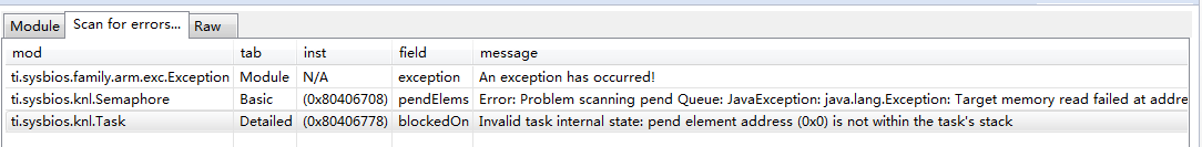

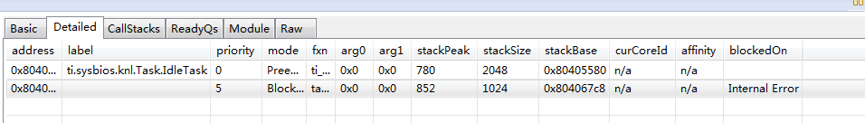

    Can you confirm you are not blowing the stack? Do Tools->ROV->BIOS->Scan for Errors after the system crashes.
    Also check ROV->Tasks->Detailed and ROV->Hwi->Module to see how close the stack peaks are.
    Todd
  • hi,
    Sorry,I don't know what's the means of "blowing the stack".
     Tools->ROV->BIOS->Scan for Errors:
    ,ti.sysbios.family.arm.exc.Exception,Module,N/A,exception,An exception has occurred!
    ,ti.sysbios.knl.Semaphore,Basic,(0x80406708),pendElems,Error: Problem scanning pend Queue: JavaException: java.lang.Exception: Target memory read failed at address: 0x413268e4, length: 8This read is at an INVALID address according to the application's section map. The application is likely either uninitialized or corrupt.
    ,ti.sysbios.knl.Task,Detailed,(0x80406778),blockedOn,Invalid task internal state: pend element address (0x0) is not within the task's stack
    ROV->Tasks->Detailed:
    ,0x804046b4,ti.sysbios.knl.Task.IdleTask,0,Preempted,ti_sysbios_knl_Idle_loop__E,0x0,0x0,780,2048,0x80405580,n/a,n/a,
    ,0x80406778,,5,Blocked,task1,0x0,0x0,852,1024,0x804067c8,n/a,n/a,Internal Error
    ROV->Hwi->Module:
    ,0x804041c8,...,0,0,1052,16384,0x8055faa8
    You can reproduce the problem, which I think is the quickest way to solve the problem.
  • I'm not familiar with the UART_prinf() code, it's not part of TI-RTOS, but I looked at the disassembly of UART_printf() from your posted project and can see that it's calling Semaphore_pend(). Semaphore_pend() cannot be called when the Swi scheduler is disabled, and GateSwi_enter() disables the Swi scheduler.
