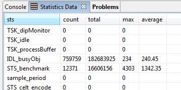

  • Mukul,
    Thanks for the feedback, but I have been reading for a couple of hours now, and I am more confused than before about how CLK_gethtime() and the Period clock work and what their "tick" values are.
    As a test I measure the time consumed by a test algorithm (memcopy) using 1) Period clock, and 2) CLK_gethtime(). Here are the values for both tests:
    1) Period Clock = 1031 "ticks". if a "tick" is defined as (1/CPU clock) then the total time = (1/300MHz) * 1031 = ~3.4uSec
    2) CLK_gethtime() = 6,503"ticks". If a "tick" is defined as (1/CPU clock per this thread) then the total time =(1/300MHz) * 6,503 = 21.7uSec
    I measured the Period clock time by inserting a break point just before the algorithm, then single stepping over it.
    I measured the CLK_gethtime() using STS while running in real time.
    Which is the correct value?
    thx
    MIkeH

  • MikeH,
    I can tell you with certainty that CLK_gethtime() will return the TSCL value and that TSCL increments at a rate of CPU/1.  The counter mechanism is so incredibly simple that there is no way it can be wrong!  In case you don't believe me, here is the code as copied from clk.h62:
    CLK_gethtime    .macro
            mvc TSCL, b4
            mv b4, a4
            .endm
    Yep, that's it!  Only 2 instructions!  It reads TSCL and returns it...
    You must have made a mistake somewhere else.  For example, in your audio calculations, you only have 8-bit data coming in?  Is it mono or stereo?  How is the FIFO threshold configured?  I imagine you're off by a factor of 2 on one of these things...
    Brad

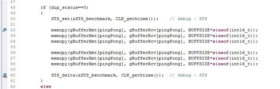

    So let me boil it down to this:
    I have made a measurement using two different techniques (Period Clock and CLK_gethtime()). They give very different results (4.47uSec vs 23uSec). I am trying to figure out why the two are so different. Here is how I made the measurements.
    I created several dummy memcopy's.
    To measure CLK_gethtime I inserted an STS_ with a CLK_gethtime() just before, and just after the group of memcopys. The "benchmark" STS value is as follows (1342 ticks):
    After making the above measurement I inserted break points at the first memcopy and after the last memcopy. After restarting the program and running to the first breakpoint I enabled Period Clock. I then ran the program to the next break point just after the last memcopy. Here is the value of Period Clock (6911 ticks).
    If you calculate the time consumed by each method, the results are as follows:
    This assumes that the "tick" value for each measurement technique is 1/300MHz = 3.3nSec.
    So, my question is, why is Period Clock giving a measurement of 23uSec and gethtime() gives a measurement of 4.47uSec? Or, were am I going wrong?
    Thx
    MikeH
  • MikeH,
    Be careful with your usage of "tick".  Generally speaking when we talk about "ticks" we are talking about "kernel ticks".  This would be synonymous with the 1ms kernel interrupt and related to the return of CLK_getltime(), i.e. the low-res time not the high-res time.
    I have little confidence in the clock feature you are using from CCS.  Given your results I would say that BIOS is right and CCS is wrong.  I'm having trouble finding the documentation for that CCS clock feature, but as I recall there is some delay from the time you hit the breakpoint until the clock actually stops counting.  So in order to get a more accurate measurement you need to setup 3 breakpoints, we'll call them A, B, and C.  In order to measure A->B you need to take the A->C  measurement and then subtract the B->C measurement.  If you do something like that I imagine it will be closer.  To be honest, I'm not even sure what time base that one uses or anything.  I would just stick to CLK_gethtime and forget the CCS profiler clock...
    Brad

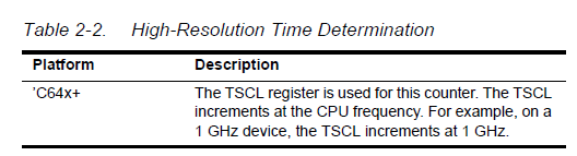

    Again, thanks for the help. I have finally figured out how these various clocks work. I continue to place the blame for much of my confusion on TI's horribly jumbled and confusing documentation.
    My fundamental mistake was somehow thinking gethtime() and getltime() were directly related and used the same hardware timer. I also never heard of TSCL/TSCH until they were metioned in this thread. I went back to the OMAP-L138 data sheet and the C6748 data sheet, which I have read numerous times, and never saw them mentioned. There were vague references to various time stamp counters, but no explanation of what they are and how they work.
    Also, explanations from the BIOS User Guide like this:
    "On the C6000 platform, the 32-bit high-resolution time is calculated by multiplying the low-resolution time (that is, the interrupt count) by the value of the period egister and adding the current value of the timer counter register. To obtain the value of the high-resolution time you can call CLK_gethtime from your application code. The value of both clock restart at 0 when the maximum 32-bit value is reached."
    ...tend to confuse me even more. No where in the BIOS User Guide does it specifically say, "gethtime is derived from the Time Stamp Counter which is driven by the DSP CPU clock".....unless I missed it.
    I've given up on the Profile Clock since it seems to be targeted for emulation and seems to be hit or miss in accuracy.
    Again, thanks for your help.

  • MikeH,
    FYI, the latest version of BIOS has corrected this issue.  Here is the new Table 2-2 which is much improved:
    Now at least it mentions TSCL by name and even if you don't know what it is, you at least have something precise to search for!
    Brad
  • Thanks for the update Brad. This is certainly a step in the right direction.
    MikeH
