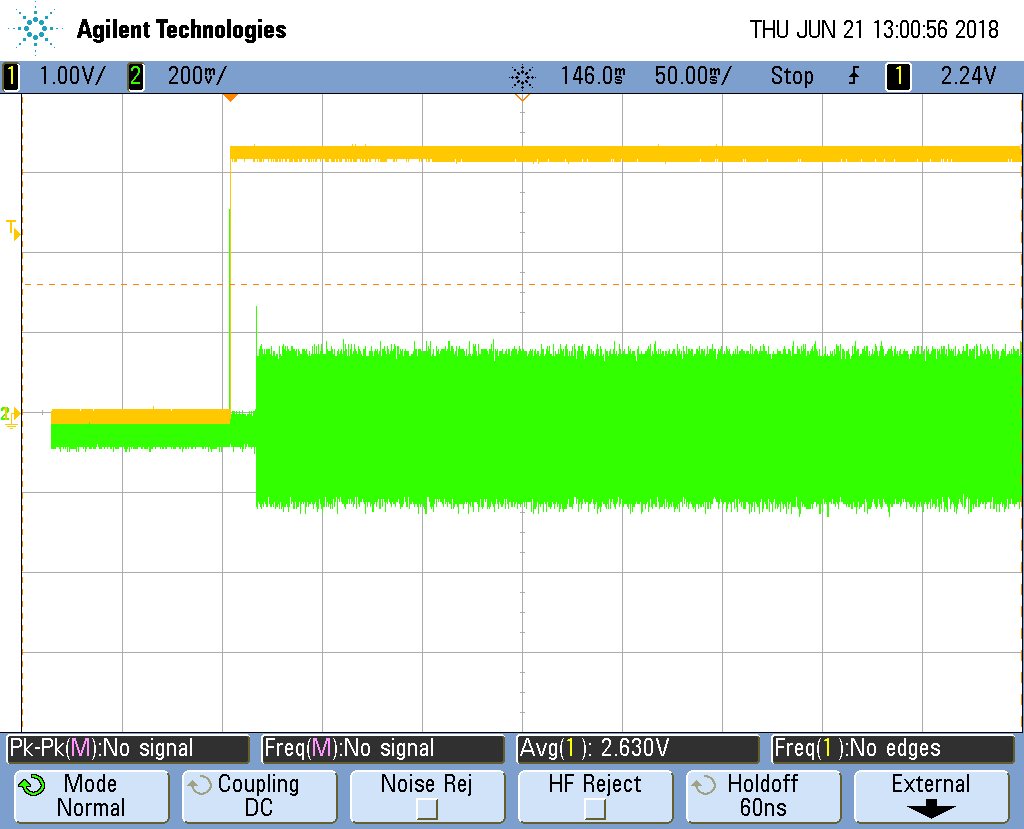

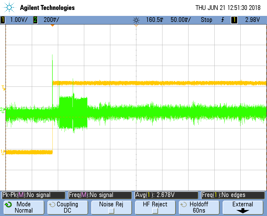

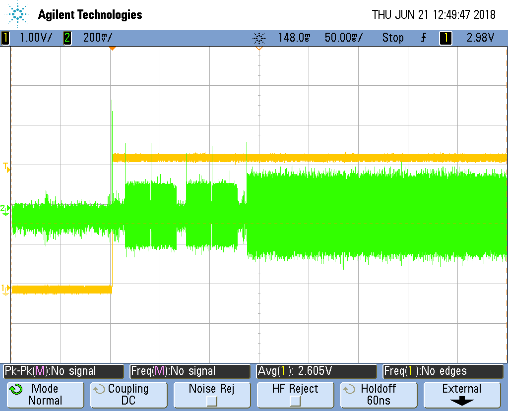

Here some images of my problem:
-          Yellow colour is the PWR_GD signal from the CPU to the PCIe card.
-          Green is TX0_P (from CPU to one of my PCIe connectors where a PCIe card is inserted). .Oscilloscope measurements are single ended
We can see that after PWR_GD goes high, there is some information exchange that continues when the link is established but stops when it fails. Furthermore I see that the electrical levels in this negotiation are not constant which really concerns me.
Example of my card (where each lane is routed to one PCIe connector) when link fails:
Example of my card when link succeed
Example of evaluation kit (where the two lanes are routed to one PCIe connector)
 Here we see that electrical levels are constant and there is no initial burst information. It is continuous.
Do you have any hint about what the problem could be?

  • Hello Jorge,
    To start, please review SPRAAR7 to ensure that all layout guidelines were correctly implemented. Please note that there is a device-specific appendix that includes specific requirements for AM572x devices.
    A great majority of the PCIe issues we see can be traced to layout issues.
  • Hi, Jorge,
    Just checking to see if you made any progress on this issue and found any layout issues as suggested by DK. You may want to try different board or a TI EVM to see if the issue persists.
    If you don't have any more questions, I'll close this thread. If the issue is resolved, please click "resolved" button. Thanks!
    Rex

  • Hello Jorge,
    The traces for your board, both pass and fail, show what appears to be excessive noise on the interface. Note that this noise does not appear on the TI EVM trace you provided. This noise looks to be somewhat periodic in nature so my first suspicion is that it is cross-talk induced.
    My recommendation is to re-review your layout looking for instances where the keep-out and/or impedance matching rules defined in SPRAAR7 are not followed. If this re-review doesn't yield any likely noise sources or impedance deviations, please review the SoC power supply/grounding requirements to ensure that this noise is not being introduced as part of the PCB power delivery network.
