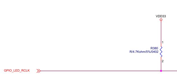

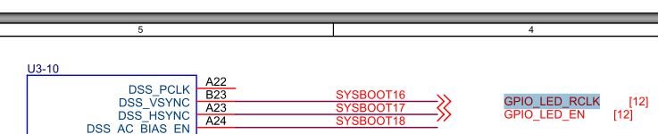

  • Hi Bin:
        Yes, I check the sysboot bit 16 and it have already been pull up by a LED control(1b = USB  DP/DM swapped in datasheet decribed). But I would like to know which place swap the DP/DM ?
    Do you mean boot from QSPI flash and SDcard use the different USB configuration in the USB driver?  As you know, our SDcard boot no problem to detect it.
    So I only conside this swap in the usb driver for boot from QSPI flash, it not the same path with SDcard boot I think.
    And I will remove the resistor for a try to check if it can detect USB when boot from QSPI flash,  if you have the resource in the source code side, please let us know.
    Thanks very much.
  • Rance,
    Do you mean your board permanently pulls up sysboot bit16 for both qspi and usb boot?
    Can you please share the whole sysboot value you used for both qspi and usb boot mode?
    The sysboot bit16 is not used by uboot, the DP/DM swapping is done in ROM, I don't have access to the ROM source code right now to check why it is different in qspi and usb boot mode, but the TRM section 5.2.5.2 ("SYSBOOT Configuration Pins") show bit16 is "don't care" for some boot modes. That is why I want to know the whole sysboot config you used for qspi and usb boot mode.
    If you board layout doesn't physically swap DP/DM, you should't pull up bit16.
  • Hi Bin:
         Our layout didn't swap the DP/DM, Maybe booting from sdcard swap default setings for the DP/DM in the ROM code which we can not see it.
    So we can detect USB disk in sdcard boot up mode. Because the bit 16 is high as default.
    QSPI flash maybe use the normal configuration for the DP/DM in the ROM code which I guess.  And we remove the resistor R308 in the following picture which connect to the 3.3V. The USB disk can be detected now.

    Can both usb and qspi boot detect usb devices now after removed the bit16 pullup? I am still not sure what exactly the issue was. Can you please provide the whole sysboot config value (for all the pins) you use in both usb and qspi boot mode? The values should give a clue.
  • Hi Bin:
    After remove the resistor, the SDcard also can detect USB correctly. This is also confuse me also.
    All our system config as following:
    SYSBOOT[4:0]: 11000
    SYSBOOT[5]: X (means not mount any conponent, don't care)
    SYSBOOT[6-7]:00
    SYSBOOT[8-9]:XX
    SYSBOOT[10]:0
    SYSBOOT[11]: X
    SYSBOOT[12-13]:00
    SYSBOOT[14-15]:10
    SYSBOOT[16-17]:00 --> sysboot16 and 17 reuse as LED control, and it pull high by a 3.3V.
    SYSBOOT[18]: X
  • Rance,
    okay, you use the same sysboot config [4:0]=11000 for both SDcard and qspi boot, so usb dp/dm swapping status should be the same, unless something else changed it, for example, if sysboot[16] has been pulled down by led control in sd card boot.
    To check this, keep the bit[16] pullup resister on your board, and read the CONTROL MODULE CTRL_STS register (TRM Section 7.3.1.4) which shows the sysboot config value, and check if its bit[16] is the same in sd card and qspi boot.

  • Rance,
    Do you mean bit16 is 1 (DP/DM swapped) for both boot modes? If so it sounds the problem is caused by something else.
    Since removing sysboot bit16 external pullup solves the issue, are you okay to use it as the solution? Or you have to keep the pullup and find other solution?
  • Hi Bin:
           Yes, the bit16 change with the different boot mode. Next version we will not use the sysboot 16 to control led, and we will remove it for the pull up resistor.
    And it is OK for us.
    Thanks for your help.
  • Rance,
    Sounds a good plan. I am closing this thread.
