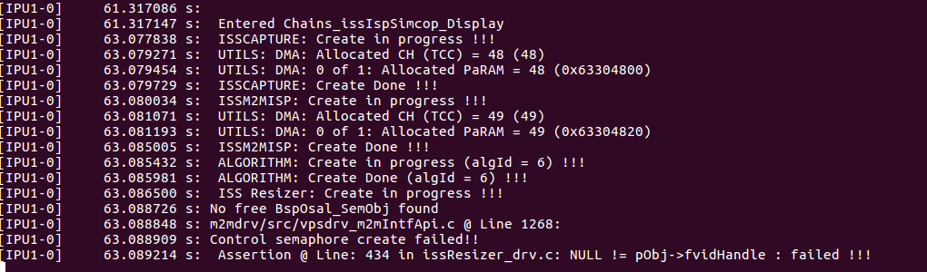

We are using PROCESSOR SDK 03.03.00.00. We have created a new usecase which consists of only 2 links on IPU1_0 core.
One of the links is for the CAN-FD and other is a test link for sending commands to the CAN-FD link.
It is working fine when we select the our usecase from the menu.
But when we select our camera usecase "Chains_issIspSimcop_Display" we are observing issue shown below.
If we comment the init call of CAN-FD link from the system_initDeinitLinks.c file, "Chains_issIspSimcop_Display" usecase works fine without any such errors.
Following API's are used in the CAN-FD init link API:-
1. System_registerLink for registering the link
2. Utils_tskCreate to create main task for CAN-FD link.
Queries:-
1. Does a task creation for the link in the link init API affects other link ?
2. Is there any MAX COUNT for the semaphores that need to be changed if a new link is added in vision sdk ?
