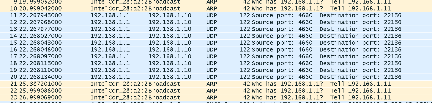

I want to test PA EMAC example with PC. I referred this document  http://processors.wiki.ti.com/index.php/Processor_SDK_RTOS_PA.
I tried to run C:\ti\pdk_keystone2_3_01_04_07\packages\ti\drv\pa\example\emacExample in external loop-back OR No loop-back on EVMK2H so as to connect with PC to test the example.
but it is getting stuck in
/* Wait for SGMII Link */
if (!cpswSimTest)
do
CSL_SGMII_getStatus(macPortNum, &sgmiiStatus);
}while (sgmiiStatus.bIsLinkUp != 1);
I have referred this link
I am facing similar problem . I didn't get any solution from that link.
while on both Ethernet jack I see the link LED is UP and showing 1Gbps Link status.
I have two RJ-45 connector and I have connected Ethernet cable from one RJ-45 to PC.I changed the  RJ-45 port and tried but result is same.
Please help me to solve this.

    That C:\ti\pdk_keystone2_3_01_04_07\packages\ti\drv\pa\example\emacExample is from MCSDK and not supported. Please move to latest processor SDK RTOS 4.3 release and you should not have such problem. Another thing to check is do you TI K2H EVM in no-boot mode, do you run the GEL to initialize the board?
    Regards, Eric
  • Hi Eric,
    I tried with C:\ti\pdk_k2hk_4_0_9\packages\ti\drv\pa\example\emacExample but I got same results.
    I kept EVM in no boot mode and used GEL file to initialize.
    Mahima Shanbag
    I don't see any issue. Attached is my binary (it was build from PDK 4.0.7, the K2H is in maintenance and the driver is not changed for a long time, so 4.0.7 or the latest 4.0.9 should be the same).

    Then load the binary and ran:
    [arm_A15_0] **************************************************
    ******* Ethernet Single Core Example Start *******
    QMSS successfully initialized
    CPPI successfully initialized
    PASS successfully initialized
    SGMII Serdes Common Init Complete
    SGMII Serdes Lanes Init Complete
    Ethernet subsystem successfully initialized
    Tx setup successfully done
    Rx setup successfully done
    PASS setup successfully done
    Following is the ALE table before transmits.
    Frames Received                0
    Rx Frame Fragments Received               0
    Total Received Bytes in Good Frames       0
    Good Frames Sent                          0
    Good Broadcast Frames Sent                0
    Good Multicast Frames Sent                0
    PauseTx Frames Sent                       0
    Frames Where Transmission was Deferred    0
    Total Frames Sent With Collision          0
    Frames Sent with Exactly One Collision    0
    Frames Sent with Multiple Colisions       0
    Tx Frames Lost Due to Excessive Collisions0
    Tx Frames Lost Due to a Late Collision    0
    Tx Frames Lost Due to Carrier Sense Loss  0
    Total Transmitted Bytes in Good Frames    0
    Total Tx&Rx with Octet Size of 64         0
    Total Tx&Rx with Octet Size of 65 to 127  0
    Total Tx&Rx with Octet Size of 128 to 255 0
    Total Tx&Rx with Octet Size of 256 to 511 0
    Total Tx&Rx with Octet Size of 512 to 1023 0
    Total Tx&Rx with Octet Size of >=1024     0
    Sum of all Octets Tx or Rx on the Network 0
    Frames Received                0
    Good Frames Sent                          0
    Packet Transmission Start ...
    Following is the ALE table after transmits.
    Packet Transmission Done.
    Wait for all packets to be Received from EMAC port 0...
    Packets Sent = 10
    Packets Received = 10
    Wait for all packets to be Received from EMAC port 1...
    Packets Sent = 10
    Wait for all packets to be Received from EMAC port 2...
    Packets Sent = 10
    Wait for all packets to be Received from EMAC port 3...
    Packets Sent = 10
    Example Done!

    Since this is the internal loopback (int cpswLpbkMode = CPSW_LOOPBACK_INTERNAL;), you don't need any cable connected to RJ-45 port.
    If you change this to: int cpswLpbkMode = CPSW_LOOPBACK_NONE and rebuild. Then you can connect the Ethernet port to a PC and capture the packets sent out from EVM.
    https://e2e.ti.com/cfs-file/__key/communityserver-discussions-components-files/791/PA_5F00_emacExample_5F00_K2HArmBiosExampleProject_5F00_int_5F00_loopback.out
    Regards, Eric

    I tried your binary, it worked on my setup. This is the only change: "cpswLpbkMode = CPSW_LOOPBACK_NONE". And I saw 10 packets captured by Wireshark.
    Received 0 packets so far...
    Port = 2, MAC address = 68:05:ca:28:a2:20, unicast_type = 3
    Packets Sent = 10
    Packets Received = 0
    Packets Sent = 10
    Example Done!
