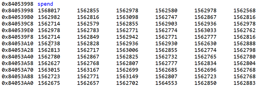

    Sorry for the late response! I tested I2C bus with 400kbps and used a timer to track the time spend for each I2C_transfer for 100 times:
       time[loop] = TSCL;
       status = I2C_transfer(handle, &i2cTransaction);
       spend[loop] = TSCL - time[loop];
    The time spend is quite consistent,  I can't reproduce your issue.
    Regards, Eric

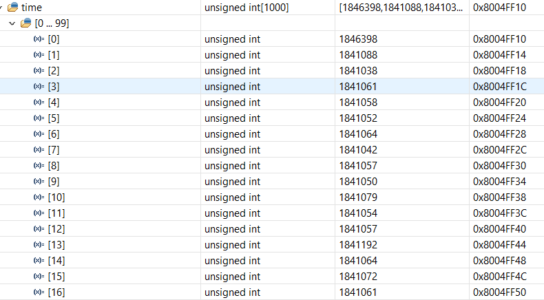

    I was able to regenerate the I2C write time inconsistency issue with TI pdk_am57xx_1_0_7  I2C eeprom example. I am taking example present in pdk_am57xx_1_0_7/packages/ti/drv/i2c/example/eeprom_read,  modifying it as per requirement while keeping basic configuration same.
    Impending changes in the application:
    while(1)
    memcpy(&txBuf[1], (mod + idx), wrcount);  /* mod is pointer to array of 45932 bytes */
    I2C_transactionInit(&i2cTransaction);
    i2cTransaction.slaveAddress = I2C_EEPROM_ADDR;  /* slave address = 0x50 */
    i2cTransaction.writeBuf = (uint8_t *)&txBuf[0];
    i2cTransaction.writeCount = I2C_EEPROM_ADDR_SIZE + wrcount;  /* wrcount = 30 */
    i2cTransaction.readBuf = (uint8_t *)&rxBuf[0];
    i2cTransaction.readCount = 0;
    i2cTransaction.timeout = I2C_TRANSACTION_TIMEOUT;
    transferStatus = I2C_transfer(handle, &i2cTransaction);
    if(I2C_STS_SUCCESS != transferStatus)
    System_printf("Write Data Transfer failed with transfer status %d \n",transferStatus);
    bytes -= wrcount;
    idx += wrcount;
    if (bytes == 0)
    break;
    if (bytes <= wrcount)
    wrcount = bytes;
    Task_sleep(4);
    And then using http://processors.wiki.ti.com/index.php/Linux_IPC_on_AM57xx#Adding_IPC_to_an_existing_TI_RTOS_application_on_the_DSP to create final application.
    With this, time is not at all consistent. Hope you can reproduce the same and help to solve it.
    Thanks & Regards,
    Raksha
    Can you clarify just run your pdk_am57xx_1_0_7/packages/ti/drv/i2c/example/eeprom_read on DSP core alone WITHOUT Linux, are you able to see the transfer timing variation?
    Regards, Eric
    Also I tried your suggested code modification:
    - I used pdk_am57xx_1_0_11\packages\MyExampleProjects\I2C_BasicExample_idkAM572x_c66xExampleProject,
    - attached is the main_eeprom_read.c where my code is under "PROFILE"

        int16_t transferStatus;
    #ifdef PROFILE
        char txArray[12000];
        uint32_t wrcount = 30, bytes = 12000, idx = 0, loop = 0, prevT = 0;
        TSCL = 0;
    #endif
        /* Set the I2C EEPROM write/read address */
        txBuf[0] = (I2C_EEPROM_TEST_ADDR >> 8) & 0xff; /* EEPROM memory high address byte */
        txBuf[1] = I2C_EEPROM_TEST_ADDR & 0xff;        /* EEPROM memory low address byte */
        I2C_init();
        I2C_Params_init(&i2cParams);
        handle = I2C_open(I2C_EEPROM_INSTANCE, &i2cParams);
    #ifndef PROFILE
        i2cTransaction.writeCount = I2C_EEPROM_ADDR_SIZE;
        i2cTransaction.readCount = I2C_EEPROM_TEST_LENGTH;
    #else
        while(loop < 1000)
            memcpy(&txBuf[1], &txArray[idx], wrcount); /* mod is pointer to array of 45932 bytes */
            prevT =  TSCL;
            time[loop++] = TSCL - prevT;
            bytes -= wrcount;
            idx += wrcount;
            if (bytes == 0)
            break;
            wrcount = bytes;
            Task_sleep(4);
    #endif
            I2C_log("\n Data Transfer failed with transfer status %d \n",transferStatus);
            test_pass=FALSE;
            goto exit_test;
        I2C_close(handle);
    #if defined (evmK2H) || defined (evmK2K) || defined (evmK2E) || defined (evmK2L) || defined (evmK2G) || defined (iceK2G) || defined (evmC6678)  || defined (evmC6657) || defined (iceK2G) || defined (evmOMAPL137)
        /* EEPROM not programmed on K2 EVMs, copy rx data to eepromData
           so it can pass the test */
        memcpy(eepromData, rxBuf, I2C_EEPROM_TEST_LENGTH);
    #endif
        status = CompareData(&eepromData[0], &rxBuf[0], I2C_EEPROM_TEST_LENGTH);
        if(TRUE == status)
            I2C_log("\n EEPROM data matched \n");
           test_pass=TRUE;
        else
           test_pass=FALSE;
    exit_test:
       if(TRUE == test_pass)
           UART_printStatus("\n All tests have passed. \n");
        else
            UART_printStatus("\n Some tests have failed. \n");
        while (1) {
     *  ======== main ========
    int main(void)
        if (Board_initI2C() == false)
            return (0);
    #if defined (SOC_AM335X) || defined (SOC_AM437x) || defined (SOC_OMAPL137)
    	Task_Handle task;
    	Error_Block eb;
        Error_init(&eb);
        task = Task_create(i2c_test, NULL, &eb);
        if (task == NULL) {
            System_printf("Task_create() failed!\n");
            BIOS_exit(0);
    #endif
        /* Start BIOS */
        BIOS_start();
        return (0);
     *  ======== CompareData ========
    bool CompareData(char *expData, char *rxData, unsigned int length)
        uint32_t idx = 0;
        uint32_t match = 1;
        bool retVal = false;
        for(idx = 0; ((idx < length) && (match != 0)); idx++)
            if(*expData != *rxData) match = 0;
            expData++;
            rxData++;
        if(match == 1) retVal = true;
        return retVal;
    I didn't see any big variation.
    Regards, Eric
    If I run pdk_am57xx_1_0_7/packages/ti/drv/i2c/example/eeprom_read on DSP core alone WITHOUT Linux, I am not seeing time variation.
    But if I using ccs application build through http://processors.wiki.ti.com/index.php/Linux_IPC_on_AM57xx#Adding_IPC_to_an_existing_TI_RTOS_application_on_the_DSP and running this binary as remote application when linux boots up, I am seeing time variation.
    Also, note that I am not debugging with JTAG here, so you might want to print time taken at the end of transaction.
    Thanks & Regards,
    Raksha
