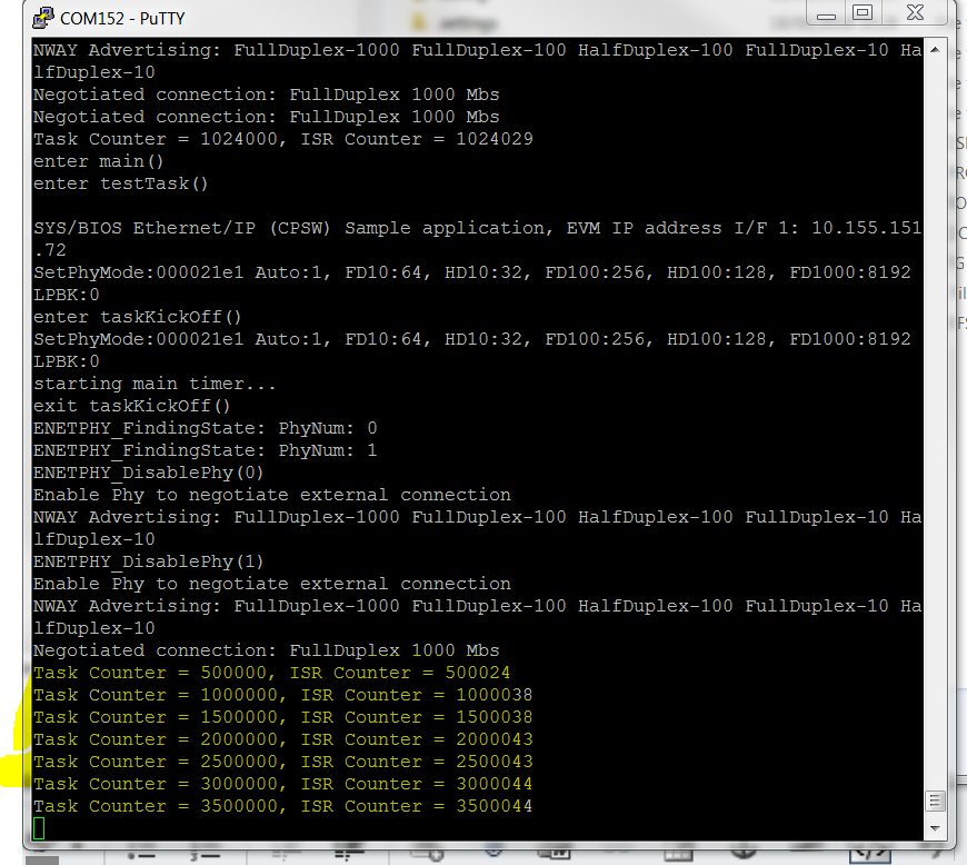

I have created a simple application with NDK configured by the XGCONF tools, where I used default settings for the NDK as for NIMU_BasicExample_idkAM572x_armExampleproject.
Additionally, in the application, I have created
  • HW timer taken from the <ti/sysbios/family/arm/systimer/Timer.h>, configured to run at 32Khz.
    • Timer routine posts a semaphore and increments a counter.
  • An TI RTOS task running with highest priority of 15, which waits for the semaphore signal from the timer ISR and then increments another counter.
  • Another TI RTOS task running at low priority, which kick offs the timer by making call to Timer_start(...), and then exits.
  • The purpose of this low priority task is to make the high priority task block and only then start the timer.
  • The NDK is running with no additional services, I'm able to get a ping from my PC.
The high priority task does not do any additional job except when the counter of the high priority task reaches some value (equivalent to 32 seconds of operation in the example), it prints out the values of the ISR counter and the task counter.
I would expect that counter incremented in ISR will have the same value as counter incremented in the high priority task, but the result is different:
the ISR counter is higher than one incremented in the high priority task. It looks like there is a glitch of tens of cycles in high priority task scheduling caused by the NDK, since
without NDK it is working fine.NDK_TestProject.zip
Am I missing something here?
Please provide an explanation of what causes this situation and what should I do to allow real time and periodic operation of my high priority tasks when NDK stack is running.
The project is attached.
Thanks, Anatoly.

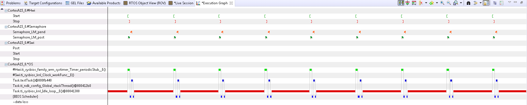

  • Anatoly,
    I can reproduce the task/isr counters mis-match issue in my setup, and can see the counters matched when updating the semaphore mode from binary to counting, which seem indicate NDK does cause the glitch of the timer task.
    The highest priority level of task - kernel task in NDK is configured to 11, which is lower than the timer task level you set. Also I tried to change the timer task to swi which definitely has higher priority than any tasks , but still see the glitch, will discuss with SYS/BIOS team to see if any thing missing here.
    With the Semaphore_Mode_COUNTING, there might be small jitter for your timer task, would it be acceptable for your project or a hard real time is required?
    Garrett
  • The execution graph does indicate the timer ISR/task are interfered by ndk_config_Global_stackThread, trying to find a solution -
    -Garrett

  • Hi, Garret.
    We are really concerned about the fact, that some task from a network stack blocks an HWI from running...
    This is not what we expected, please try to find the solution for that. Patch for NDK is fine.

  • Anatoly,
    NC_OPMODE_POLLING would not make difference here. If you look at the EMAC_poll_pkt_v4() in EMAC driver, the polling mode is actually pending on semaphore posted from EMAC receive ISR. We are actively debugging the issue, will update you if any progress.
    Garrett
  • Anatoly,
    We are able to root cause the timer glitch issue to the EMAC driver that disabling/restoring global interrupt in EMAC_poll_v4(). We are seeing the counters matching after commenting out calls to EMAC_osalHardwareIntDisable() and EMAC_osalHardwareIntRestore() in the function EMAC_poll_v4(). This interrupt handling should not be required as we are polling the PHY status via MDIO. LINK interrupts are not enabled at the PHY for the EMAC driver v4.
    You can workaround the issue by adding the updated emac_drve_v4.c under pdk_am57xx_1_0_10\packages\ti\drv\emac\src\v4\ to your CCS project or rebuild the EMAC driver with the instruction here - processors.wiki.ti.com/.../Rebuilding_The_PDK
    C:\ti\pdk_[soc]_[version]\packages> pdksetupenv.bat
    Then
    C:\ti\pdk_[soc]_[version]\packages>gmake emac_clean
    I have created a ticket to track the issue so that the emac driver fix can be pulled into next PDK release.
    Garrett
