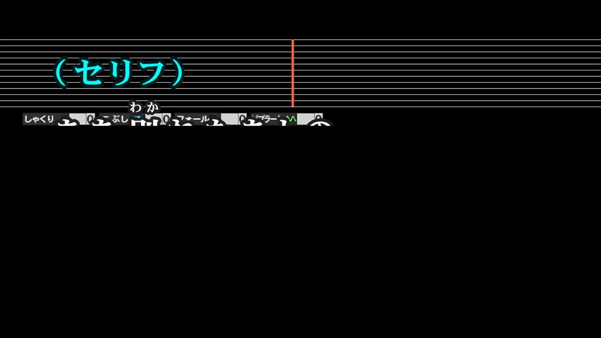

Hi.
we use all plane of DSS. Of that, VID1 plane(zorder is below than VID3) use VIDEO and VID3 plane(zorder is upper than VID1) use GUI for HDMI display. because VID3 plane is GUI, zorder of VID3 plane must have upper value than zorder of VID1 plane(VIDEO).
we works well throung (VID1 + VID3) -> overlay.
but, When VID3 plane have as follwoing GUI (attached file(bmp_0.bmp)), HDMI display have some abnormal pixel at specific position.
we debug gpu and dss during some day and then we have result that alpha blending of DSS have any problem.
we attach source file(tt.7z) https://e2e.ti.com/cfs-file/__key/communityserver-discussions-components-files/791/tt.7z that can see this.
this source file(tt.7z) have as follow it.
- we clearly see abnormal pixel throug 1080i display resolution.(JUN_1080I_SUPPORT)
- HDMI connctor id is 36, VID1 plane is 37 for video and VID3 plane is 43 for GUI at our custom board.(JUN_BITMAP_LOAD_TEST)
- bmp_0.bmp is loaded on VID3 plane(JUN_PLANE2_BITMAP_LOAD)
- fill_bitmap of buffer.c forcely replace red color to find specific postion that HDMI display abnormal pixel(we attach TV display).
  -> we can mark(delete) pixel debug not to see red color.
we try to change global alpha, premultiply alpha blending and zorder many times. we don't find correct solution.
-./drmzalpha -s 1920x1080 -w 37:0:255:0 -w 43:1:255:1
./drmzalpha -s 1920x1080 -w 37:0:255:1 -w 43:1:255:0
./drmzalpha -s 1920x1080 -w 37:0:255:0 -w 43:4:255:0
./drmzalpha -s 1920x1080 -w 37:1:254:1 -w 43:2:255:1
I want to resolve this  DSS alpha blending's problem will be fixed.
Thanks a lot.

  • It's caused by scaling.
    For example, if there are two pixels, one below and one above. The one above is 0x00ffffff, and the one below 0xff000000. So the above one is totally transparent white pixel, below one is totally opaque black pixel.
    Presuming a black background, without scaling, this will not show anything on the screen, as the above pixel is seen through and shows the black background, and the below pixel is black itself. This is as it should.
    But with scaling, the pixels values get "averaged" by the scaler. The end result may be, say, 0x7f7f7f7f, i.e. the average of the two pixels.
    This pixel is half transparent grey pixel, which is not the expected result, of course.
    The best way around this may be to just not use scaling.

  • Hi Joonho,
    Can you please do another level of testing and let me know the results?
    1. Can you try the up-scaling of gui without the video overlay and see if the issue still exists?
    2. If you don't see issue with just gui scaling, can you switch to non transparent GUI plane (e.g. not using RGBA, but RGB or RGBX format in the gui plane) and try the blending?
    Manisha

  • Hi Joonho,
    The DSS IP expert has below comments -
    1. DSS should be only used to scale video or natural images (That is why DSS IP has a “VIDEO” pipeline with Scaling and a “GFX” pipeline with no scaling in DSS). GFX/GUI (GPU or CPU generated) should always be generated at display resolution such that it is never scaled inside DSS.
      1. GRPX image scaling might do fine if the source image (particularly alpha value) has single alpha value or pixels (including alpha value) are anti-aliased prior to scaling.
    2. Force DSS scaler to not do low pass filtering while resizing. This is possible by changing the filter coefficient to a different set than the default. This is exactly what is done in the patch in,
    The above patch changes the scaler filtering to a “Nearest-Neighbor” algorithm
    This patch will not work in all cases and will perform poorly while scaling Video or natural images.
    Manisha
