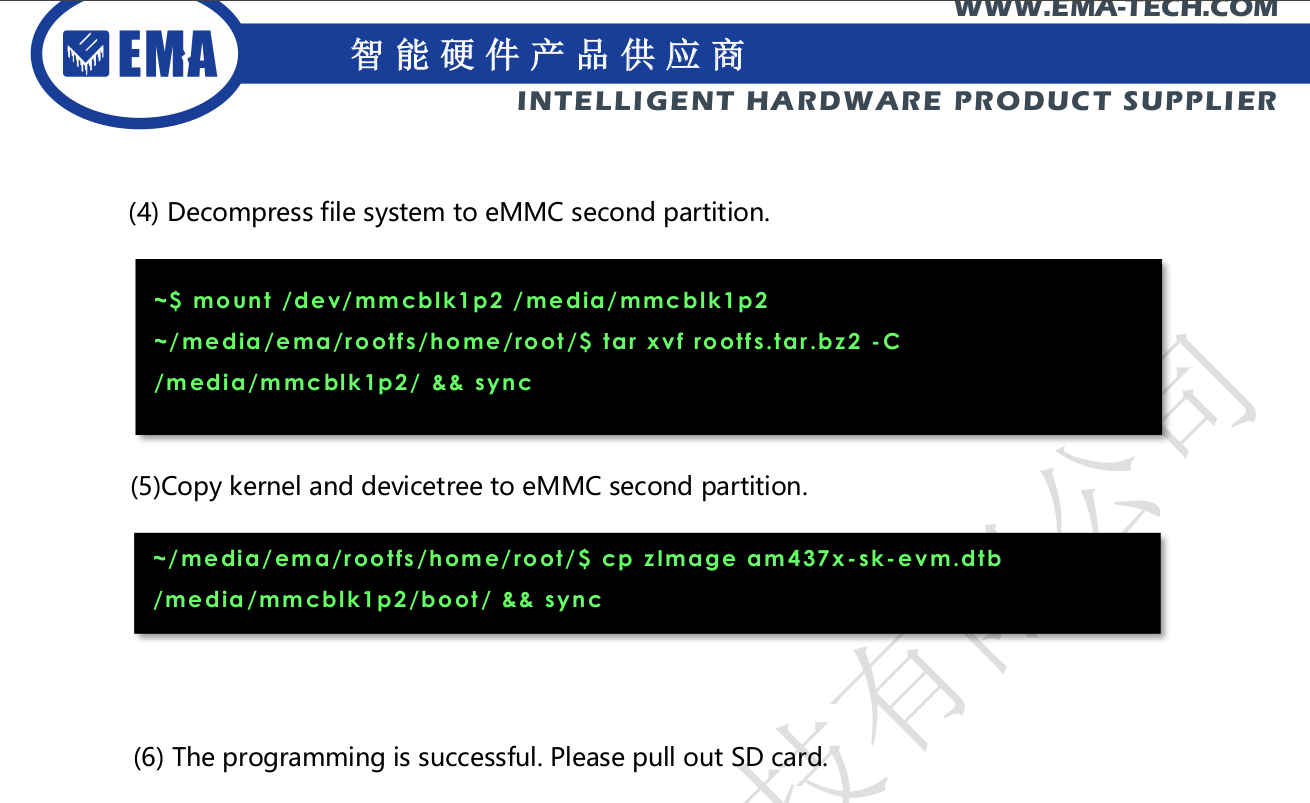

I am having a strange problem in AM4379 EVM Board. I cant boot EVM from eMMC But I successfully boot my EVM Board in SD card booting method.
I followed the procedure from user manual here i have attached the user manual PDF.
I can see u-boot console in Linux Host system in minicom terminal by using SD card boot
But I cant see u-boot console in Linux host system in minicom.
What I done before is following
Step 1 :
I can successfully partition the eMMC memory  mkcard_ext4.sh partion script that i got from my vendor.
Step 2 :
Burn the Linux yocto OS in eMMC as per the user manual
Step 3 :
Short the boot jumper using cap on SOM4379 and power on the EVM but nothing is showed in Linux host system in Serial terminal (minicom). so in that case I cant see u-boot  log in console.
