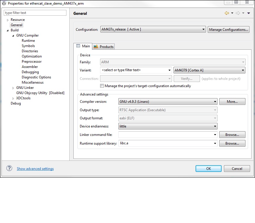

I am attempting to get the Ethercat Slave demo project to run on the IDK437X development kit.
I have built the application in CCS and copied the output "app" from "\PRU-ICSS-EtherCAT_Slave_01.00.05.00\protocols\ethercat_slave\projects\ethercat_slave_demo_AM437x_arm\AM437x_debug\app" to my SD card.
It appears to boot, but I cant see the application run and am not really sure what terminal output will occur if/when it runs?
Below is the output from the terminal port which appears to show at least the MLO is OK.
StarterWare Boot Loader
BOARDInit status [0x0]
SoC : [AM43XX]
Core : [A9]
Board Detected : [IDKEVM]
Base Board Revision : [UNKNOWN]
Daughter Card Revision: [UNKNOWN]
Copying application image from MMC/SD card to RAM
Jumping to StarterWare Application...
Any ideas where I can search after this?
I tried adding UART_printf("\nStarting Twincat Slave Demo"); in main() before common_main is called, but nothing is output on the terminal.
Any help would be appreciated. I dont have any experience with Ti RTOS, so bit of a learning exercise with it as well.
The build log looks OK

  • My apology it was a typo. processor_sdk_rtos_am437x_4_01_00_06 was what I meant to write. About Debug and Release, both should work.
    One thing, that have bugged me in the past. In properties -> General -> Linker command file, do you have any *.lds? if so, can you delete it?, and rebuild/re-try?
    thank you,
    Paula
  • Paula
    It doesn't look like I do:
    Colin
