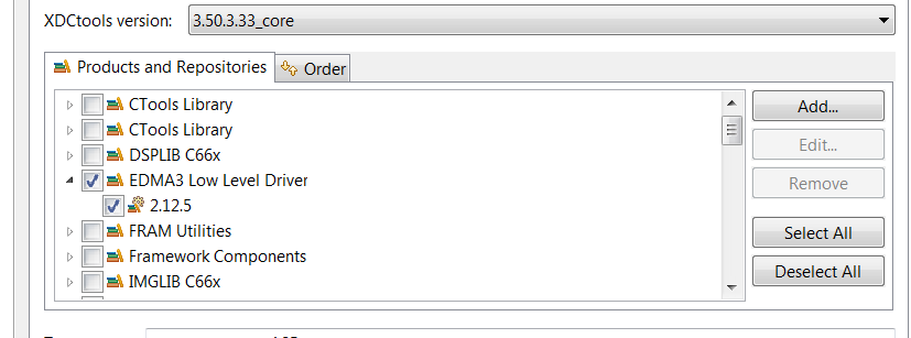

we are experiencing problems with the example project "MMCSD_FatfsConsole_bbbAM335x_DMA_armExampleProject"
as included in PDK for AM335x 1.0.9. Building it after importing into CCS isn't possible as we get an Error regarding
missing EDMA Library ("ti.sdo.edma3.drv.sample"). Manually including this Library via the project settings (Adding EDMA3 Low Level Driver 2.12.5) as Product)
fixes this but serves us with another error:
'hwAttrsConfig' undeclared (first use in this function) main_fatfs_console.c"
It might very well be that we are missing something or having a toolchain misconfiguration. Nevertheless we couldn't find any documentation regarding mentioned
Struct (which should be MMCSD_v1_HwAttrs).
Thank you in advance.
  • The RTOS team have been notified. They will respond here.

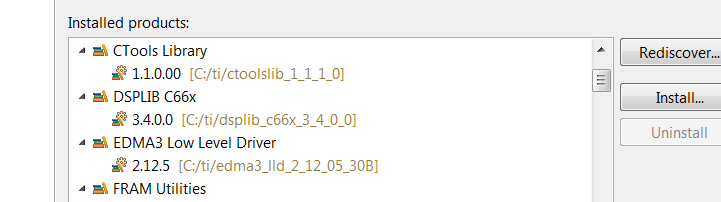

    The AM335x PDK 1.0.9 required EDMA_VERSION=2.12.05.30B. Do you have that installed and detected by CCS as a RTSC component?
    If not, please run the CCS Window---->preferences---->Code Composer Studio----->product to re-discover this RTSC package.
    Then, in the CCS project, do you have EDMA selected?
    The build process worked for me:
