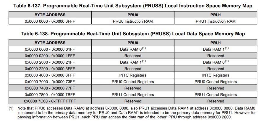

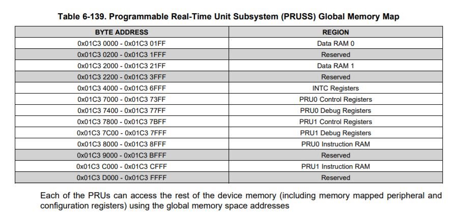

I'm trying to load a simple program on the PRU0 of my TMS320C6748. But my problem is that I can't find an adapted linker file for this PRU and also the GEL file associated.
I tried to use the memory map from the datasheet but my knowledge in linker is limited.
I don't know if I should use the local memory map or the global memory map for my linker file.
