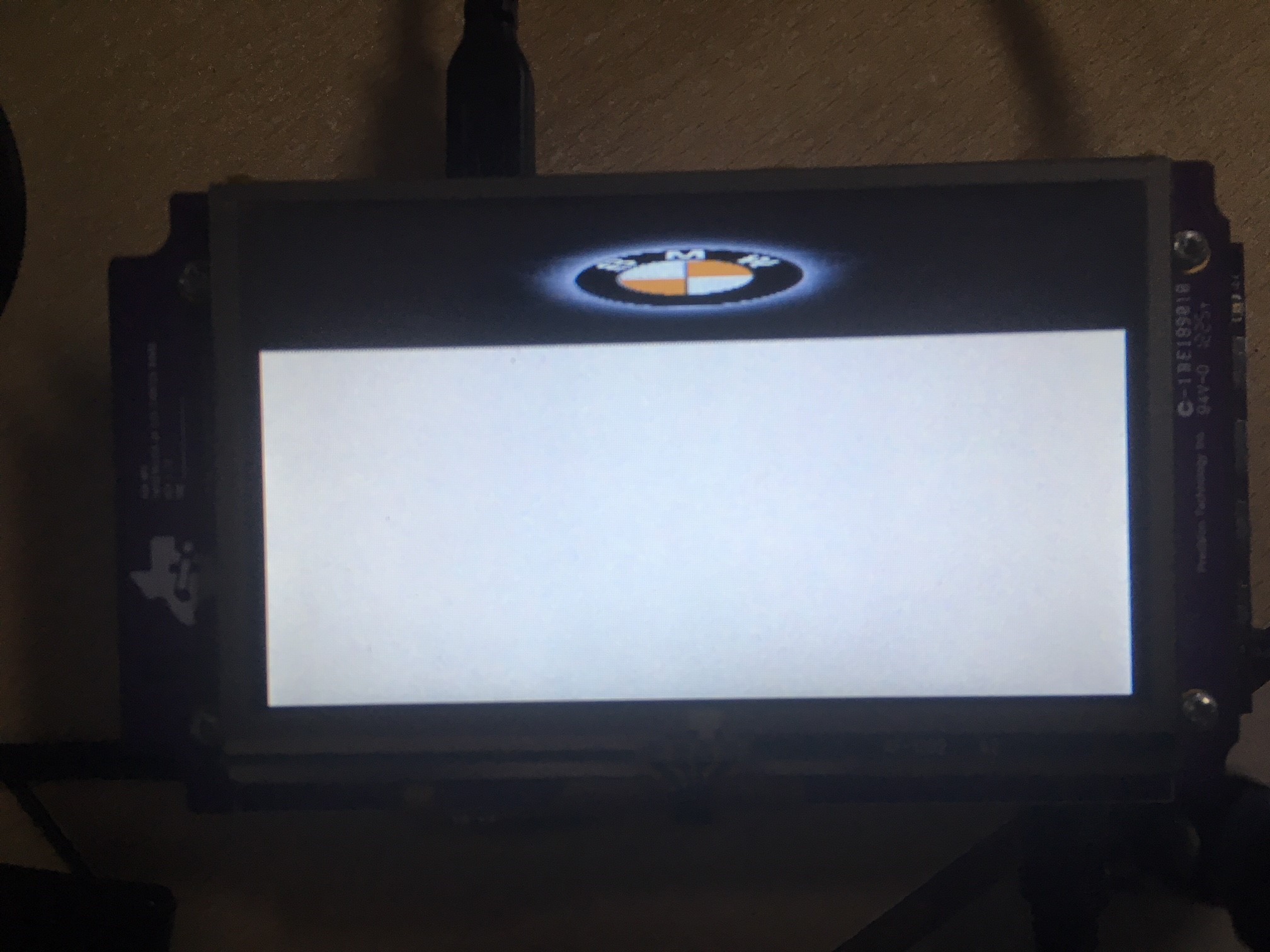

Hi, this method is failed to display 1280x800 pixels.
please let me know what could be the issue.

    1. i am trying to add this patch in u-boot-2017.01.
       but i din't have "arch/arm/cpu/armv7/am33xx/clock_am33xx.c"
    so  i added &cmper->lcdclkctrl, &cmper->lcdcclkstctrl
    to u32 *const clk_modules_explicit_en[] in arch/arm/mach-omap2/am33xx/clock_am33xx.c
    2.i am getting below error:
    common/lcd_console.c: In function 'console_newline':
    common/lcd_console.c:106:19: error: 'CONFIG_CONSOLE_SCROLL_LINES' undeclared (first use in this function)
    const int rows = CONFIG_CONSOLE_SCROLL_LINES;
    added #define CONFIG_CONSOLE_SCROLL_LINES 10 in am335x_evm.h

    4. i am using TMDXEVM3358-SK-LCD board and 480x272 16 bpp splash image. but image is displaying like below.
  • Can you check if this post will help you? It is a fresh new post with all the complete step by step configurations for AM437x platform.
