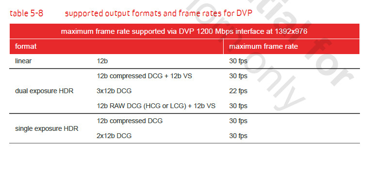

Please see OV9716 image output format as following, Please confirm TDA2P ISP support following image format : Daul Exposure HDR(12 bit compressed DCG +12 bit VS), 30fps ?

12bDCG + 12b VS format is not natively supported by ISP. However, our 3P (MMS) has developed an EVE based pre-processing algorithm which can convert this to ISP friendly format. This algorithm preserves full dynamic range (upto 120 dB).
