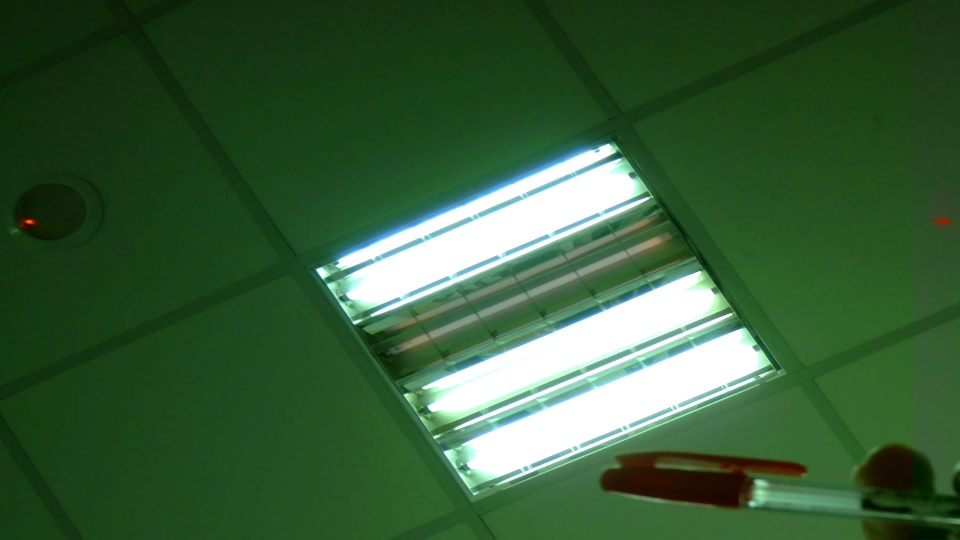

Hi TI Expert,
As I know the swms can support input resolution to 2047x2047. I have an input resolution 2032x1524 feed to swms and scale output to 1080p, but the output image have some problem at uv filed. It seems a bug in m3vpss because of y value is correct. Attached file is the swms output image. the uv is wrong when width more than 1920. I am using ipnc rdk to develop our project. Thanks for your help.
