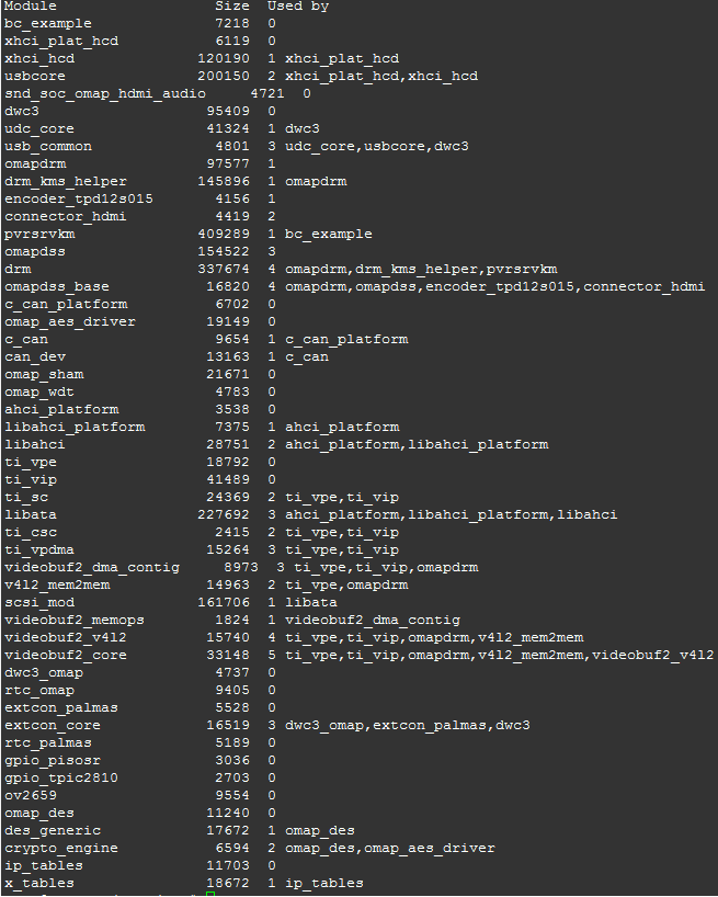

I was trying to install Xorg compatible GPU driver on my Sitara AM5728 IDK. I came to know that there is a GPU driver source file in a folder "ti-sgx-ddk-km-1.14.3699939", which comes with the TI SDK for Sitara AM57xx SoC. I have managed to compile the source and this process produced two kernel modules file "bc_example.ko and pvrsrvkm.ko" as an output. I have loaded these kernel modules, as you may see in the lsmod snapshot below
My questions are as follows:
1) Will TI provided GPU driver sources produce only two kernel modules files as mentioned above or Will it also produce some additional files too? If it produce additional files, then what are those files and how can they be obtained?
2)  There is also http://processors.wiki.ti.com/index.php/Graphics_SDK_Quick_installation_and_user_guide#Xorg_build which is a complete Graphic SDK provided by TI. However, it seems that this is not compatible to AM5728 SoC. Could you send me the link of such Graphic SDK for AM5728 IDK?
3) If these two kernel modules are the only driver files needed, then how can I configure Xorg to use this driver?
Look forward to receiving your response.

  • Hi, Farrukh:
    TI does not support Graphics SDK anymore, instead, all graphics related modules are included at the PSDK Linux distribution. The graphics release consists of a DDK Kernel Module (KM) source package and a DDK User-mode Module (UM) binary-only package.
    There are three EGL window system (WSEGL) supported by the DDK UM libraries.
    • libpvrDRMWSEGL.so (for VSync synchronised writes to DRM Framebuffer - slower, but avoids tearing) (for eglfs)
    • libpvrGBMWSEGL.so (for eglfs_kms)
    • libpvrws_WAYLAND.so (for wayland-egl)
    The window system will be dynamically loaded by DDK based on the application use case, so that the PVR configuration parameter WindowSystem at the PVR configuration file /etc/powervr.ini is optional.
    As you may notice that the graphics DDK no longer supports X11. Please refer to "software-dl.ti.com/.../Foundational_Components.html details.
    If  your application is based on QT5 then it should be able to run on top of any QT QPA (platform) supported by the underneath EGL components.
    • wayland-egl (default)
    • eglfs (-platform eglfs)
    Attached please find the DDK UM package for your reference.
    Eric
    sgx_ddk_um.tar.gz

  • Hi Eric,
    I hope that you are doing fine. Could you please have a look at the log in below and suggest an appropriate solution? we have tried till here by creating a symlink omapdrm_dri.so to gbm_pvr.so and we still have the issue.
    1) May I know, did you do some customisation in weston src in order to make use of gpu driver?

    MESA-LOADER: failed to retrieve device information
    gbm: failed to open any driver (search paths /usr/lib/arm-linux-gnueabihf/dri:${ORIGIN}/dri:/usr/lib/dri)
    gbm: Last dlopen error: /usr/lib/dri/omapdrm_dri.so: cannot open shared object file: No such file or directory
    failed to load driver: omapdrm

    [05:42:14.805] GL version: OpenGL ES 3.0 Mesa 13.0.6
    [05:42:14.805] GLSL version: OpenGL ES GLSL ES 3.00
    [05:42:14.805] GL vendor: VMware, Inc.
    [05:42:14.805] GL renderer: Gallium 0.4 on llvmpipe (LLVM 3.9, 128 bits)
