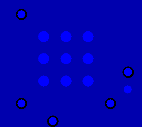

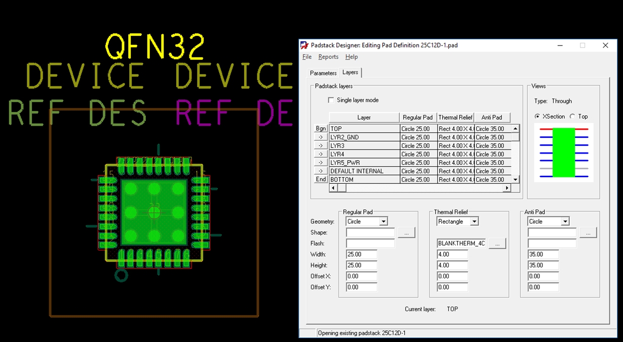

I have noticed that some padstacks contain a termal relief flash archive. Here I have attached a screenshot so you understand what I mean:
As you can see, there is a file in the flash field of the thermal relief called "BLANKTHERM_4C". However, a rectangle is selected in the geometry field. I assume there is something wrong with this. In any case, when I export the libraries of the .brd archive I get no file called "BLANKTHERM_4C" and therefore I can't recreate the footprint.

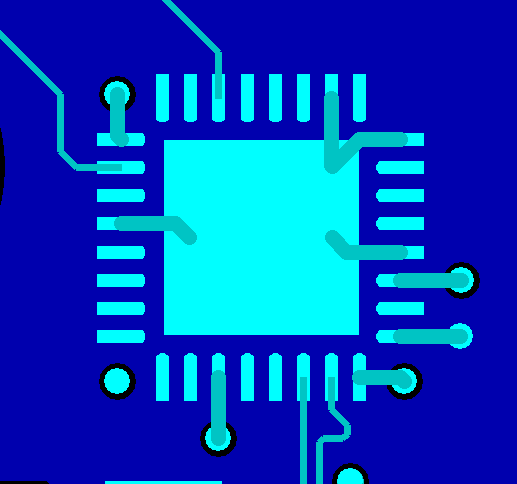

My concern is that the footprint may be wrong. However, I have used several gerber viewers to examine the gerber files of the board and none of them shows any thermal relief shape in those pads.
So my questions are:
-Do the padstacks actually have a thermal relief?
-If so, why doesn't it show in the gerber files?
-Can I find those flash archives somewhere to correctly reconfigure the footprints?
