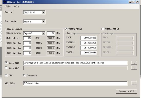

     I have SEED-OMAP L137 board , and the omap L137 's ROM ID is D800K001,it boot from 8bits nandflash.Now, I designed a new board ,It's ROM ID is D800K003, I download Aisgen for D800K003,but the board doesn't work,there is no message from UART2. My new board pass all the test under CCS3.3(NAND,SDRAM etc).Could somebody tell me , why?Is there anything new about D800K003? Hardware has no error.

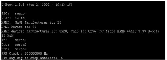

    I download uboot to SEED-OMAPL137(ROM ID is D800K001) like this(refer to the seed Manual);
    1.compile uboot , get u-boot.bin under linux.
    2.use raw2coff under AisGEN for D800K001 to convert u-boot.bin. command line is: raw2coff u-boot.out 0xc10800000 u-boot.bin
    3. then,open AISgen for D800K001,conver .out to .bin
    4.Last, open nandwriter ,download the uboot.
    5.power on the board again, uart2 send start message.

     now my board's omapl137,its ROM ID is D800K003, How will I do?By the way ,I saw many documents said that , flash dspubl,armubl and uboot, but the SEED omapL137 only flash the uboot, is it OK?
