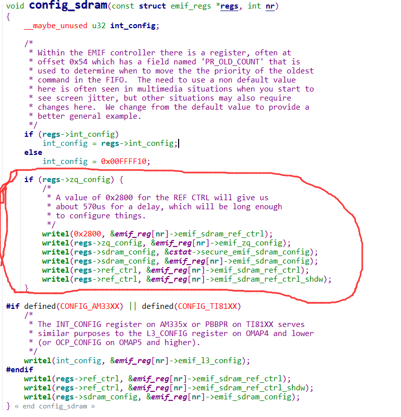

I want to know why there will be 570us for a delay after white 0x2800 to REF CTRL.
I can't understand the reason even if I read the 《TRM》.

  • This is a very old SDK, which has been obsoleted by TI and is no longer maintained or supported. Anyway, the reason for this delay is as follows:
    Initialize SDRAM_REF_CTRL with reset delay value before writing to SDRAM_CONFIG (DDR3 only):
    The value in SDRAM _REF_CTRL controls the delay time between the initial rising edge of DDR_RESETn to rising edge of DDR_CKE (JEDEC specs this as 500us). In order to achieve this, SDRAM_REF_CTRL should be written with a value of 0x3100 before writing to SDRAM_CONFIG (which initiates a DDR initialization. During first DDR initialization, the sequence should be:
    Configure all other EMIF registers
    Write SDRAM_REF_CTRL = 0x3100
    Write SDRAM_CONFIG with appropriate value
    Write SDRAM_REF_CTRL with refresh rate value for normal operation
    The value of 0x3100 is derived from the following formula:
    (16*SDRAM_REF_CTRL)/400MHz > 500us
    Note this value can change based on DDR frequency supported and is only needed for DDR3.

  • Very thanks,and about "(16*SDRAM_REF_CTRL)/400MHz > 500us",I could not understand why SDRAM_REF_CTRL is multiplied by 16?
    because form 《TRM》
    SDRAM refresh rate = EMIF rate / reg_refresh_rate where EMIF rate
    is equal to DDR clock rate.
    so the delay time would be SDRAM_REF_CTRL/400MHz > 500us?
  • This is the formula used for calculating the register value needed for the delay. There is no additional information.
