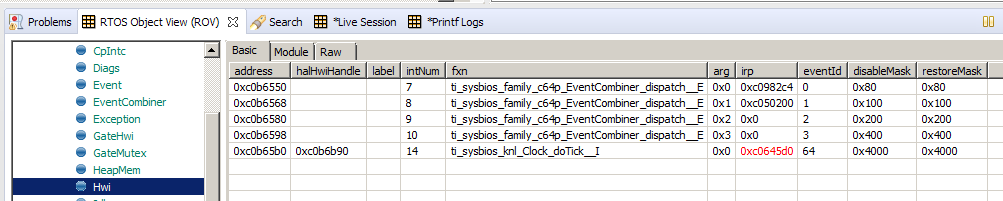

MSIs are routed through EventCombiner, relevant piece of config looks as:
EventCombiner.eventGroupHwiNum[0] = 7;
EventCombiner.eventGroupHwiNum[1] = 8;
EventCombiner.eventGroupHwiNum[2] = 9;
EventCombiner.eventGroupHwiNum[3] = 10;
EventCombiner.events[17].fxn    = '&pcie_isr';
EventCombiner.events[17].arg    = 0;
EventCombiner.events[17].unmask = false;
EventCombiner.events[18].fxn    = '&pcie_isr';
EventCombiner.events[18].arg    = 4;
EventCombiner.events[18].unmask = false;

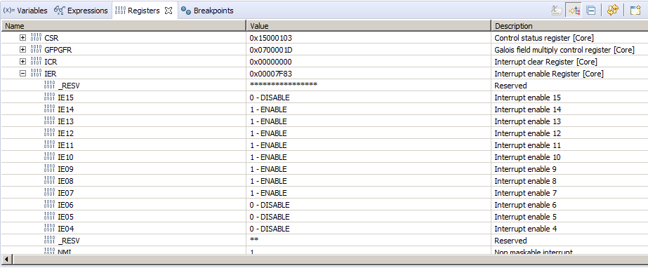

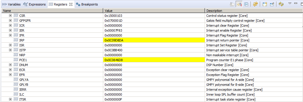

They both get enabled in runtime and operational for sure. The point is that MSI vector 16 stops triggering after certain activity. I have checked what looks relevant to me:
Still I could not find what could be a reason for MSI ISR to be not triggered.
Please advise what else should I check.
