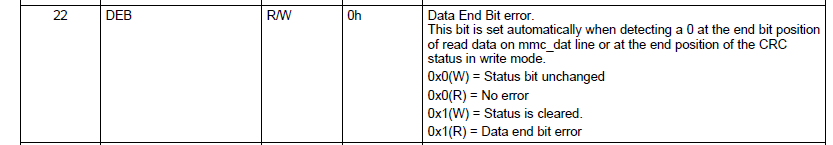

We have beagle bone black based custom board with 256MB RAM and 4GB eMMC.
We are trying to port U-Boot from version 2013 to 2017.01.
U-Boot code is changed lot between those version to I had to start porting from start.
I took am335x-evm reference and started porting.
I could get to a point where I can boot till u-boot prompt. however I am not able to get eMMC working.
Below is device tree entry
vmmcsd_fixed: fixedregulator@0 {
		compatible = "regulator-fixed";
		regulator-name = "vmmcsd_fixed";
		regulator-min-microvolt = <3300000>;
		regulator-max-microvolt = <3300000>;
		regulator-boot-on;
&mmc2 {
	vmmc-supply = <&vmmcsd_fixed>;
	pinctrl-names = "default";
	pinctrl-0 = <&emmc_pins>;
	bus-width = <8>;
	status = "okay";
I see omap SD/MMC 0 listed but I am not able to get it working.

    It seems REF3 above is the place where omap_hsmmc_send_cmd() function of  omap_hsmmc.c is returning error.
    I looked up technical reference manual and it seems SD_STAT has DEB(bit 22, Data End bit Error) set to 1 , so Data end bit error.
    Any suggestion how to get around this error
