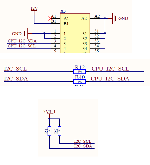

I have an camera board connected to AM5728 based EVM board, (BEAGLEBOARD_X15)
And connected the I2C camera (MT9V024) on I2C5 interface on my custom board and getting the below i2c errors while I am doing i2cdetect.
omap_i2c 4807c000.i2c: timeout waiting for bus ready
What could be the reason for this ?
BTW, we have connected 30Ohms series resistors on I2C lines, it could affect anything ?
I probed the I2C signals, seems SCL is low and SDL is in HIGH.
Seems, slave is pulling SCL to LOW ?? if yes, what could be reason for this ? attached the my i2c5 portion of schematics.\

    I referred the reference schematics, that didn't help to debug my issue, it doesn't have any series resistors on I2C lines, is that makes any difference ?

    R1 & R2 are 4.7K resistors and R12 & R40 are 30Ohm resistors.
    Q1) BTW, we have connected 30Ohms series resistors on I2C lines, it could affect anything ?
    Q2) Seems, slave is pulling SCL to LOW ?? if yes, what could be reason for this ? attached the my i2c5 portion of schematics.

  • Serial resistors are not needed on I2C lines. How did you check if the slave is pulling SCL low? Did you see the same issue without your camera board?

    So it looks like the add-on board is indeed halting the I2C.
  • Thanks Biser, shared my camera schematics via chat, can you please have look and shed some lights on this.
    Thanks for the help.
    I looked at it. I don't see anything on the hardware side that could be causing this. However there are some things you need to check on the software side. The Processor SDK default configuration runs on the AM572x GP EVM, which has several peripherals attached to I2C5 - LCD board EEPROM, Touchscreen controller, COM8 expansion connector. You will need to remove all these from the device tree.
