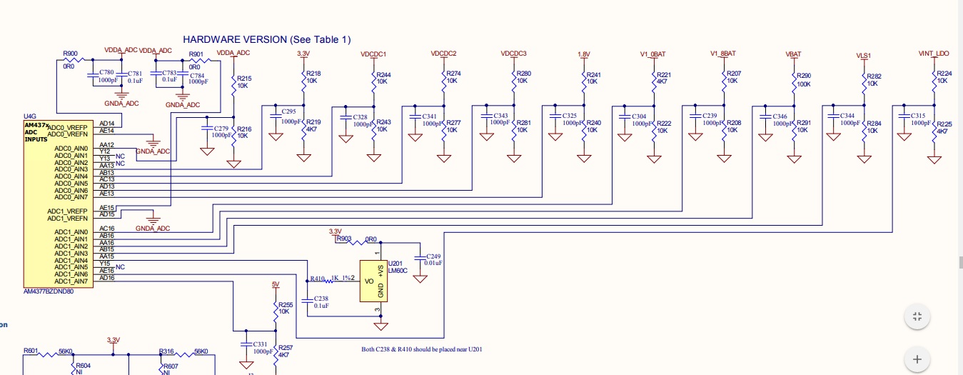

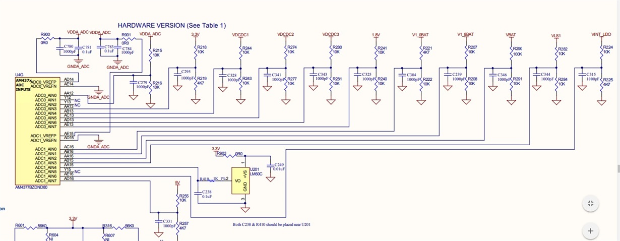

We are using AM4377 processor analog channels in one of our projects. While reading the value of a temperature sensor, we have observed some mismatch between the temperature used & read value. Then, we have isolated the sensor from processor(found temperature sensor output is proper) and found 1.8V always on the processor side. We could not see any information such as internal pull ups on ADC in datasheet or reference manual. What could be the reason for this 1.8V found on ADC channel ? and after disabling ADC also we could see 0.890V.We would like to know the reason for that also.
Complete part no of the processor used: AM4377BZDND80
Appreciate your quick response.
    What software are you using? Which version? How is the ADC configured?
  • Hi Biser,
    we are  using  ti-linux-sdk-4.00.00.04, Linux Kernel 4.9.28+ (2017 LTS). we have backported ADC1 driver made for v3.2.0.5, Here is the patch we have applied. We are getting a proper reading on other channels.

  • Hi Sir,
    Here, I have attached my Schematics and that GNDA_ADC and other ground is connected through 0 Ohm. So, Both the grounds are same. We are feeling that sink current for ADC is not sufficient-For that can I try with some pull up at the ADC pin. Is that ok to connect pull up in ADC pin of AM437x.
  • I do not understand why you feel like you need to have a pull-up for the LM60C. If you look at the schematic provided in Figure 6 of the LM60C data sheet, there is a current source that pushes current through Q7 to the output. Therefore, the output should not require an external pull-up.
    I may understand your problem after downloading the LM60C data sheet and reviewed its electrical parameters. The 10mA value you referenced in previous replies is an absolute maximum value. This parameter is simply telling the user they must never connect the output to anything that would draw more than 10mA. There is another parameter that defines a maximum output impedance of 800 ohms. This is the parameter that is important when understanding its capabilities to drive a load.
    You also inserted a low pass filter between the LM60C and ADC input that needs to be considered.
    The combined output impedance of the low pass filter and LM60C must be able to source enough current to charge the ADC input capacitance (5.5pF) to an acceptable voltage that represents the desired accuracy of the ADC during the acquisition period.
    The ADC acquisition period is defined by the Sample Delay. Sample Delay defaults to a value of zero which causes the acquisition period to be equal to two adc_clk clock periods. The acquisition period can be extended one adc_clk clock for each incremental value of Sample Delay. When the AFE preamplifiers are bypassed, the value of Sample Delay should be configured to provide enough time for the respective external voltage source to completely charge the AFE input capacitance during the acquisition period.
    The LM60C data sheet recommends connecting a 1uF capacitor directly to its output to create a low pass filter. The recommended circuit topology would provide a lower impedance source to the ADC input and may resolve your issue. You may also consider increasing the value of Sample Delay in the step performing this acquisition to see if it helps without changing your low pass filter.
    Paul
  • Hi ,
    We have tried the above suggestions and the result is 1.02V at ADC input. Is there any other reason for such a scenario?
    E.Rohini
  • I'm running out of suggestions.
    When you say, "the result is 1.02V at ADC input".  Is this the voltage measured by the ADC or is this voltage being measured by external instrumentation?
    What does this input and the ADC voltage reference pins (both VREFP and VREFN) measure using external instrumentation?
    Paul

    One more test case result,
    We used 0 Ohm at R410 and 4.7K ohm at C238. Implicitly, we tried to reduce the load at ADC input. With that test case we got nearly 580mV.
    So, may I know what could be the reason?
    Thanks & Regards,
    E.Rohini.

    In your case it sounds like the LM60's output is not being correctly loaded to the ADC.
    1) Have you used a voltage source instead of the LM60 at 0.6 V to emulate the sensor? If you observe the correct reading for the ADC using the voltage source, then the ADC is probably not the problem.
    2) If the ADC works properly, then the output impedance of the LM60 could be a potential issue; it is 800 ohms. One way you could solve this is to use an output capacitor at the sensor that is much larger than the ADC's sampling cap (0.1 uF would be plenty). When you test this, do not use another series resistor because this will increase the source impedance (which you do not want to do).
    Please try this solution to see if you get the results you are looking for.
    Audrey
  • Hi Audrey,
    1. Yes, we have tried with some voltage source nearly equal to 0.6V. Using ADC we could read that voltage properly.
    2. This case we tried with 0 Ohm series resistor at R410 and 0.1uF at C238 & also 0 Ohm at R410 and 1uF at C238. We got 1.02V (both measured and read value are same)
    After trying above 2 things, we have tried with 0 Ohm at R410 and 4.7K at C238. With this configuration, we are finding the expected voltages at different temperatures (as per LM60 behavior). Is this because of the processor internal bias resistor & bias voltage effect?
    Thanks & Regards,
    Rohini
  • Hi Rohini,
    I understand. At this time, I cannot comment deeply on the ADC side as to whether or not the bias resistor/voltage is affecting the measurement. However, I can comment on the LM60 side. Are you confident that the sensor is in fact at room temperature (0.6 V)? Could there be another nearby component which may be heating up the sensor?
    Audrey
  • Try removing C238 and R410 from your board and use a meter to measure the potential on the ADC input without the LM60C connected.  This should be a good indicator if the ADC is sourcing any leakage current into the LM60C when connected.
    Paul
  • Hi Audrey,
    We have connected 0.6V to ADC pins not connected directly from source. We have used one voltage divider and then fed that to ADC1_AIN4 to convert our source to 0.6V(for testing purpose)
    Thanks & Regards,
    E.Rohini
  • Hi Paul,
    Yes, we measured the voltage at ADC-AIN4 by isolating from other circuits. It was showing 1.78V.
    Thanks & Regards,
    E.Rohini

  • I have been working with our analog design team trying to understand why you measured an open-circuit voltage of 1.78 volts. They ran simulations and found unexpected leakage paths to VDDA in the preamp. I was told the leakage could be as high as 10uA. Normally this small leakage current would not create significant measurement error when connected to low impedance sources capable of sinking current to maintain their expected output voltage, but the LM60C is only designed to source current.
    Adding the 4.7K pull-down has improved your measurement accuracy because the leakage current through the load is much smaller than the total current through the load. However, the additional leakage current from the ADC is still creating a small error since the LM60C is not expecting any external current source.
    Your current circuit topology of connecting LM60C to the ADC may never provide the desired temperature accuracy without inserting a high input impedance voltage follower buffer circuit similar to the one shown in the following URL.
