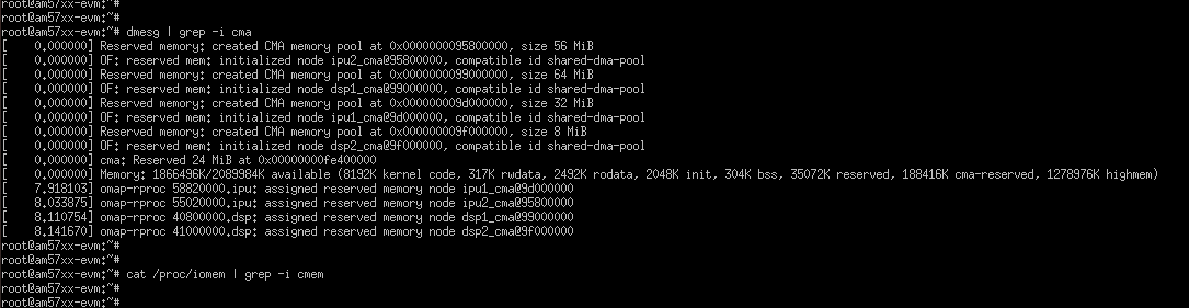

When running the Big Data IPC example, I get this CMEM error:
After a little troubleshooting, it looks as though my /proc/cmem file is empty even though the cmemk module appears to have loaded OK.
So I'm trying to figure out what is the root cause.   This is just using the prebuilt binaries from version 4.3 of the Processor Linux SDK.
Any thoughts or recommendations would be much appreciated.
Dermot
  • I should also note that dmesg reports CMA pools being created for different cores but /proc/iomem doesn't show any CMEM allocation:
    Thanks for your help,
    Dermot

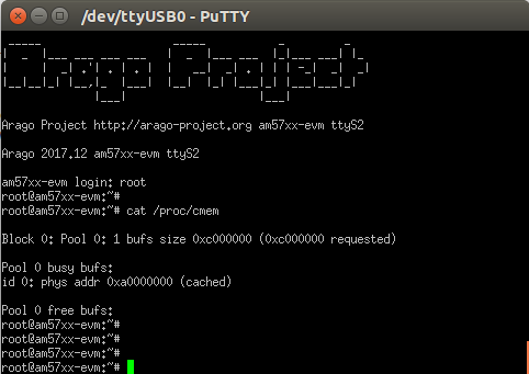

  • Hi Rex,
    Thanks for your reply. I'm using the SDK 4.3 pre-built images only. I create an SD card using the create-sdcard.sh script with two partitions, one for boot (containing MLO, uEnv.txt and u-boot.img) and one for root (containing the rootfs).
    Even without attempting to run the Big Data IPC demo, I think my problem is the empty /proc/cmem. Does this get populated by the cmemk module when it loads? I tried unloading and reloading with insmod but I just used the sample parameters provided at processors.wiki.ti.com/.../CMEM_Overview however phys_start and phys_end get reported as unknown parameters. Where might I find the parameters used to load it from the rootfs? I presume it gets loaded somewhere but I'm having trouble finding where.
    Dermot

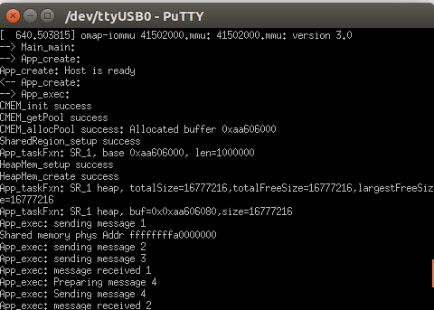

  • Hi, Dermot,
    I think the issue is not CMEM, but OpenCL is running in the background. By default, OpenCL ti-mctd daemon is running when system boots up. Please follow the instruction in processors.wiki.ti.com/.../Processor_SDK_Big_Data_IPC_Examples to disable the ti-mctd. You will need to start lad server. It should work for you.
    I re-created the SD card using 4.3 release and here are the logs from running the example.
    am57xx-evm login: root
    root@am57xx-evm:~# ps aux | grep mctd
    root 462 0.0 0.0 201192 704 ? Ss 15:23 0:00 /usr/bin/ti-mctd
    root 1113 0.0 0.0 1960 1184 ttyS2 S+ 15:24 0:00 grep mctd
    root@am57xx-evm:~# systemctl stop ti-mct-daemon.service

  • Hi, Dermot,
    Just noticed that my post this morning isn't shown in the thread for some reason. Let me recollect them.
    You don't need to rebuild the images. All binaries are included in the filesystem under /usr/bin/simple_buffer_example. Check my logs to see exact where they are located.
    Yes, I see content in /proc/cmem without killing ti-mctd daemon.

  • Well some good news at last!
    And consequently, the Big Data IPC application runs OK too:
    So I guess this is a bug with the X15 rev C device tree file.
    I'm going to go ahead and mark this thread as resolved.
