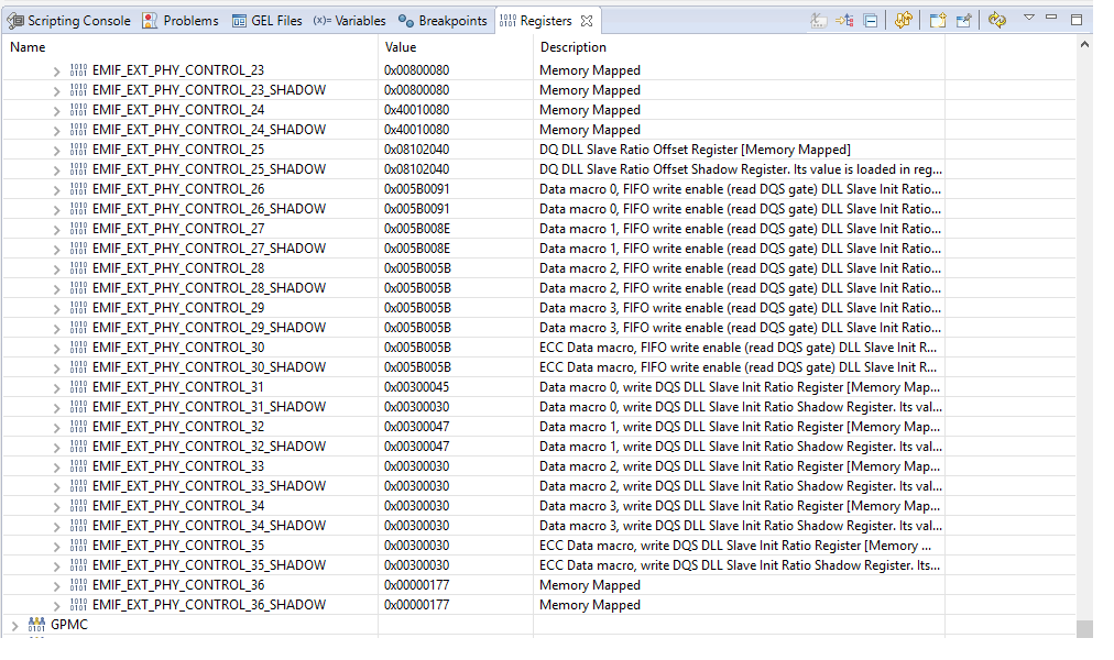

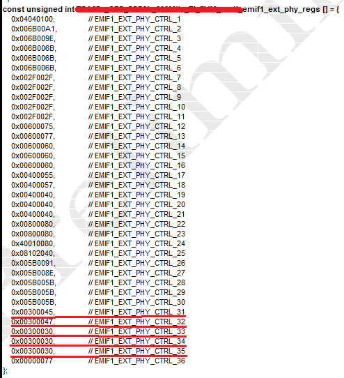

I'm experiencing issues with some boards that behaves different and I would like to discard that this random issue that I have is not related to write leveling.
After performing the write leveling, code composer generates a c file with some registers configured to zero and thats what concerns me as the spreeadsheet gives a totally different value (please see attached pictures).
Autogenerated c file:
Values generated by the spreadsheet:
Please, is there someone that had a similar problem that could help me?
