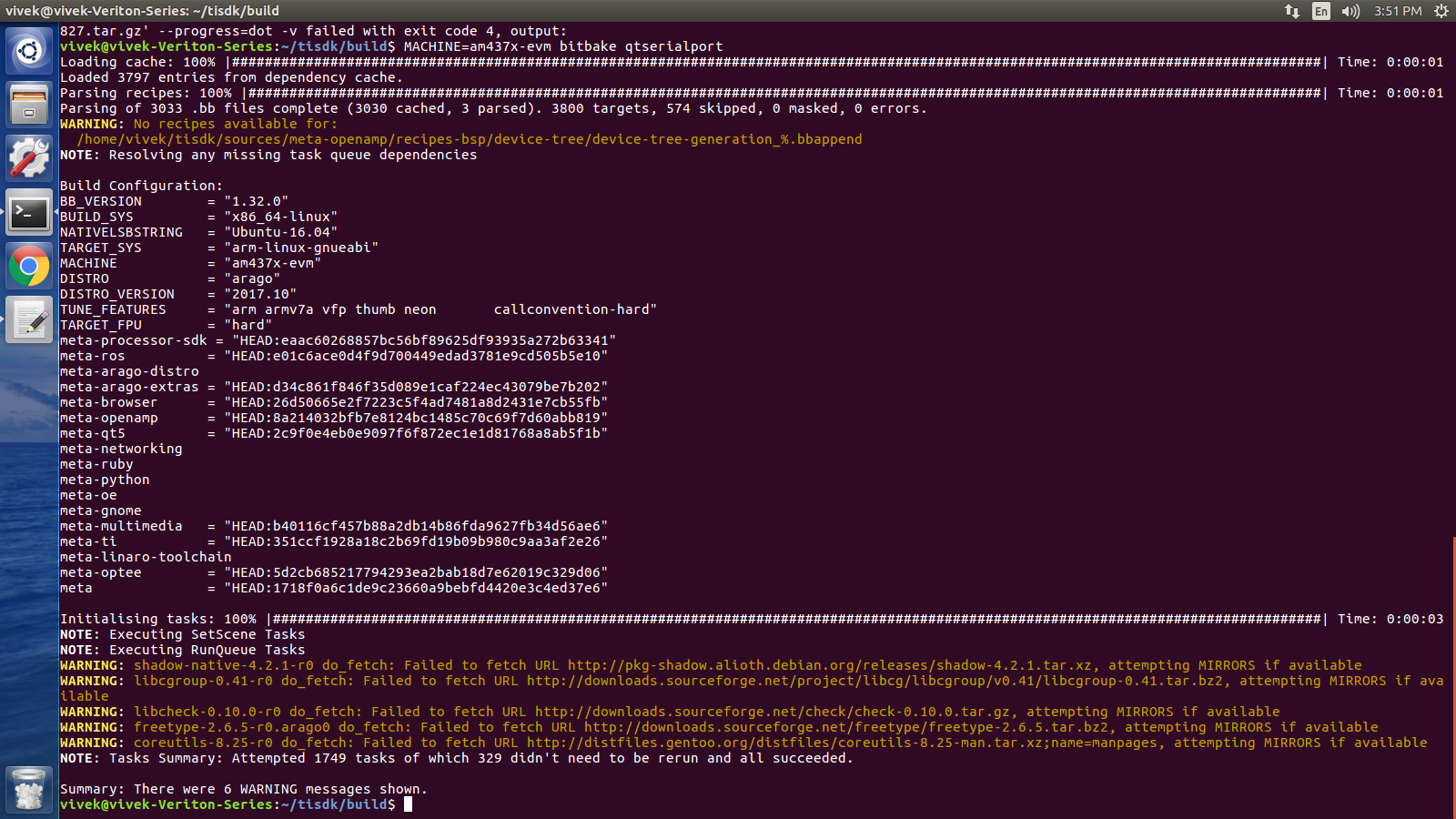

    I have done bitbake build for AM437x.  The end of the build process there is notification in NOTE
    NOTE: Tasks Summary: Attempted 1749 tasks of which 329 didn't need to be rerun and all succeeded"
    So is that problem?  am I need to re-run the bitbake build again
    Here I pasted the full build message

    NOTE: Tasks Summary: Attempted 1749 tasks of which 329 didn't need to be rerun and all succeeded.
    Summary: There were 6 WARNING messages shown.
    Please confirm me is my buld is OK to proceed the next steps ?
    Vivek
  • The building is successfully completed. You can continue to follow the steps of the original post.
