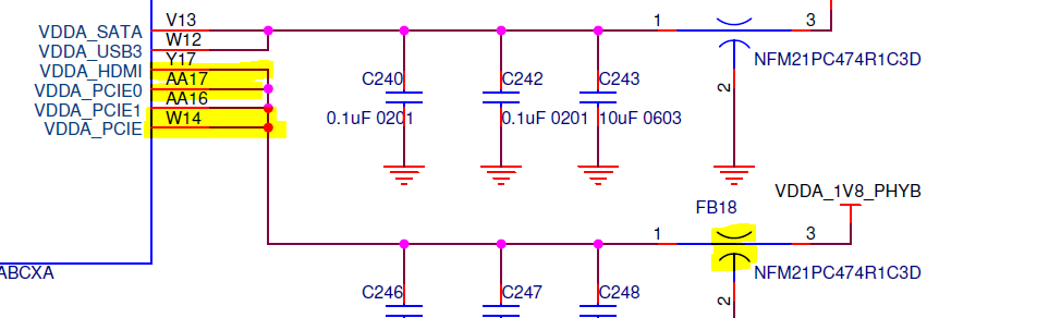

We are facing issue of stuck  starting Kernel. it is not consistence of all board.  35% boards are facing stuck at staring Kernel and 65% board successfully boot and working fine.
We have verified u-boot successfully handover to Kernel but kernel entry point is somewhere stuck and didn’t see any print message on console after load the Kernel

  • Hello Mahesh,
    You should first find out which hardware part of these 35% boards differs from the other 65% boards.
    Kemal
  • There is no hardware difference between working and non-working board, all of these are made from same batch of fabrication and assembly.
  • Can you enable low-level debugging and see if there are any additional printk? From make menuconfig, select Kernel hacking, then select Kernel low-level debugging functions (read help!). Then select your Kernel low-level debugging port.
    Steve K.
  • I have done with enabled low-level debug function but nothing to print on console when start the kernel.
  • By disabled the PICE interfacing in dts then board is booting up. do you have any idea what was the reason to if disable PCIE interfacing tnen device is booting up.

    On U-boot prompt I am seeing below message which I am NOT seeing in any board except this one.
    SCSI: omap_pipe3_wait_lock: DPLL failed to lock
  • Hi Steve -
    Thanks for the support on this. I wanted to pass along some additional information from Mahesh's troubleshooting:
    By disabled the PICE interfacing in dts then board is booting up. Following highlighted changes made in dra7.dtsi. do you have any idea what was the reason to if disable PCIE interfacing and device is booting up.
    These changes are suggested by TI to enable PCI interface for WiFi edgewater modules.
    axi@0 { compatible = "simple-bus"; #size-cells = <1>; #address-cells = <1>; ranges = <0x51000000 0x51000000 0x3000 0x0 0x20000000 0x10000000>; /** * To enable PCI endpoint mode, disable the pcie1_rc * node and enable pcie1_ep mode. */ pcie1_rc: pcie_rc@51000000 { compatible = "ti,dra7-pcie"; reg = <0x51000000 0x2000>, <0x51002000 0x14c>, <0x1000 0x2000>; reg-names = "rc_dbics", "ti_conf", "config"; interrupts = <0 232 0x4>, <0 233 0x4>; #address-cells = <3>; #size-cells = <2>; device_type = "pci"; ranges = <0x81000000 0 0 0x03000 0 0x00010000 0x82000000 0 0x20013000 0x13000 0 0xffed000>; #interrupt-cells = <1>; num-lanes = <1>; linux,pci-domain = <0>; ti,hwmods = "pcie1"; phys = <&pcie1_phy>; phy-names = "pcie-phy0"; interrupt-map-mask = <0 0 0 7>; interrupt-map = <0 0 0 1 &pcie1_intc 1>, <0 0 0 2 &pcie1_intc 2>, <0 0 0 3 &pcie1_intc 3>, <0 0 0 4 &pcie1_intc 4>; status = "disabled"; pcie1_intc: interrupt-controller { interrupt-controller; #address-cells = <0>; #interrupt-cells = <1>; }; }; pcie1_ep: pcie_ep@51000000 { compatible = "ti,dra7-pcie-ep"; reg = <0x51000000 0x28>, <0x51002000 0x14c>, <0x51001000 0x28>, <0x1000 0x10000000>; reg-names = "ep_dbics", "ti_conf", "ep_dbics2", "addr_space"; interrupts = <0 232 0x4>; num-lanes = <1>; num-ib-windows = <4>; num-ob-windows = <16>; ti,hwmods = "pcie1"; phys = <&pcie1_phy>; phy-names = "pcie-phy0"; syscon-legacy-mode = <&scm_conf1 0x14 2>; status = "disabled"; }; }; axi@1 { compatible = "simple-bus"; #size-cells = <1>; #address-cells = <1>; ranges = <0x51800000 0x51800000 0x3000 0x0 0x30000000 0x10000000>; /* status = "disabled"; */ status = "disabled"; pcie@51800000 { compatible = "ti,dra7-pcie"; reg = <0x51800000 0x2000>, <0x51802000 0x14c>, <0x1000 0x2000>; reg-names = "rc_dbics", "ti_conf", "config"; interrupts = <0 355 0x4>, <0 356 0x4>; #address-cells = <3>; #size-cells = <2>; device_type = "pci"; ranges = <0x81000000 0 0 0x03000 0 0x00010000 0x82000000 0 0x30013000 0x13000 0 0xffed000>; #interrupt-cells = <1>; num-lanes = <1>; linux,pci-domain = <1>; ti,hwmods = "pcie2"; phys = <&pcie2_phy>; phy-names = "pcie-phy0"; interrupt-map-mask = <0 0 0 7>; interrupt-map = <0 0 0 1 &pcie2_intc 1>, <0 0 0 2 &pcie2_intc 2>, <0 0 0 3 &pcie2_intc 3>, <0 0 0 4 &pcie2_intc 4>; pcie2_intc: interrupt-controller { interrupt-controller; #address-cells = <0>; #interrupt-cells = <1>; }; }; };
    Please let me know if you have any question doubt.
    Thank you!

  • Do all of the 35% of the bad boards print this:
    at U-Boot prompt? If so, this seems to be what needs to be tracked down.
    Do any of the good boards print this?
  • Not all, some of board have same error and some of board didn't getting this error on uboot prompt.

  • The error message you see is from SATA. Do your custom boards have SATA?
    Steve K.
  • Yes, It is coming from SATA on u-boot prompt and We don't used SATA on custom board.
  • Since you do not use SATA, can you disable it in include/configs/am57xx_evm.h? That should make the message go away.
    Steve K.
  • Yes I disabled SATA on uboot and this message go away on u-boot prompt.

    We had found that the processor was not getting proper voltages of VDDA_PCIE0/VDDA_PCIE1/VDDA_PCIEE(1.8V) for PCIe.
    It was an assembly issue as FB18 was not properly assembled on the board
