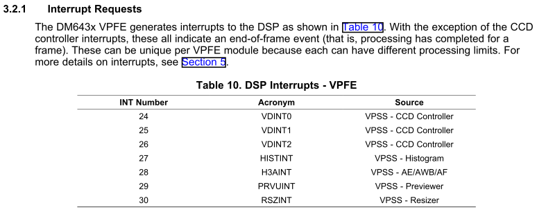

I would like to ask a question on hardware interrupt mapping in CCS 4.
First, how this is done in CCS 4? Do I need to modify .cmd (command) file?
And for Spectrum's EVM's, does any example program contain interrupt service routine configuration so that I can refer to?
Sincerely,
Zheng
    There might not be one for VPFE. but there is an example for GPIO. See intc_example.c in ths spectrum testcase package (search for it).
    There are some other ones, you can search for "csl_intcInit",  you should be able to find what you need.
