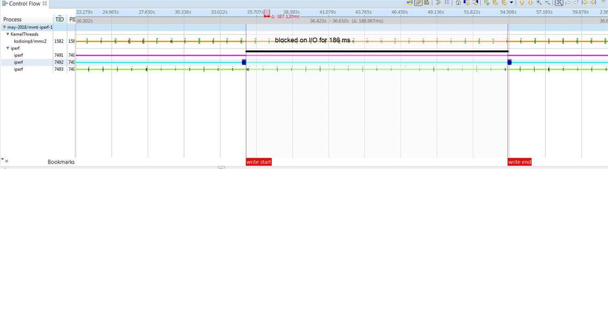

  • Hi Vishal,
    Yes ,We have taken kernel lttng traces and we found fallowing observation.
    1. Periodically the iperf write() takes more than 115ms time to transfer the data.
    2. During that time, the ksdioirqd daemon is blocked on something which delayed the completion of write() call.
    3. This kind of behavior is always happened after every 250ms to 300ms during transfer.
    4. Below trace shows write call is delayed 186ms due to IO block.
     Even after  applying your patch no improvement has been observed.
