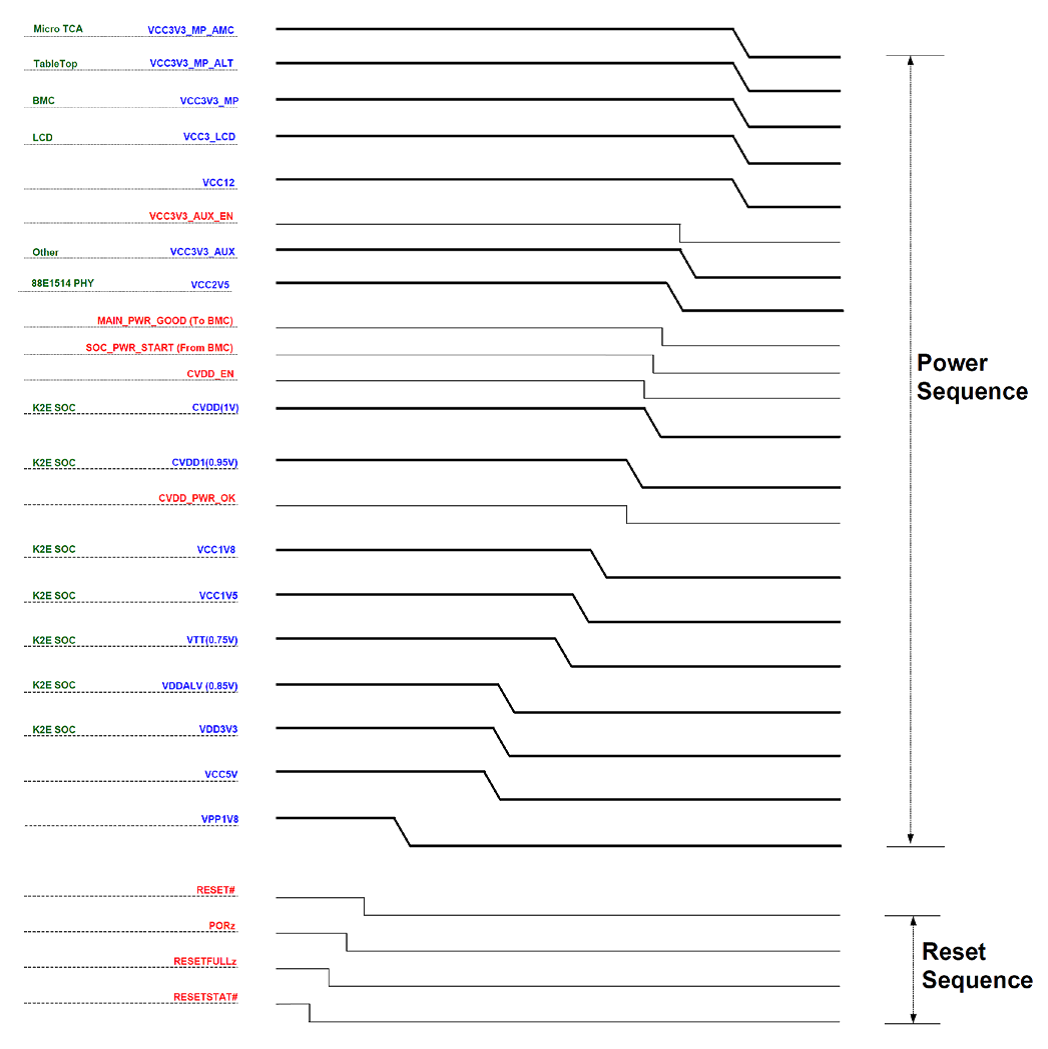

In order to try to understand this requirement we have looked at the EVMK2E evaluation board, since the processor used by this board has similar sequencing requirements shown in its datasheet.

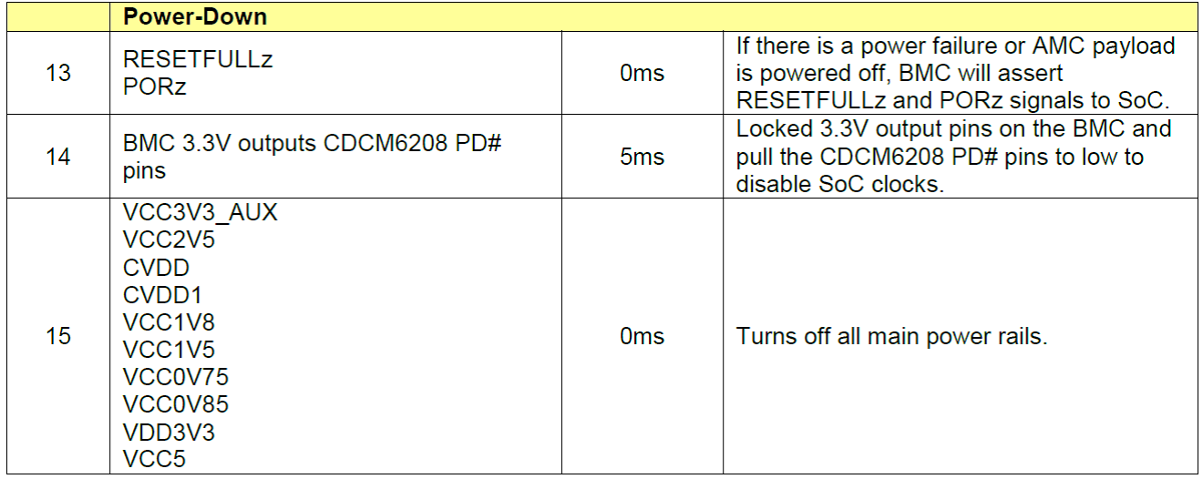

The manual for the evaluation board shows the following shutdown sequence timing settings and sequence:

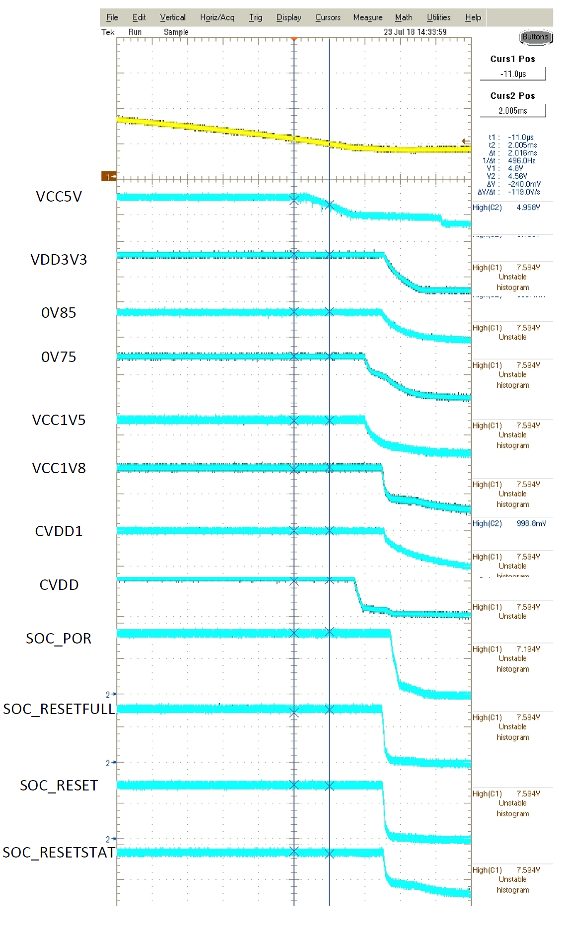

Measurements performed on the EVMK2E produced the following results:
It is apparent from the shutdown sequence timing settings shown in the EVMK2E manual that no attempt is made to shut down the supplies in an orderly fashion.
The shutdown sequence measured on our EVMK2E evaluation board does not appear to meet the requirements of the processor datasheet since the variable core supply voltage collapses first CVDD. (It also does not agree with that shown in the EVMK2E manual.)
The EVMK2E solution appears to be based on fast shutdown to prevent an excessive amount of static current and to prevent overstress of the device.

Is it acceptable during power down to turn off all AM5K2E0x supplies as quickly as possible, (as per the EVMK2E solution where the CVDD supply is turned off before all other rails have collapsed) or will this result in damage to the processor?
Question 5
Does the AM5K2E0x CVDD supply need to be provided with hold up to ensure that all other rails have collapsed before the core is depowered?

  •    team, I am posting the pictures he is talking about...

    Question 4 - The reverse sequence should be more closely followed with a controlled power down of the device as opposed to a collapse when power is removed from the system. We understand that creating a reverse order shutdown is difficult in that situation. Turning off the supplies as quickly as possible should be done when the main power is removed from the system. The goal is to avoid having one or two supplies present for long periods of time when the others are not present.
    Question 5 - As noted in the data manual, the K2E supports IO before core and core before IO sequencing. It is acceptable for the power up sequence to follow either. It is also acceptable for the power down sequence to follow either. I will check on this one but I don't see why the core couldn't be removed before the 1.8V even if you are following the core before IO ramp when powering the device.
