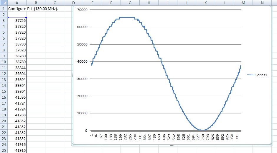

Dear Sir/Mam,
i have interfaced ADS8330 to tms320c5505..i am using both the channels..with auto mode with SPI clk 4MHz. following is the code to get the samples.inputs are 50Hz,1V sinewave.

The problem is i am getting following waveform which is not cleaned one.I need cleaned waveform because i going to find phase difference between two waves,.
and the channel data get swapped between two buffers when i use highest clock speed.
:ploted only 1024 points
