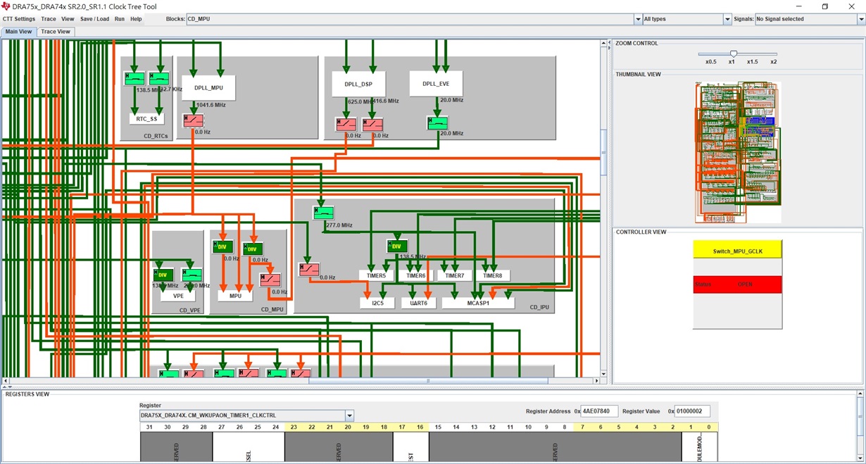

    And I use this tool to dump prcm register, save as .rd1 file
    Finally load this file into CTT, i can see the overall clock tree
    But I found a strange thing, my mpu and dsp is inactive(clock is not supply, red line)
    Is it possible? Or where i can double check whether they are active or not ?
    Thanks !
    Kenny

  • Hi Alex:
    Sorry for my late reply.
    I have already solved this "dsp is not active" problem.
    The dsp default firmware seems have auto suspend function(about 10s after boot)
    So I change the firmware link to another file(org: lib\firmware, change: lib\ipc ) and it works
    When i use "omapconf show opp" cmd to look dsp status, it is enabled(not have (1))
    Thank you for your remind.
    Kenny
