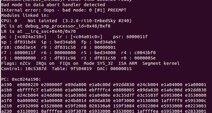

    Our equipment needs frequent interruptions,   I use the kernel version is 3.2.0,and I use the rt-patch version is patch-3.2-rt10.patch.
    Under these conditions:
            I test the Interrupt latency is about 10us to 60us. However, our equipment need the  minimum interrupt interval is about 90us.and the interrupt count is continuous up to 2200(I call this interrupt A) , during these interrupts ,sometimes we need to transmission data by net 、 serial port(I call this interrupt B).
            now ,I use gpio3 to deal the interrupt A.  if the program is dealing with the interrupt B, the interrupt A maybe lost. so I need to open the Interrupt Preemption function ,and set the interrupt A priority higher than interrupt B.
    I do some change in the kernel ,but I failured.

    it I use this program ,the kernel will boot failure.
    I use :
    irq_enable:
    asm volatile(
      " mrs %0, cpsr @ arch_local_irq_enable\n"
      " bic %0, %0, #128\n"
      " msr cpsr_c, %0"
      : "=r" (temp)
      : "memory", "cc");
    irq_disable:
    unsigned long temp;
     asm volatile(
      " mrs %0, cpsr @ arch_local_irq_disable\n"
      " orr %0, %0, #128\n"
      " msr cpsr_c, %0\n"
      : "=r" (temp)
      : "memory", "cc");
    my program only change cpsr register, not enter the system mode, because the kernel will boot failure.

    	//intc_context[0].threshold = readl_relaxed(base_addr + INTC_THRESHOLD);
    	//printk("rrr****intc_context[0].threshold = %d\r\n",intc_context[0].threshold);
    	/*intc_context[0].ilr[62] = readl_relaxed(base_addr + (0x100 + 0x4*62));
    	intc_context[0].ilr[63] = readl_relaxed(base_addr + (0x100 + 0x4*63));
    	intc_context[0].ilr[93] = readl_relaxed(base_addr + (0x100 + 0x4*93));
    	intc_context[0].ilr[94] = readl_relaxed(base_addr + (0x100 + 0x4*94));
    	intc_context[0].ilr[68] = readl_relaxed(base_addr + (0x100 + 0x4*68));
    	intc_context[0].ilr[72] = readl_relaxed(base_addr + (0x100 + 0x4*72));
    	intc_context[0].ilr[73] = readl_relaxed(base_addr + (0x100 + 0x4*73));*/
    	/*for (i = 0; i < INTCPS_NR_MIR_REGS; i++)
    		intc_context[0].mir[i] = readl_relaxed(base_addr + INTC_MIR0 + (0x20 * i));*/
    void omap_intc_restore_context(void)
    	int ind = 0, i = 0;
    	printk("&&&&&&&&&&&&&&&&&restore\r\n");
    	for (ind = 0; ind < ARRAY_SIZE(irq_banks); ind++) {
    		struct omap_irq_bank *bank = irq_banks + ind;
    		intc_bank_write_reg(intc_context[ind].sysconfig,
    					bank, INTC_SYSCONFIG);
    		intc_bank_write_reg(intc_context[ind].protection,
    					bank, INTC_PROTECTION);
    		intc_bank_write_reg(intc_context[ind].idle,
    					bank, INTC_IDLE);
    		intc_bank_write_reg(intc_context[ind].threshold,
    					bank, INTC_THRESHOLD);
    		for (i = 0; i < INTCPS_NR_IRQS; i++)
    			intc_bank_write_reg(intc_context[ind].ilr[i],
    				bank, (0x100 + 0x4*i));
    			intc_bank_write_reg(intc_context[ind].mir[i],
    				 &irq_banks[0], INTC_MIR0 + (0x20 * i));
    	/* MIRs are saved and restore with other PRCM registers */
    void omap_intc_restore_context_addr(void __iomem *base_addr)
    	writel(20, base_addr + INTC_THRESHOLD);
    	writel(intc_context[0].sysconfig, base_addr + INTC_SYSCONFIG);
    	writel(intc_context[0].protection, base_addr + INTC_PROTECTION);
    	writel(intc_context[0].idle, base_addr + INTC_IDLE);
    //printk("****intc_context[0].threshold = %d\r\n",intc_context[0].threshold);
    	/*writel(intc_context[0].ilr[62], base_addr + (0x100 + 0x4*62));
    	writel(intc_context[0].ilr[63], base_addr + (0x100 + 0x4*63));
    	writel(intc_context[0].ilr[93], base_addr + (0x100 + 0x4*93));
    	writel(intc_context[0].ilr[94], base_addr + (0x100 + 0x4*94));
    	writel(intc_context[0].ilr[68], base_addr + (0x100 + 0x4*68));
    	writel(intc_context[0].ilr[72], base_addr + (0x100 + 0x4*72));
    	writel(intc_context[0].ilr[73], base_addr + (0x100 + 0x4*73));*/
    		writel(intc_context[0].mir[i], base_addr + INTC_MIR0 + (0x20 * i));*/
     * Enable IRQs
    static inline void irq_enable(void)
    	/*asm("	 push	 {r7}\n\t"
    		"	 mrs	 r7, CPSR\n\t"
    		"    orr     r7, r7, #0x1F\n\t"
    		"	 bic	 r7, r7, #0x80\n\t"
    		"	 msr	 CPSR, r7\n\t"
    		"	 STMFD	 r13!, {r14}");
    	unsigned long temp,cpsr1;
    	asm volatile(
    		"	msr	cpsr_c, %0"
    		: "=r" (temp)
    		: "memory", "cc");
     * Disable IRQs
    static inline void irq_disable(void)
    	unsigned long temp;
    	asm volatile(
    		"	msr	cpsr_c, %0\n"
    		: "=r" (temp)
    		: "memory", "cc");
    	asm("    LDMFD    r13!, {r14}\n\t"
            "    CPSID    i, 0x12\n\t"
            "    pop      {r7}");*/
    volatile int preemptiveflag = 0;
    volatile int lastirqn = 0;
    volatile int lastproprity = 0;
    static inline void omap_intc_handle_irq(void __iomem *base_addr, struct pt_regs *regs)
    	u32 irqnr;
    	u32 proprity,threshold,testasm;
    	unsigned long old ,temp;
    	do {
    		irqnr = readl_relaxed(base_addr + 0x98);
    		if (irqnr)
    			goto out;
    		irqnr = readl_relaxed(base_addr + 0xb8);
    		if (irqnr)
    			goto out;
    		irqnr = readl_relaxed(base_addr + 0xd8);
    		if (irqnr)
    			goto out;
    		irqnr = readl_relaxed(base_addr + 0xf8);
    out:
    		if (!irqnr)
    			break;
    		omap_intc_save_context_addr(base_addr); 				    //step1 & 2   zyl
    		proprity = readl_relaxed(base_addr + 0x60);
    		writel(proprity, base_addr + INTC_THRESHOLD); 				//step3  zyl
    		irqnr = readl_relaxed(base_addr + INTCPS_SIR_IRQ_OFFSET);   //step4
    		irqnr &= ACTIVEIRQ_MASK;
    		if (irqnr){
    			//if(preemptiveflag == 1)
    				//printk("*****kernel preemptive  last=%d  now=%d  lastp=%d  nowp=%d**********\r\n",lastirqn, irqnr,lastproprity,proprity );
    			writel(0x1, base_addr + INTC_CONTROL);   			//step 5 zyl
    			barrier();   										//step 6 zyl
    			if((irqnr == 93) || (irqnr == 94) || (irqnr == 73) || (irqnr == 32))
    				irq_enable();								    //step 7 zyl
    			preemptiveflag = 1;                                 //start to handle interrupt zyl
    			lastirqn = irqnr;
    			lastproprity = proprity;
    			handle_IRQ(irqnr, regs);
    				irq_disable();
    			omap_intc_restore_context_addr(base_addr);
    			preemptiveflag = 0;                                 //handle over zyl
    		else
    			printk("@@@@@@@@@@@@@@unkonw irq\r\n");
    	} while (irqnr);
    	if(flag == 0){
    		printk("********omap_ack_irq**********\r\n");
    		omap_ack_irq(NULL);
    asmlinkage void __exception_irq_entry omap2_intc_handle_irq(struct pt_regs *regs)
    	void __iomem *base_addr = OMAP2_IRQ_BASE;
    	omap_intc_handle_irq(base_addr, regs);
    #ifdef CONFIG_ARCH_OMAP3
    void omap3_intc_suspend(void)
    	/* A pending interrupt would prevent OMAP from entering suspend */
    	omap_ack_irq(0);
    void omap3_intc_prepare_idle(void)
    	 * Disable autoidle as it can stall interrupt controller,
    	 * cf. errata ID i540 for 3430 (all revisions up to 3.1.x)
    	intc_bank_write_reg(0, &irq_banks[0], INTC_SYSCONFIG);
    void omap3_intc_resume_idle(void)
    	/* Re-enable autoidle */
    	intc_bank_write_reg(1, &irq_banks[0], INTC_SYSCONFIG);
    //zyl use this
    asmlinkage void __exception_irq_entry omap3_intc_handle_irq(struct pt_regs *regs)
    	void __iomem *base_addr = OMAP3_IRQ_BASE;
    #endif /* CONFIG_ARCH_OMAP3 */
