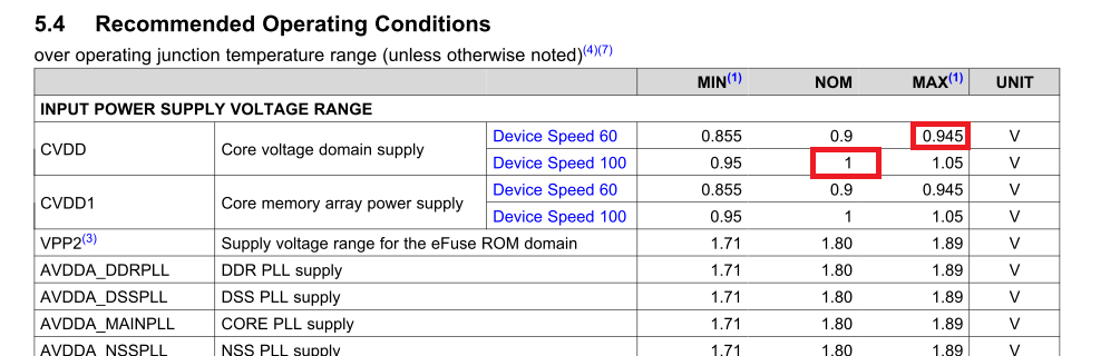

It seems like the reference design (EVM) is using TPS65911A for 66AK2G12 device, but my understanding is
  • 66AK2G12-1GHz => Recommended PMIC part should be TPS65911A
  • 66AK2G12-600MHz => Recommended PMIC part should be TPS659118
because CVDD is difference between these devices (CVDD of 66AK2G12-1GHz is 1.0V, on the other hand, 0.9V for 66AK2G12-600MHz). If TPS65911A is used for 66AK2G12-600MHz as a PMIC, I`m wondering if the default EEPROM of PMIC has to be modified to meet 66AK2G12-1GHz spec before mounting the part on PCB. Correct ?

  • Hi Yordan,
    I`m not sure why you could say so -- Data state states providing CVDD 1.0V with TPS65911A violates CVDD max spec on 66AK1G12-600Mhz.
    Can you clarify ?

  • Hi Yordan,
    The document you have shared states:
    www.ti.com/.../sprac54a.pdf
    2.2.1 PMIC
    • Review the TPS659118 User’s Guide for 66AK2Gx Processor (SWCU176). Also check the product
    data sheet for specific part numbers to be used for the 66AK2Gx operating at 600 MHz.. The following
    part numbers are recommended:
    TPS659118
    • Review the TPS65911A User’s Guide for 66AK2G12 Processor (SWCU187). Also check the product
    data sheet for specific part numbers to be used for the 66AK2Gx operating at 1 GHz. The following
    part number is recommended:
    TPS65911A (implemented on the 66AK2Gx GP EVM)
    This answers to my question.
    In summary, my understanding was correct and the recommended PMIC part on 66AK2G12 is :
    - 66AK2G12-1GHz => TPS65911A
    - 66AK2G12-600MHz => TPS659118
    NK
  • Hi NK,
    You are correct. The TPS65911A is programmed to provide the 1.0V needed the CVDD rail of the 1GHz version of the part. The TPS659118 is programmed to provide the 0.9V needed the CVDD rail of the 600MHz version of the part. The TPX65911A is programmed at the factory and cannot be reprogrammed in the field. The TPX65911A does allow you to change the voltage of CVDD using the I2C interface but the correct initial voltage is needed to ensure that the K2G boots correctly after initial power up.
    Regards, Bill
