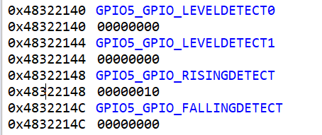

    i've now tried GPIO5_4 (ball P25, pinmux register spi4_sclk, connector J16_6) because it is accessible and not sharing the signal with anything else on the board.
    It behaves just like GPIO0_12.
    Michael
  • Michael,
    Thanks for letting me know that you tested GPIO5_4 which showed the same issue. This make my work easier.  Below I summarize my test:
    1. I used your attached CCS example and code, this is for AM437x GP EVM, I run it directly on AM437x IDK EVM, this may use a different PINMUX setting , here we only care about the PINMUX for GPIO part.
    2.1 I changed the to GPIO5_4
    #define GPIO_USER0_LED_PIN_NUM    (0x04)
    #define GPIO_USER0_LED_PORT_NUM   (0x05)
    2.2 Added a PINMUX for CTRL_CONF_SPI4_SCLK
       *(unsigned int*) 0x44E10A50 = 0x00060007; //  =====> this is pull-up, receive mode,
    2.3 In the ISR I added a counter
    Attached two files you can we what I changed.
    3. My goal is to prove that RISING EDGE can trigger ISR so the counter increase.
    4. To do that, I put a wire into J16_6 (GPIO5_4) and another wire into J16_60 (this is ground). When I shorten two wires, this is a failing edge as it grounded. When I disconnect two wires, J16_6 goes high, this is a rising edge.
    5. I was able to get multiple ISR triggered (gpio_intr_triggered increase) when I connect/disconnect two wires. I confirmed I only have rising edge interrupt:

    Can you confirm my finding?
    Regards, Eric
  • Eric,
    i can confirm your results. Your test behaves different because you are getting glitches from mechanically connecting 2 wires together.
    Using a signal generator or another GPIO to generate a clean edge will give the results i've described earlier.
    Michael
  • Eric,
    i've got it sorted out. It seems like my signal source is errornous. Looking at it with the logic analyzer does not show that there is an issue but after looking at it with a scope i found that it is not pulling the signal all the way to ground. I did not see that in the beginning because i just had a look at the high voltage level and not the low voltage level. The signal was perfectly square but also offset from ground. This was still sufficient for the falling edge trigger but would not trigger the rising edge as the comperators window for it is shiftet.
    Thank you for helping me out with this.
    Michael
