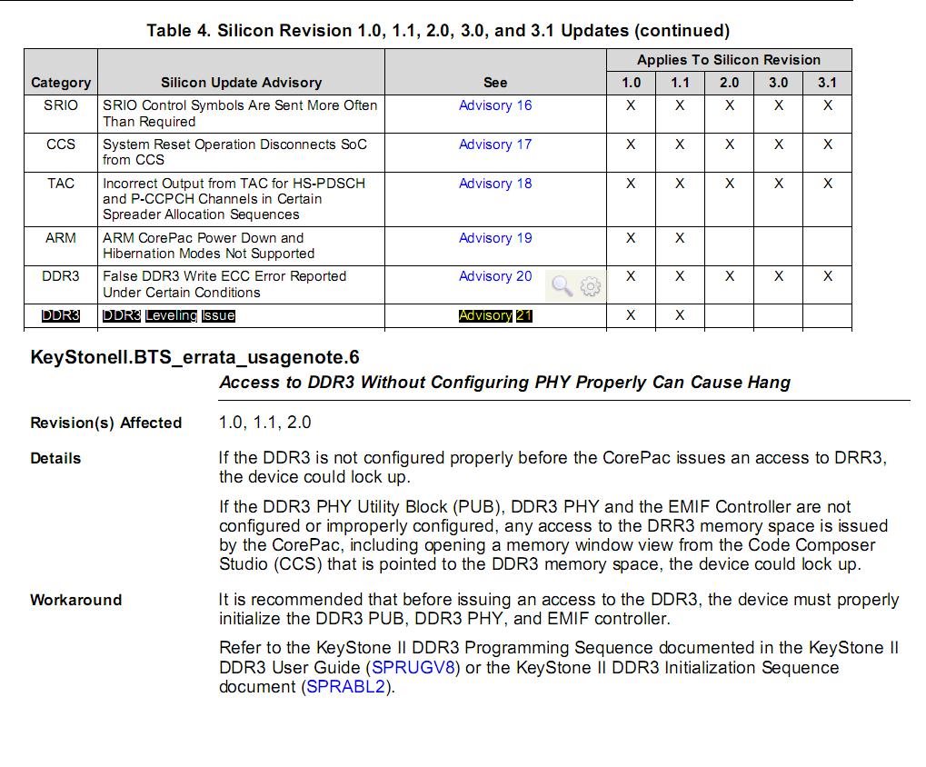

   it ‘s about DDR3B in TCI6636(K2H)CPU: 66AK2Hx SR2.0, I using DDR3A interface IS43TR16512A-125KBLI  and DDR3B with  MT41K256M16TW-107,all 64 bit no ECC。now,address 0x80000000 can reading through DDR3A,but cann't reading DDR3B at 0x6000000,if I config DDR3B phy and EMIF by  gel file,will be hang in CCS6 IDE,DDR3A is ok 。Hardware (DDR3A_REMAP_EN=1 )Accroding to TI datasheet (SPRS835F)  I checked clock is 666MHz,is good。CS  signal is normal   and voltage  is 1.5V。
Refering datasheet (sprabx7)about DDR3 Initialization sequence ,as leveling error。Attach is leveling log and DDR3B gel  config files。I config DDR3B using TI6636 K2H KeystoneII adbout DDR3.xlsx ERROR is   “RDERR has ERROE”。DDR3B_PGSR0 = 0xB1C001FF.  DDR3A_PGSR0 = 0xB00001FF , Compare wiht log between DDR3A and DDR3B.
In  errata,I find Advisory21 and  usagenote.6 ,more likely this issue, imporperly config PUB,Phy,EMIF. So I show config  as follow:
Config DDR3B function  in gel File ,I promise register,or base address and offset are  OK.

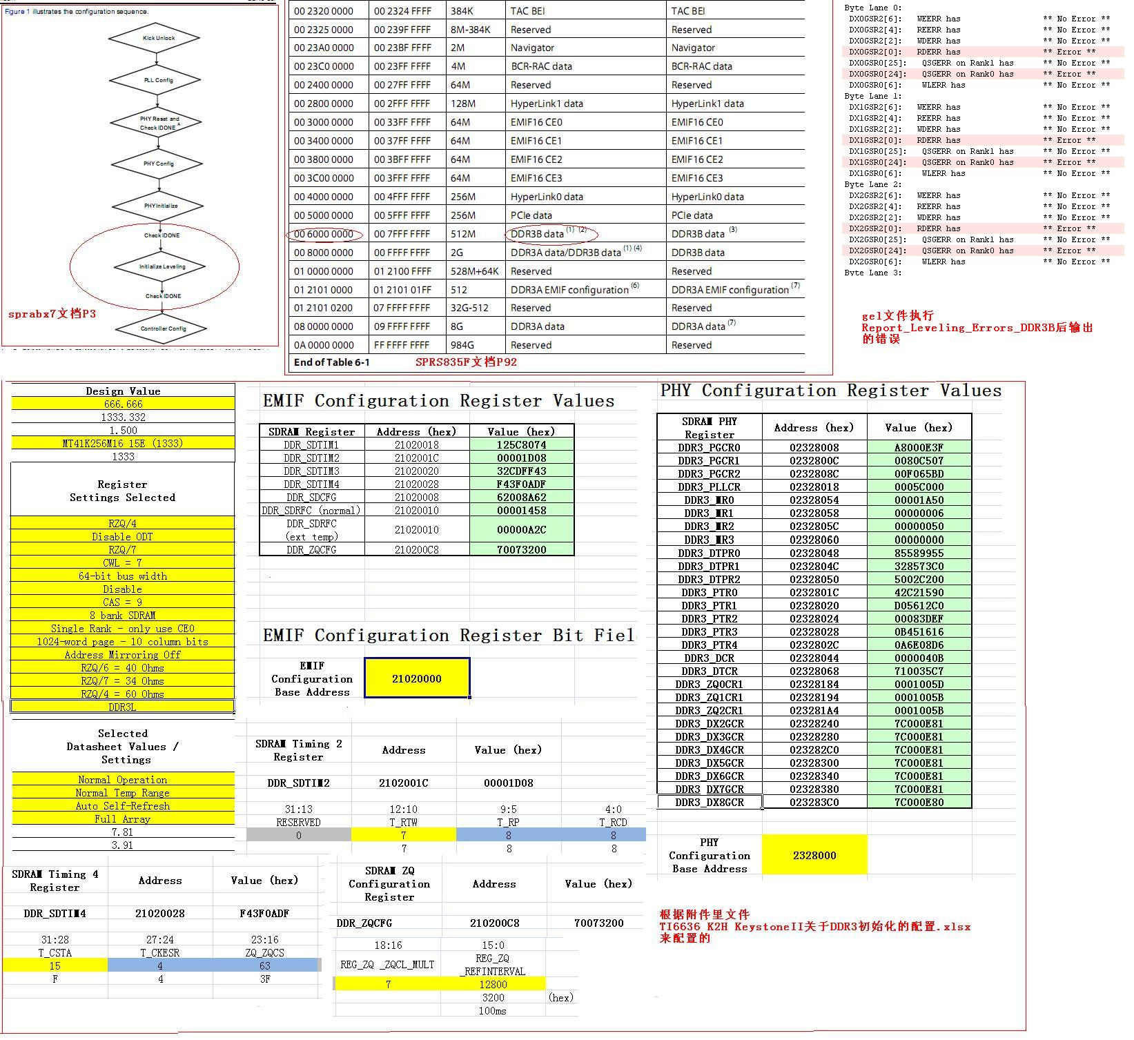

arm_A15_0: GEL Output: DDR3B PLL Setup ...
arm_A15_0: GEL Output: Lammar DDR3 PLL Setup complete, DDR3B clock now running at 666MHz.
arm_A15_0: GEL Output: DDR3B_DCR = 0x0000040B
arm_A15_0: GEL Output: DDR3B_DATX8_8 Front = 0xB000000F
arm_A15_0: GEL Output: DDR3B_DATX8_8 rear = 0xB000000E
arm_A15_0: GEL Output: DDR3B_PGSR0 = 0xB1C001FF
arm_A15_0: GEL Output: DDR3B_PGSR1 = 0x00000000
arm_A15_0: GEL Output: DDR3B 1333 initialization complete
arm_A15_0: GEL Output: ****************************************************************************************************************
arm_A15_0: GEL Output: ***************** DDR3B Leveling Errors *********************
arm_A15_0: GEL Output: PGSR0[27]: WEERR has ** No Error **
arm_A15_0: GEL Output: PGSR0[26]: REERR has ** No Error **
arm_A15_0: GEL Output: PGSR0[25]: WDERR has ** No Error **
arm_A15_0: GEL Output: PGSR0[24]: RDERR has ** Error **
arm_A15_0: GEL Output: PGSR0[23]: WLAERR has ** Error **
arm_A15_0: GEL Output: PGSR0[22]: QSGERR has ** Error **
arm_A15_0: GEL Output: PGSR0[21]: WLERR has ** No Error **
arm_A15_0: GEL Output: PGSR0[20]: ZCERR has ** No Error **
arm_A15_0: GEL Output: PGSR0[11]: WEDONE is ** Not Set **
arm_A15_0: GEL Output: PGSR0[10]: REDONE is ** Not Set **
arm_A15_0: GEL Output: PGSR0[9]: WDDONE is ** Not Set **
arm_A15_0: GEL Output: PGSR0[8]: RDDONE is ** Set **
arm_A15_0: GEL Output: PGSR0[7]: WLADONE is ** Set **
arm_A15_0: GEL Output: PGSR0[6]: QSGDONE is ** Set **
arm_A15_0: GEL Output: PGSR0[5]: WLDONE is ** Set **
arm_A15_0: GEL Output: PGSR0[4]: DIDONE is ** Set **
arm_A15_0: GEL Output: PGSR0[3]: ZCDONE is ** Not Set **
arm_A15_0: GEL Output: PGSR0[2]: DCDONE is ** Set **
arm_A15_0: GEL Output: PGSR0[1]: PLDONE is ** Set **
arm_A15_0: GEL Output: PGSR0[0]: IDONE is ** Set **
arm_A15_0: GEL Output: Leveling Errors by Byte Lane:
arm_A15_0: GEL Output: Byte Lane 0:
arm_A15_0: GEL Output: DX0GSR2[6]: WEERR has ** No Error **
arm_A15_0: GEL Output: DX0GSR2[4]: REERR has ** No Error **
arm_A15_0: GEL Output: DX0GSR2[2]: WDERR has ** No Error **
arm_A15_0: GEL Output: DX0GSR2[0]: RDERR has ** Error **
arm_A15_0: GEL Output: DX0GSR0[25]: QSGERR on Rank1 has ** No Error **
arm_A15_0: GEL Output: DX0GSR0[24]: QSGERR on Rank0 has ** Error **
arm_A15_0: GEL Output: DX0GSR0[6]: WLERR has ** No Error **
arm_A15_0: GEL Output: Byte Lane 1:
arm_A15_0: GEL Output: DX1GSR2[6]: WEERR has ** No Error **
arm_A15_0: GEL Output: DX1GSR2[4]: REERR has ** No Error **
arm_A15_0: GEL Output: DX1GSR2[2]: WDERR has ** No Error **
arm_A15_0: GEL Output: DX1GSR2[0]: RDERR has ** Error **
arm_A15_0: GEL Output: DX1GSR0[25]: QSGERR on Rank1 has ** No Error **
arm_A15_0: GEL Output: DX1GSR0[24]: QSGERR on Rank0 has ** Error **
arm_A15_0: GEL Output: DX1GSR0[6]: WLERR has ** No Error **
arm_A15_0: GEL Output: Byte Lane 2:
arm_A15_0: GEL Output: DX2GSR2[6]: WEERR has ** No Error **
arm_A15_0: GEL Output: DX2GSR2[4]: REERR has ** No Error **
arm_A15_0: GEL Output: DX2GSR2[2]: WDERR has ** No Error **
arm_A15_0: GEL Output: DX2GSR2[0]: RDERR has ** Error **
arm_A15_0: GEL Output: DX2GSR0[25]: QSGERR on Rank1 has ** No Error **
arm_A15_0: GEL Output: DX2GSR0[24]: QSGERR on Rank0 has ** Error **
arm_A15_0: GEL Output: DX2GSR0[6]: WLERR has ** No Error **
arm_A15_0: GEL Output: Byte Lane 3:
arm_A15_0: GEL Output: DX3GSR2[6]: WEERR has ** No Error **
arm_A15_0: GEL Output: DX3GSR2[4]: REERR has ** No Error **
arm_A15_0: GEL Output: DX3GSR2[2]: WDERR has ** No Error **
arm_A15_0: GEL Output: DX3GSR2[0]: RDERR has ** Error **
arm_A15_0: GEL Output: DX3GSR0[25]: QSGERR on Rank1 has ** No Error **
arm_A15_0: GEL Output: DX3GSR0[24]: QSGERR on Rank0 has ** Error **
arm_A15_0: GEL Output: DX3GSR0[6]: WLERR has ** No Error **
arm_A15_0: GEL Output: Byte Lane 4:
arm_A15_0: GEL Output: DX4GSR2[6]: WEERR has ** No Error **
arm_A15_0: GEL Output: DX4GSR2[4]: REERR has ** No Error **
arm_A15_0: GEL Output: DX4GSR2[2]: WDERR has ** No Error **
arm_A15_0: GEL Output: DX4GSR2[0]: RDERR has ** Error **
arm_A15_0: GEL Output: DX4GSR0[25]: QSGERR on Rank1 has ** No Error **
arm_A15_0: GEL Output: DX4GSR0[24]: QSGERR on Rank0 has ** Error **
arm_A15_0: GEL Output: DX4GSR0[6]: WLERR has ** No Error **
arm_A15_0: GEL Output: Byte Lane 5:
arm_A15_0: GEL Output: DX5GSR2[6]: WEERR has ** No Error **
arm_A15_0: GEL Output: DX5GSR2[4]: REERR has ** No Error **
arm_A15_0: GEL Output: DX5GSR2[2]: WDERR has ** No Error **
arm_A15_0: GEL Output: DX5GSR2[0]: RDERR has ** Error **
arm_A15_0: GEL Output: DX5GSR0[25]: QSGERR on Rank1 has ** No Error **
arm_A15_0: GEL Output: DX5GSR0[24]: QSGERR on Rank0 has ** Error **
arm_A15_0: GEL Output: DX5GSR0[6]: WLERR has ** No Error **
arm_A15_0: GEL Output: Byte Lane 6:
arm_A15_0: GEL Output: DX6GSR2[6]: WEERR has ** No Error **
arm_A15_0: GEL Output: DX6GSR2[4]: REERR has ** No Error **
arm_A15_0: GEL Output: DX6GSR2[2]: WDERR has ** No Error **
arm_A15_0: GEL Output: DX6GSR2[0]: RDERR has ** Error **
arm_A15_0: GEL Output: DX6GSR0[25]: QSGERR on Rank1 has ** No Error **
arm_A15_0: GEL Output: DX6GSR0[24]: QSGERR on Rank0 has ** Error **
arm_A15_0: GEL Output: DX6GSR0[6]: WLERR has ** No Error **
arm_A15_0: GEL Output: Byte Lane 7:
arm_A15_0: GEL Output: DX7GSR2[6]: WEERR has ** No Error **
arm_A15_0: GEL Output: DX7GSR2[4]: REERR has ** No Error **
arm_A15_0: GEL Output: DX7GSR2[2]: WDERR has ** No Error **
arm_A15_0: GEL Output: DX7GSR2[0]: RDERR has ** Error **
arm_A15_0: GEL Output: DX7GSR0[25]: QSGERR on Rank1 has ** No Error **
arm_A15_0: GEL Output: DX7GSR0[24]: QSGERR on Rank0 has ** Error **
arm_A15_0: GEL Output: DX7GSR0[6]: WLERR has ** No Error **
arm_A15_0: GEL Output: Byte Lane 8:
arm_A15_0: GEL Output: DX8GSR2[6]: WEERR has ** No Error **
arm_A15_0: GEL Output: DX8GSR2[4]: REERR has ** No Error **
arm_A15_0: GEL Output: DX8GSR2[2]: WDERR has ** No Error **
arm_A15_0: GEL Output: DX8GSR2[0]: RDERR has ** No Error **
arm_A15_0: GEL Output: DX8GSR0[25]: QSGERR on Rank1 has ** No Error **
arm_A15_0: GEL Output: DX8GSR0[24]: QSGERR on Rank0 has ** No Error **
arm_A15_0: GEL Output: DX8GSR0[6]: WLERR has ** No Error **

arm_A15_0: GEL Output: DDR3 PLL Setup ...
arm_A15_0: GEL Output: Lammar DDR3 PLL Setup complete, DDR3A clock now running at 666MHz.
arm_A15_0: GEL Output: DDR3A_DATX8_8 Front = 0xB000000F
arm_A15_0: GEL Output: DDR3A_DATX8_8 rear = 0x7C000E80
arm_A15_0: GEL Output: DDR3A_PGSR0 = 0xB0000FFF
arm_A15_0: GEL Output: DDR3A_PGSR1 = 0x00000000
arm_A15_0: GEL Output: DDR3A initialization complete
arm_A15_0: GEL Output: DDR PLL Registers:
arm_A15_0: GEL Output:  DDR3A_PLL_CTL0 register:  0x092804C0 (0x02620360)
arm_A15_0: GEL Output:  	PLLD[5:0]:		0 (Pre-Divide value of 1)
arm_A15_0: GEL Output:  	PLLM[18:6]:		19 (Multiplier value of 20)
arm_A15_0: GEL Output:  	CLKOD[22:19]:		5 (Output Divide value of 6)
arm_A15_0: GEL Output:  	BYPASS[23]:		0
arm_A15_0: GEL Output:  	BWADJ-lower[31:24]: 	9
arm_A15_0: GEL Output:  DDR3A_PLL_CTL1 register:  0x00000040
arm_A15_0: GEL Output:  	PLLRESET[14]: Reset ** DEASSERTED ** to PLL
arm_A15_0: GEL Output:  	ENSAT[6]: ENSAT is SET - (GOOD)
arm_A15_0: GEL Output:  	BWADJ-upper[3:0]:	0
arm_A15_0: GEL Output:  	BWADJ[11:0] (combined):	9
arm_A15_0: GEL Output: DDR SDRAM Configuration Register (SDCFG)
arm_A15_0: GEL Output: DDR3AEMIF_SDCFG:			0x62008C6A (Address: 0x21010008)
arm_A15_0: GEL Output: 	SDRAM Type[31:29]:   		DDR3 (3)
arm_A15_0: GEL Output: 	SDRAM Drive[27:25]:  		RZQ/4 (1)
arm_A15_0: GEL Output: 	Dynamic ODT[23:22]:  		OFF (0)
arm_A15_0: GEL Output: 	CAS Write Latency[16:14]:	7 (2)
arm_A15_0: GEL Output: 	Data Bus Width[13:12]: 		64-bit (0)
arm_A15_0: GEL Output: 	CAS Latency[11:8]:		10 (12)
arm_A15_0: GEL Output: 	Banks per SDRAM[6:5]: 		8 (3)
arm_A15_0: GEL Output: 	Chip Select Setup[3]: 		DCE0# + DCE1# (1)
arm_A15_0: GEL Output: 	Page Size[1:0]:    		1024 word page (2)
arm_A15_0: GEL Output: SDRAM Refresh Control Register (SDRFC)
arm_A15_0: GEL Output: DDR3AEMIF_SDRFC:			0x00000A2C (Address: 0x21010010)
arm_A15_0: GEL Output: 	INITREF_DIS[31]:		Normal operation
arm_A15_0: GEL Output: 	REFRESH_RATE[15:0]:		2604 (REFRESH_RATE = Refresh period * DDR3 clock frequency.)
arm_A15_0: GEL Output: SDRAM Timing 1 Register (SDTIM1)
arm_A15_0: GEL Output: DDR3AEMIF_SDTIM1:			0x125C8074 (Address: 0x21010018)
arm_A15_0: GEL Output: 	T_WR[29:25]:			9 cycles (+1)
arm_A15_0: GEL Output: 	T_RAS[24:18]:			23 cycles (+1)
arm_A15_0: GEL Output: 	T_RC[17:10]:			32 cycles (+1)
arm_A15_0: GEL Output: 	T_RRD[9:4]:			7 cycles (+1)
arm_A15_0: GEL Output: 	T_WTR[3:0]:			4 cycles (+1)
arm_A15_0: GEL Output: SDRAM Timing 2 Register (SDTIM2)
arm_A15_0: GEL Output: DDR3AEMIF_SDTIM2:			0x00001D08 (Address: 0x2101001C)
arm_A15_0: GEL Output: 	T_RTW[12:10]:			7 cycles (+1)
arm_A15_0: GEL Output: 	T_RP[9:5]:			8 cycles (+1)
arm_A15_0: GEL Output: 	T_RCD[4:0]:			8 cycles (+1)
arm_A15_0: GEL Output: SDRAM Timing 3 Register (SDTIM3)
arm_A15_0: GEL Output: DDR3AEMIF_SDTIM3:			0x32CDFF43 (Address: 0x21010020)
arm_A15_0: GEL Output: 	T_XP[31:28]:			3 cycles (+1)
arm_A15_0: GEL Output: 	T_XSNR[27:18]:			179 cycles (+1)
arm_A15_0: GEL Output: 	T_XSRD[17:8]:			511 cycles (+1)
arm_A15_0: GEL Output: 	T_RTP[7:4]:			4 cycles (+1)
arm_A15_0: GEL Output: 	T_CKE[3:0]:			3 cycles (+1)
arm_A15_0: GEL Output: SDRAM Timing 4 Register (SDTIM4)
arm_A15_0: GEL Output: 	DDR3AEMIF_SDTIM4:		0x543F0ADF (Address: 0x21010028)
arm_A15_0: GEL Output: 	T_CSTA[31:28]:			3 cycles (+1)
arm_A15_0: GEL Output: 	T_CKESR[27:24]:			2 cycles (+1)
arm_A15_0: GEL Output: 	ZQ_ZQCS[23:16]:			205 cycles (+1)
arm_A15_0: GEL Output: 	T_RFC[13:4]:			1012 cycles (+1)
arm_A15_0: GEL Output: 	T_RAS_MAX[3:0]:(should be 0xF)	3 cycles
arm_A15_0: GEL Output: SDRAM Output Impedance Calibration Configuration Register (ZQCFG)
arm_A15_0: GEL Output: 	DDR3AEMIF_ZQCFG:		0xF0073200 (Address: 0x210100C8)
arm_A15_0: GEL Output: 	ZQ_CS1EN[31]:			ZQ calibration for Rank 2 is Enabled (1)
arm_A15_0: GEL Output: 	ZQ_CS0EN[31]:			ZQ calibration for Rank 1 is Enabled (1)
arm_A15_0: GEL Output: 	ZQ_DUALCALEN[29]:		Dual ZQ calibration is Enabled (1)
arm_A15_0: GEL Output: 	ZQ_SFEXITEN[28]:		ZQ calibration on self-refresh, Active power-down and precharge power-down exit is Enabled (1)
arm_A15_0: GEL Output: 	ZQ_ZQCL_MULT[18:16]:		7 cycles
arm_A15_0: GEL Output: 	ZQ_REFINTERVAL[15:0]:		Refresh periods between ZQCS commands is 12800 (+1)
arm_A15_0: GEL Output: PLL Control Register (PLLCR)
arm_A15_0: GEL Output: DDR3A_PLLCR:			0x000DC000 (Address: 0x02329018)
arm_A15_0: GEL Output: 	FRQSEL[19:18]:			PLL Reference clock ranges from 166MHz to 275MHz (3)
arm_A15_0: GEL Output: Note: PLL Reference Clock should be 1/4 of DDR data rate. (i.e. 400MHz -> 1600MTs)
arm_A15_0: GEL Output: DRAM Timing Parameters Register 0 (DTPR0)
arm_A15_0: GEL Output: DDR3A_DTPR0:			0x8558AA75 (Address: 0x02329048)
arm_A15_0: GEL Output: 	tRFC[31:26]:			Activate to Activate command delay (same bank) is 33 cycles
arm_A15_0: GEL Output: 	tRRD[25:22]:			Activate to Activate command delay (diff banks) is 5 cycles
arm_A15_0: GEL Output: 	tRAS[21:16]:			Activate to Precharge command delay is 24 cycles
arm_A15_0: GEL Output: 	tRCD[15:12]:			Activate to Read/Write (on activated row) command delay is 10 cycles
arm_A15_0: GEL Output: 	tRP[11:8]:			Precharge command period is 10 cycles
arm_A15_0: GEL Output: 	tWTR[7:4]:			Internal write to read command delay is 7 cycles
arm_A15_0: GEL Output: 	tRTP[3:0]:			Internal read to precharge command delay is 5 cycles
arm_A15_0: GEL Output: DRAM Timing Parameters Register 1 (DTPR1)
arm_A15_0: GEL Output: DDR3A_DTPR1:			0x32857360 (Address: 0x0232904C)
arm_A15_0: GEL Output: 	tWLO[29:26]:			Write leveling output delay is 12 cycles
arm_A15_0: GEL Output: 	tWLMRD[25:20]:			Min delay from write leveling mode to first DQS edge is 40 cycles
arm_A15_0: GEL Output: 	tRFC[19:11]:			Refresh to Refresh command delay is 174 cycles
arm_A15_0: GEL Output: 	tFAW[10:5]:			4-bank activate period is 27 cycles
arm_A15_0: GEL Output: 	tMOD[4:2]:			Load mode update delay is 12 cycles (0)
arm_A15_0: GEL Output: 	tMRD[1:0]:			Load mode cycle time is 0 cycles
arm_A15_0: GEL Output: DRAM Timing Parameters Register 2 (DTPR2)
arm_A15_0: GEL Output: DDR3A_DTPR2:			0x5002C200 (Address: 0x02329050)
arm_A15_0: GEL Output: 	tCCD[31]:			Read to read and write to write command delay is 4 cycles (0)
arm_A15_0: GEL Output: 	tRTW[30]:			Read to write command delay is standard bus turn around delay +1 clock (1)
arm_A15_0: GEL Output: 	tRTODT[29]:			Read to ODT delay is 0, may come immediately after read post-amble (0)
arm_A15_0: GEL Output: 	tDLLK[28:19]:			DLL locking time is 512 cycles
arm_A15_0: GEL Output: 	tCKE[28:19]:			CKE minimum pulse width (tCKESR) is 5 cycles
arm_A15_0: GEL Output: 	tXP[14:10]:			Power down exit delay is 16 cycles
arm_A15_0: GEL Output: 	tXS[9:0]:			Self refresh exit delay is 512 cycles
arm_A15_0: GEL Output: Mode Register 0 (MR0)
arm_A15_0: GEL Output: DDR3A_MR0:				0x00001A60 (Address: 0x02329054)
arm_A15_0: GEL Output: 	PD[12]:				Fast power down exit (DLL on) (1)
arm_A15_0: GEL Output: 	WR[11:9]:			Write Recovery is 10 cycles (5)
arm_A15_0: GEL Output: 	CL[6:4,2]:			10 cycles (12)
arm_A15_0: GEL Output: Mode Register 1 (MR1)
arm_A15_0: GEL Output: DDR3A_MR1:				0x00000006 (Address: 0x02329058)
arm_A15_0: GEL Output: 	AL[4:3]:			AL Disabled (0)
arm_A15_0: GEL Output: 	RTT[9,6,2]:			ODT is RZQ/4 on SDRAM (1)

arm_A15_0: GEL Output:  		[15:8] (Rank 1 WL Delay): 		0
arm_A15_0: GEL Output:  DX3GTR:			0x00005006
arm_A15_0: GEL Output:  		[13:12] (Rank 0 WL Cycle Latency): 	1
arm_A15_0: GEL Output:  		[15:14] (Rank 1 WL Cycle Latency): 	1
arm_A15_0: GEL Output:  DX3LCDLR0:		0x0000001A
arm_A15_0: GEL Output:  		[7:0] (Rank 0 WL Delay): 		26
arm_A15_0: GEL Output:  DX4GTR:			0x00007006
arm_A15_0: GEL Output:  		[13:12] (Rank 0 WL Cycle Latency): 	3
arm_A15_0: GEL Output:  DX4LCDLR0:		0x00000031
arm_A15_0: GEL Output:  		[7:0] (Rank 0 WL Delay): 		49
arm_A15_0: GEL Output:  DX5GTR:			0x00007006
arm_A15_0: GEL Output:  DX5LCDLR0:		0x0000002E
arm_A15_0: GEL Output:  		[7:0] (Rank 0 WL Delay): 		46
arm_A15_0: GEL Output:  DX6GTR:			0x00007006
arm_A15_0: GEL Output:  DX6LCDLR0:		0x00000033
arm_A15_0: GEL Output:  		[7:0] (Rank 0 WL Delay): 		51
arm_A15_0: GEL Output:  DX7GTR:			0x00007006
arm_A15_0: GEL Output:  DX7LCDLR0:		0x00000031
arm_A15_0: GEL Output:  DX8GTR:			0x00005000
arm_A15_0: GEL Output:  DX8LCDLR0:		0x00000000
arm_A15_0: GEL Output:  		[7:0] (Rank 0 WL Delay): 		0
arm_A15_0: GEL Output: Equivalent 90 degree phase shift in delay units, derived from measured period:
arm_A15_0: GEL Output:  DX0LCDLR1:		0x00232322
arm_A15_0: GEL Output:  		[7:0] (Write Delay Shift): 		34
arm_A15_0: GEL Output:  		[15:8] (Read DQS Delay):		35
arm_A15_0: GEL Output:  		[23:16] (Read DQSN Delay): 		35
arm_A15_0: GEL Output:  DX1LCDLR1:		0x00222222
arm_A15_0: GEL Output:  		[15:8] (Read DQS Delay): 		34
arm_A15_0: GEL Output:  		[23:16] (Read DQSN Delay): 		34
arm_A15_0: GEL Output:  DX2LCDLR1:		0x00232222
arm_A15_0: GEL Output:  DX3LCDLR1:		0x00212121
arm_A15_0: GEL Output:  		[7:0] (Write Delay Shift): 		33
arm_A15_0: GEL Output:  		[15:8] (Read DQS Delay): 		33
arm_A15_0: GEL Output:  		[23:16] (Read DQSN Delay): 		33
arm_A15_0: GEL Output:  DX4LCDLR1:		0x00222222
arm_A15_0: GEL Output:  DX5LCDLR1:		0x00222222
arm_A15_0: GEL Output:  DX6LCDLR1:		0x00232222
arm_A15_0: GEL Output:  DX7LCDLR1:		0x00232222
arm_A15_0: GEL Output:  DX8LCDLR1:		0x00222222
arm_A15_0: GEL Output: Delay Values from Read DQS Gating Leveling Registers:
arm_A15_0: GEL Output:  DX0GTR:			0x00007006
arm_A15_0: GEL Output:  		[2:0] (Rank 0 DQS Gating Latency): 	6
arm_A15_0: GEL Output:  		[5:3] (Rank 1 DQS Gating Latency): 	0
arm_A15_0: GEL Output:  DX0LCDLR2:		0x0000006B
arm_A15_0: GEL Output:  		[7:0] (Rank 0 RL Delay): 		107
arm_A15_0: GEL Output:  		[15:8] (Rank 1 RL Delay): 		0
arm_A15_0: GEL Output:  DX1GTR:			0x00007006
arm_A15_0: GEL Output:  DX1LCDLR2:		0x0000006B
arm_A15_0: GEL Output:  DX2GTR:			0x00007006
arm_A15_0: GEL Output:  DX2LCDLR2:		0x0000006B
arm_A15_0: GEL Output:  DX3LCDLR2:		0x00000088
arm_A15_0: GEL Output:  		[7:0] (Rank 0 RL Delay): 		136
arm_A15_0: GEL Output:  DX4LCDLR2:		0x0000006B
arm_A15_0: GEL Output:  DX5LCDLR2:		0x0000006B
arm_A15_0: GEL Output:  DX6LCDLR2:		0x0000006B
arm_A15_0: GEL Output:  DX7LCDLR2:		0x0000006B
arm_A15_0: GEL Output:  		[2:0] (Rank 0 DQS Gating Latency): 	0
arm_A15_0: GEL Output:  DX8LCDLR2:		0x00000000
arm_A15_0: GEL Output:  		[7:0] (Rank 0 RL Delay): 		0
Keystone II DDR3 Initialization(sprabx7).pdf
Silicon Errata(sprz399d).pdf
