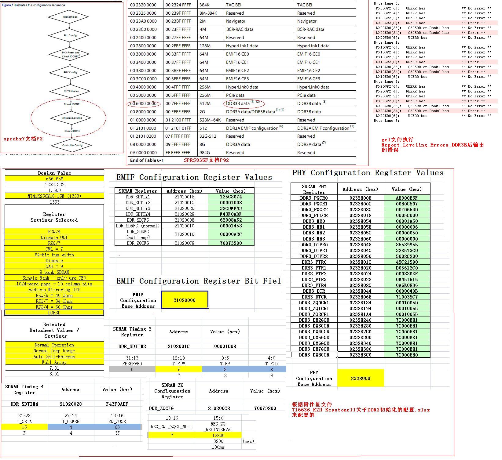

hi TI experts:
    I meet a little issue,I hope you can help me or give me some advise。
   it ‘s about DDR3B in TCI6636(K2H)CPU: 66AK2Hx SR2.0, I using DDR3A interface IS43TR16512A-125KBLI  and DDR3B with  MT41K256M16TW-107,all 64 bit no ECC。now,address 0x80000000 can reading through DDR3A,but cann't reading DDR3B at 0x6000000,if I config DDR3B phy and EMIF by  gel file,will be hang in CCS6 IDE,DDR3A is ok 。Hardware (DDR3A_REMAP_EN=1 )Accroding to TI datasheet (SPRS835F)  I checked clock is 666MHz,is good。CS  signal is normal   and voltage  is 1.5V。
Refering datasheet (sprabx7)about DDR3 Initialization sequence ,as leveling error。Attach is leveling log and DDR3B gel  config files。I config DDR3B using TI6636 K2H KeystoneII adbout DDR3.xlsx ERROR is   “RDERR has ERROE”。DDR3B_PGSR0 = 0xB1C001FF.  DDR3A_PGSR0 = 0xB00001FF , Compare wiht log between DDR3A and DDR3B.
In  errata,I find Advisory21 and  usagenote.6 ,more likely this issue, imporperly config PUB,Phy,EMIF. So I show config  as follow:
Config DDR3B function  in gel File ,I promise register,or base address and offset are  OK.

arm_A15_0: GEL Output: DDR3B PLL Setup ...
arm_A15_0: GEL Output: Lammar DDR3 PLL Setup complete, DDR3B clock now running at 666MHz.
arm_A15_0: GEL Output: DDR3B_DCR = 0x0000040B
arm_A15_0: GEL Output: DDR3B_DATX8_8 Front = 0xB000000F
arm_A15_0: GEL Output: DDR3B_DATX8_8 rear = 0xB000000E
arm_A15_0: GEL Output: DDR3B_PGSR0 = 0xB1C001FF
arm_A15_0: GEL Output: DDR3B_PGSR1 = 0x00000000
arm_A15_0: GEL Output: DDR3B 1333 initialization complete
arm_A15_0: GEL Output: ****************************************************************************************************************
arm_A15_0: GEL Output: ***************** DDR3B Leveling Errors *********************
arm_A15_0: GEL Output: PGSR0[27]: WEERR has ** No Error **
arm_A15_0: GEL Output: PGSR0[26]: REERR has ** No Error **
arm_A15_0: GEL Output: PGSR0[25]: WDERR has ** No Error **
arm_A15_0: GEL Output: PGSR0[24]: RDERR has ** Error **
arm_A15_0: GEL Output: PGSR0[23]: WLAERR has ** Error **
arm_A15_0: GEL Output: PGSR0[22]: QSGERR has ** Error **
arm_A15_0: GEL Output: PGSR0[21]: WLERR has ** No Error **
arm_A15_0: GEL Output: PGSR0[20]: ZCERR has ** No Error **
arm_A15_0: GEL Output: PGSR0[11]: WEDONE is ** Not Set **
arm_A15_0: GEL Output: PGSR0[10]: REDONE is ** Not Set **
arm_A15_0: GEL Output: PGSR0[9]: WDDONE is ** Not Set **
arm_A15_0: GEL Output: PGSR0[8]: RDDONE is ** Set **
arm_A15_0: GEL Output: PGSR0[7]: WLADONE is ** Set **
arm_A15_0: GEL Output: PGSR0[6]: QSGDONE is ** Set **
arm_A15_0: GEL Output: PGSR0[5]: WLDONE is ** Set **
arm_A15_0: GEL Output: PGSR0[4]: DIDONE is ** Set **
arm_A15_0: GEL Output: PGSR0[3]: ZCDONE is ** Not Set **
arm_A15_0: GEL Output: PGSR0[2]: DCDONE is ** Set **
arm_A15_0: GEL Output: PGSR0[1]: PLDONE is ** Set **
arm_A15_0: GEL Output: PGSR0[0]: IDONE is ** Set **
arm_A15_0: GEL Output: Leveling Errors by Byte Lane:
arm_A15_0: GEL Output: Byte Lane 0:
arm_A15_0: GEL Output: DX0GSR2[6]: WEERR has ** No Error **
arm_A15_0: GEL Output: DX0GSR2[4]: REERR has ** No Error **
arm_A15_0: GEL Output: DX0GSR2[2]: WDERR has ** No Error **
arm_A15_0: GEL Output: DX0GSR2[0]: RDERR has ** Error **
arm_A15_0: GEL Output: DX0GSR0[25]: QSGERR on Rank1 has ** No Error **
arm_A15_0: GEL Output: DX0GSR0[24]: QSGERR on Rank0 has ** Error **
arm_A15_0: GEL Output: DX0GSR0[6]: WLERR has ** No Error **
arm_A15_0: GEL Output: Byte Lane 1:
arm_A15_0: GEL Output: DX1GSR2[6]: WEERR has ** No Error **
arm_A15_0: GEL Output: DX1GSR2[4]: REERR has ** No Error **
arm_A15_0: GEL Output: DX1GSR2[2]: WDERR has ** No Error **
arm_A15_0: GEL Output: DX1GSR2[0]: RDERR has ** Error **
arm_A15_0: GEL Output: DX1GSR0[25]: QSGERR on Rank1 has ** No Error **
arm_A15_0: GEL Output: DX1GSR0[24]: QSGERR on Rank0 has ** Error **
arm_A15_0: GEL Output: DX1GSR0[6]: WLERR has ** No Error **
arm_A15_0: GEL Output: Byte Lane 2:
arm_A15_0: GEL Output: DX2GSR2[6]: WEERR has ** No Error **
arm_A15_0: GEL Output: DX2GSR2[4]: REERR has ** No Error **
arm_A15_0: GEL Output: DX2GSR2[2]: WDERR has ** No Error **
arm_A15_0: GEL Output: DX2GSR2[0]: RDERR has ** Error **
arm_A15_0: GEL Output: DX2GSR0[25]: QSGERR on Rank1 has ** No Error **
arm_A15_0: GEL Output: DX2GSR0[24]: QSGERR on Rank0 has ** Error **
arm_A15_0: GEL Output: DX2GSR0[6]: WLERR has ** No Error **
arm_A15_0: GEL Output: Byte Lane 3:
arm_A15_0: GEL Output: DX3GSR2[6]: WEERR has ** No Error **
arm_A15_0: GEL Output: DX3GSR2[4]: REERR has ** No Error **
arm_A15_0: GEL Output: DX3GSR2[2]: WDERR has ** No Error **
arm_A15_0: GEL Output: DX3GSR2[0]: RDERR has ** Error **
arm_A15_0: GEL Output: DX3GSR0[25]: QSGERR on Rank1 has ** No Error **
arm_A15_0: GEL Output: DX3GSR0[24]: QSGERR on Rank0 has ** Error **
arm_A15_0: GEL Output: DX3GSR0[6]: WLERR has ** No Error **
arm_A15_0: GEL Output: Byte Lane 4:
arm_A15_0: GEL Output: DX4GSR2[6]: WEERR has ** No Error **
arm_A15_0: GEL Output: DX4GSR2[4]: REERR has ** No Error **
arm_A15_0: GEL Output: DX4GSR2[2]: WDERR has ** No Error **
arm_A15_0: GEL Output: DX4GSR2[0]: RDERR has ** Error **
arm_A15_0: GEL Output: DX4GSR0[25]: QSGERR on Rank1 has ** No Error **
arm_A15_0: GEL Output: DX4GSR0[24]: QSGERR on Rank0 has ** Error **
arm_A15_0: GEL Output: DX4GSR0[6]: WLERR has ** No Error **
arm_A15_0: GEL Output: Byte Lane 5:
arm_A15_0: GEL Output: DX5GSR2[6]: WEERR has ** No Error **
arm_A15_0: GEL Output: DX5GSR2[4]: REERR has ** No Error **
arm_A15_0: GEL Output: DX5GSR2[2]: WDERR has ** No Error **
arm_A15_0: GEL Output: DX5GSR2[0]: RDERR has ** Error **
arm_A15_0: GEL Output: DX5GSR0[25]: QSGERR on Rank1 has ** No Error **
arm_A15_0: GEL Output: DX5GSR0[24]: QSGERR on Rank0 has ** Error **
arm_A15_0: GEL Output: DX5GSR0[6]: WLERR has ** No Error **
arm_A15_0: GEL Output: Byte Lane 6:
arm_A15_0: GEL Output: DX6GSR2[6]: WEERR has ** No Error **
arm_A15_0: GEL Output: DX6GSR2[4]: REERR has ** No Error **
arm_A15_0: GEL Output: DX6GSR2[2]: WDERR has ** No Error **
arm_A15_0: GEL Output: DX6GSR2[0]: RDERR has ** Error **
arm_A15_0: GEL Output: DX6GSR0[25]: QSGERR on Rank1 has ** No Error **
arm_A15_0: GEL Output: DX6GSR0[24]: QSGERR on Rank0 has ** Error **
arm_A15_0: GEL Output: DX6GSR0[6]: WLERR has ** No Error **
arm_A15_0: GEL Output: Byte Lane 7:
arm_A15_0: GEL Output: DX7GSR2[6]: WEERR has ** No Error **
arm_A15_0: GEL Output: DX7GSR2[4]: REERR has ** No Error **
arm_A15_0: GEL Output: DX7GSR2[2]: WDERR has ** No Error **
arm_A15_0: GEL Output: DX7GSR2[0]: RDERR has ** Error **
arm_A15_0: GEL Output: DX7GSR0[25]: QSGERR on Rank1 has ** No Error **
arm_A15_0: GEL Output: DX7GSR0[24]: QSGERR on Rank0 has ** Error **
arm_A15_0: GEL Output: DX7GSR0[6]: WLERR has ** No Error **
arm_A15_0: GEL Output: Byte Lane 8:
arm_A15_0: GEL Output: DX8GSR2[6]: WEERR has ** No Error **
arm_A15_0: GEL Output: DX8GSR2[4]: REERR has ** No Error **
arm_A15_0: GEL Output: DX8GSR2[2]: WDERR has ** No Error **
arm_A15_0: GEL Output: DX8GSR2[0]: RDERR has ** No Error **
arm_A15_0: GEL Output: DX8GSR0[25]: QSGERR on Rank1 has ** No Error **
arm_A15_0: GEL Output: DX8GSR0[24]: QSGERR on Rank0 has ** No Error **
arm_A15_0: GEL Output: DX8GSR0[6]: WLERR has ** No Error **
